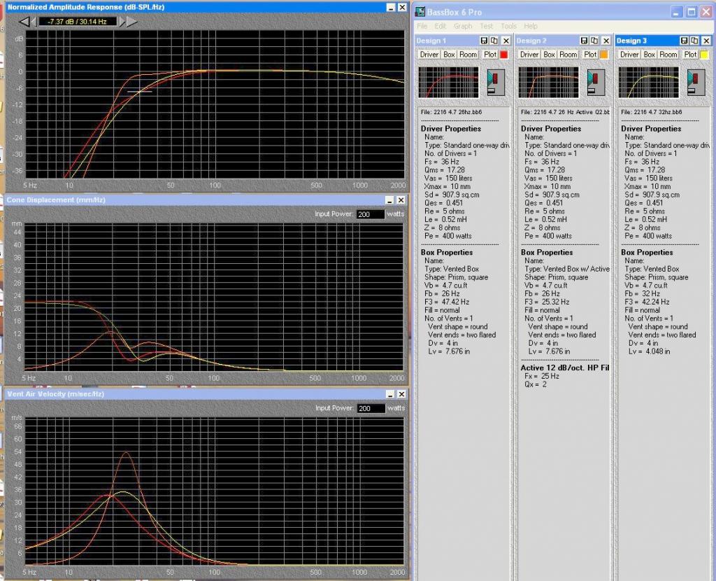

Have you ran any sims? JBL used an assisted alignment in both home for 2235's 2245's,B380,B460 subs with BX-63 and 2242's for cinema use. They would low tune to 26Hz and add a Q2 6 dB bump and use a 20Hz high pass. Worked well something to consider may or may not work with these drivers. I used it with Vertec 15's 2266's for HT subs and it worked quite well. Also did it with 2216's in my passive M2 set-up. Here take a look at the F3 numbers compared to a 32Hz box no assist.
That all the same box 26 Hz 26Hz assisted and 32 Hz. JBL also does this a little lower in the M2

@Robh3606 No sims run yet. Just basic calculations with a piece of old code I wrote 30 yrs ago for vented and sealed alignments. You tend to get a good sense of what approximately works and what doesn't. Woofers with a mid to high 0.30s Qts are always of interest for vented alignments. Most pro LF drivers have a Qts of around 0.25 - 0.30 which is optimized for smaller vented boxes.

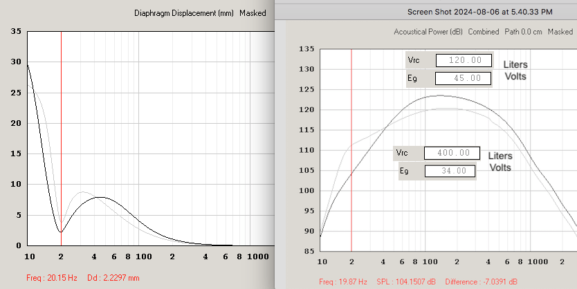

After running some 2268H sims, it's apparent it wants a box of equal or greater volumes than it's 338L VAS to provide much output at tunings below Fs.@Robh3606 No sims run yet.
The SLAPS M-12 passive radiator Fb is 20Hz in a 120L chamber, so can't take advantage of the larger chambers that provide more output with the 2268H at low tunings.
