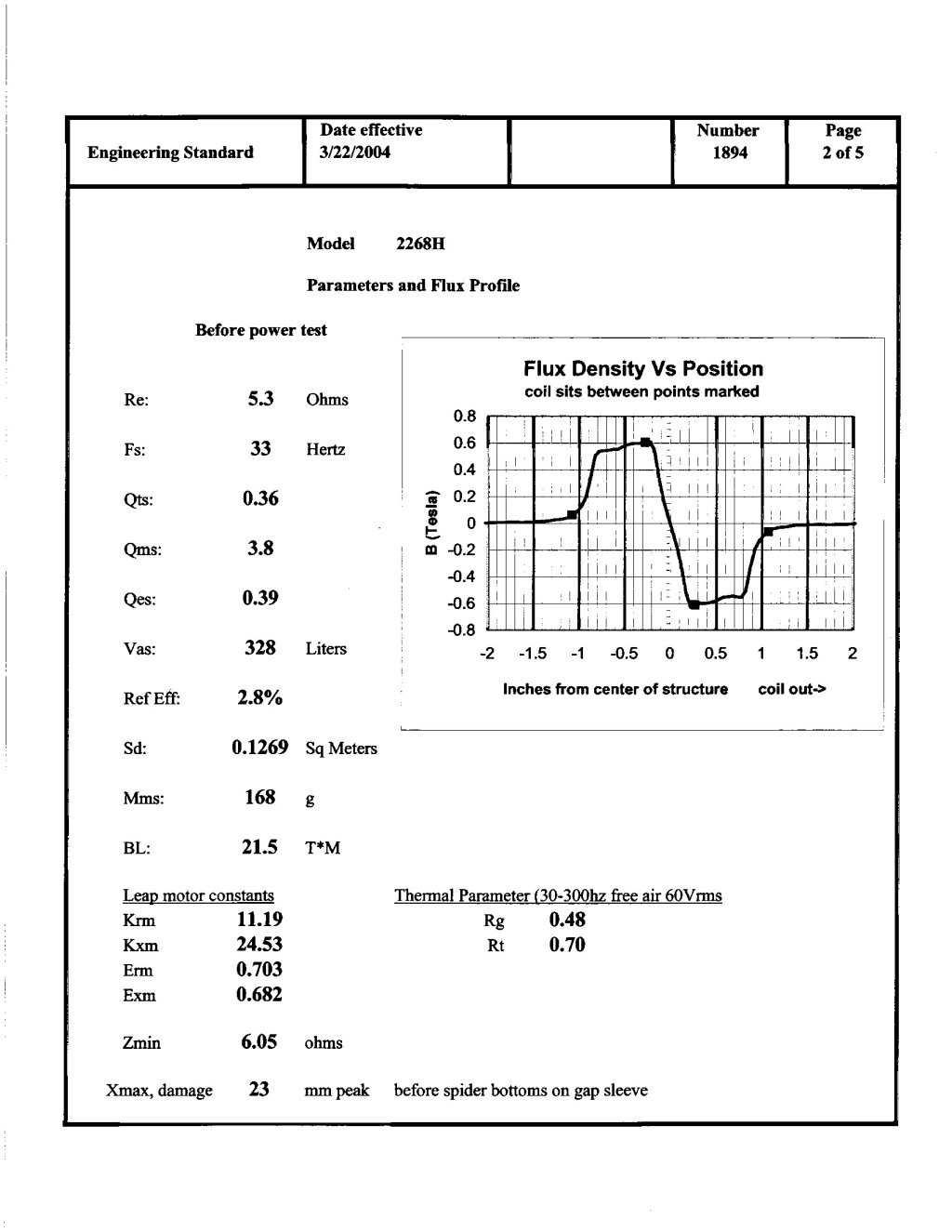

Its looking like this driver isn't going to work out for a reasonably low enough cutoff frequency. Its a shame the midbass performance is so good. Any Auquaplas coated JBL driver I've used so far has sounded good to my ears. I started another thread about some Dayton Audio drivers I'm considering.

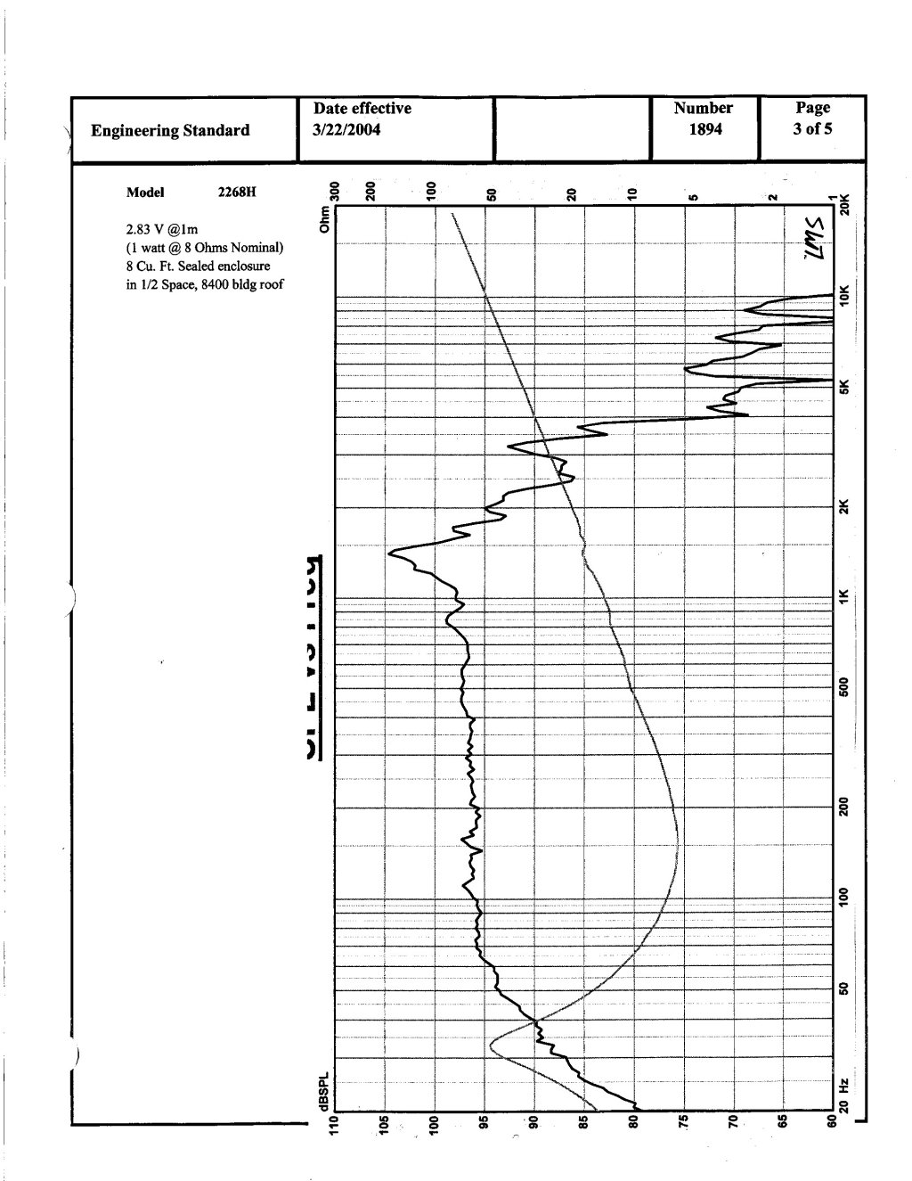

If one is willing to use around 11 cuft, one can get a nice response into the low thirties with the use of just a little EQ.
