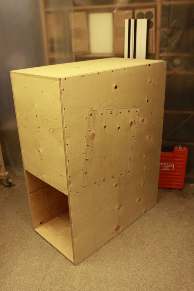

That's pretty big, what were the old dimensions?Latest revision is (HxDxW) 120 x 95 x 50 centimeters.
IC now:
The dimesions are (HxDxW) 1196 x 936 x 494. Millimeters
Depth is increased by 12 mm because I added the bracing between left and right side as seen in the 3d drawing. Bracing is now 12 mm instead of 18 mm, so the width is lesser by 6 mm.

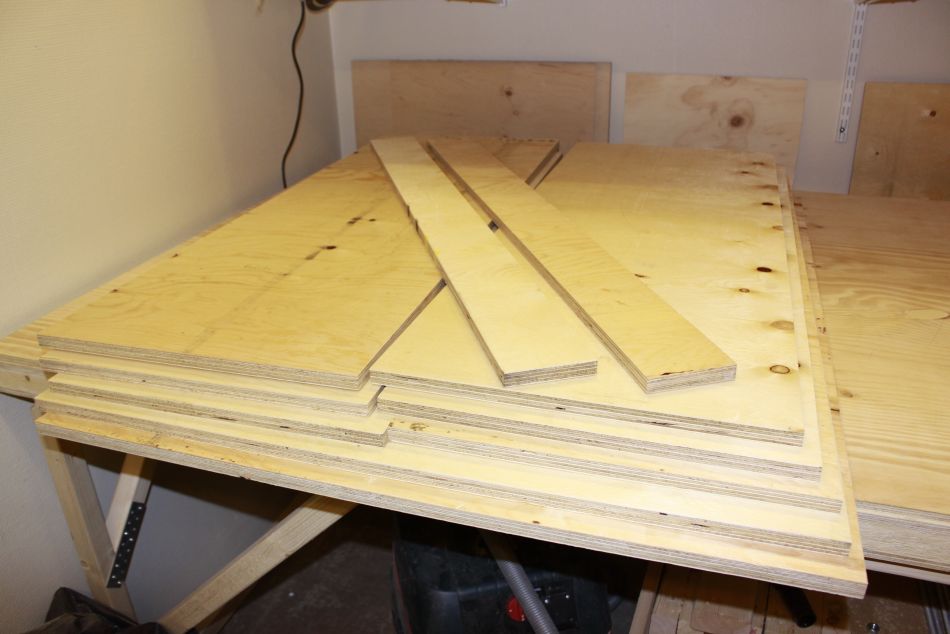

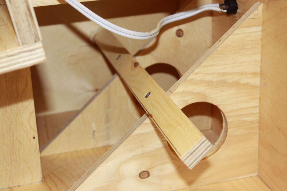

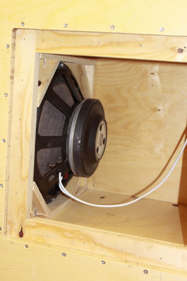

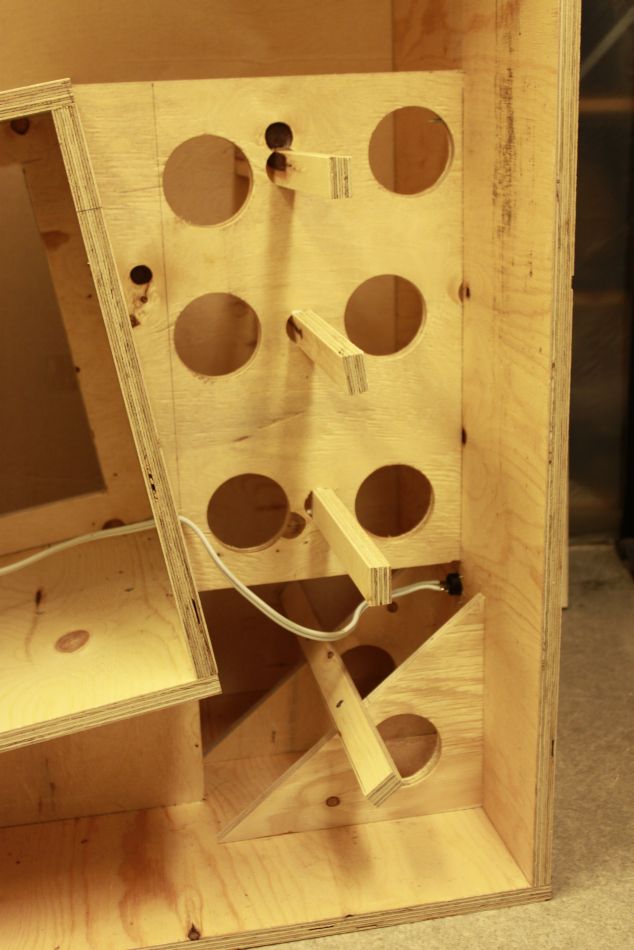

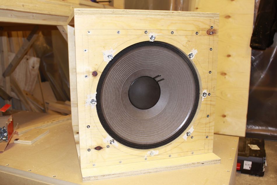

Pretty soon I will post new CAD drawings by request from Robert in Canada. Until then, here is a Hornresp record for a cabinet 1200 mm high, 900 mm deep and 600 mm wide.

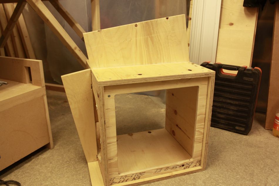

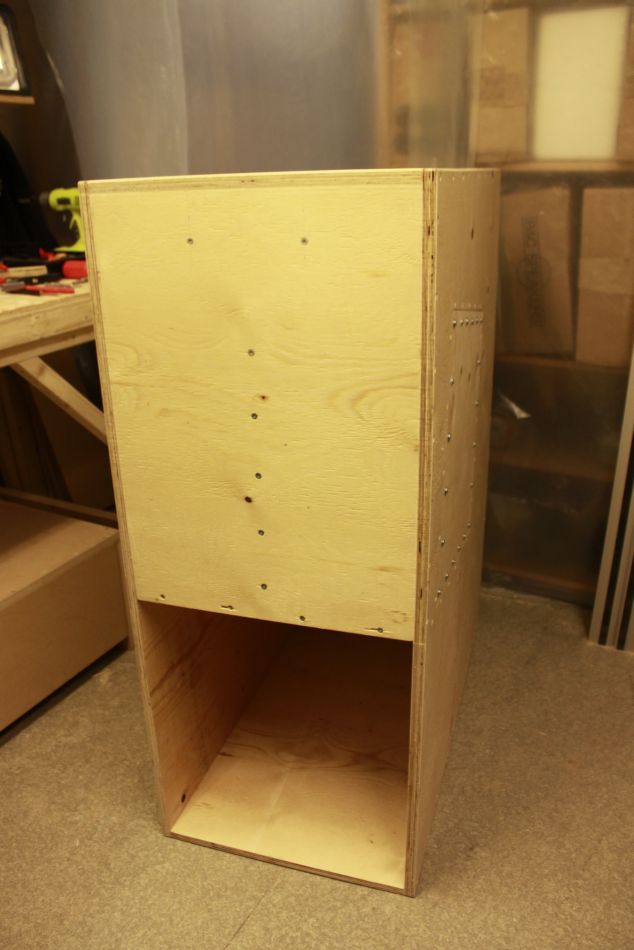

Uploading old pictures

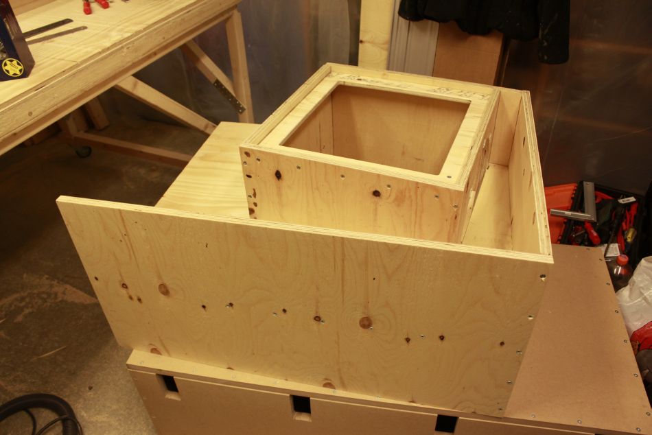

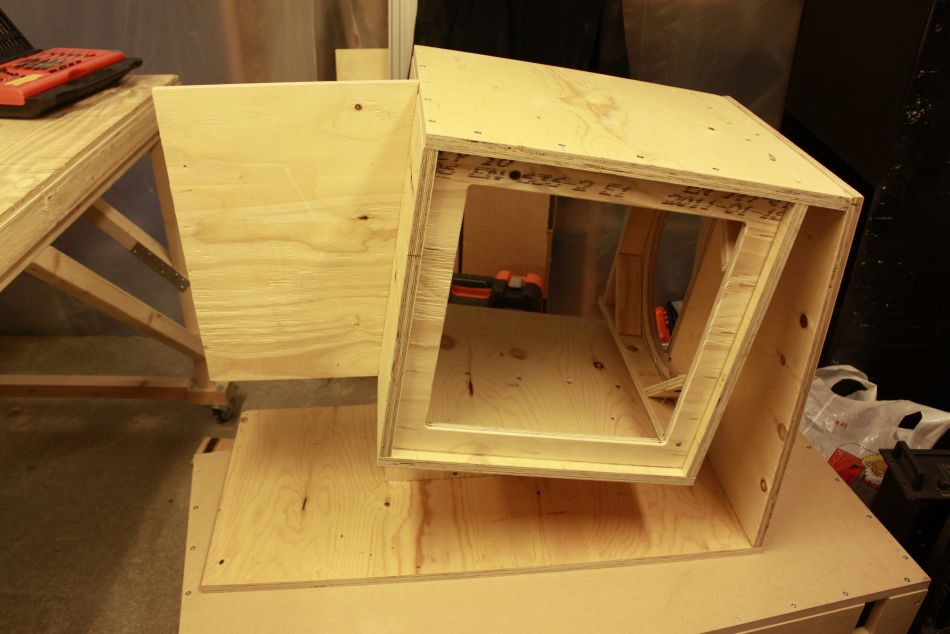

More old pictures

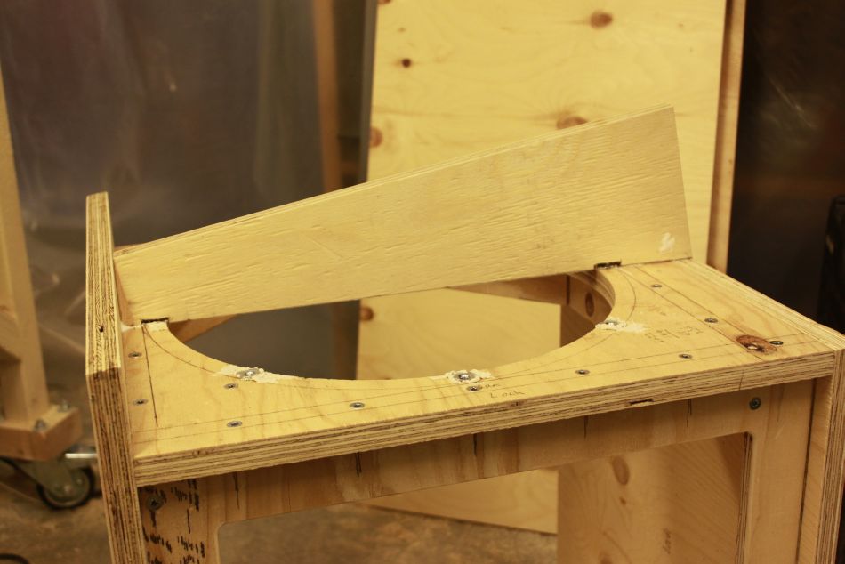

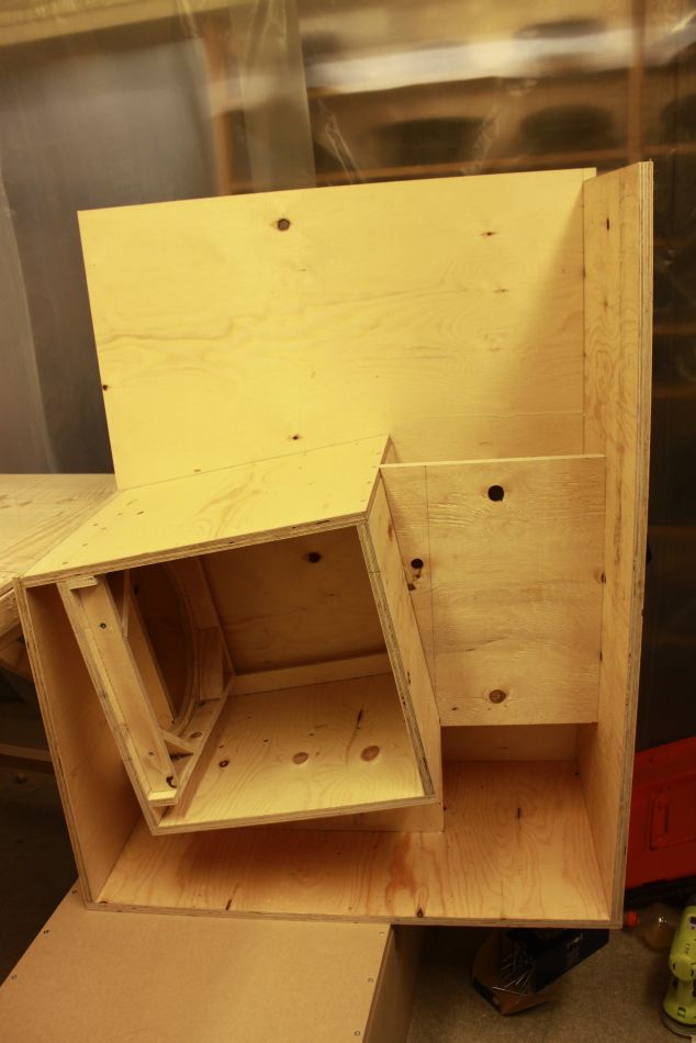

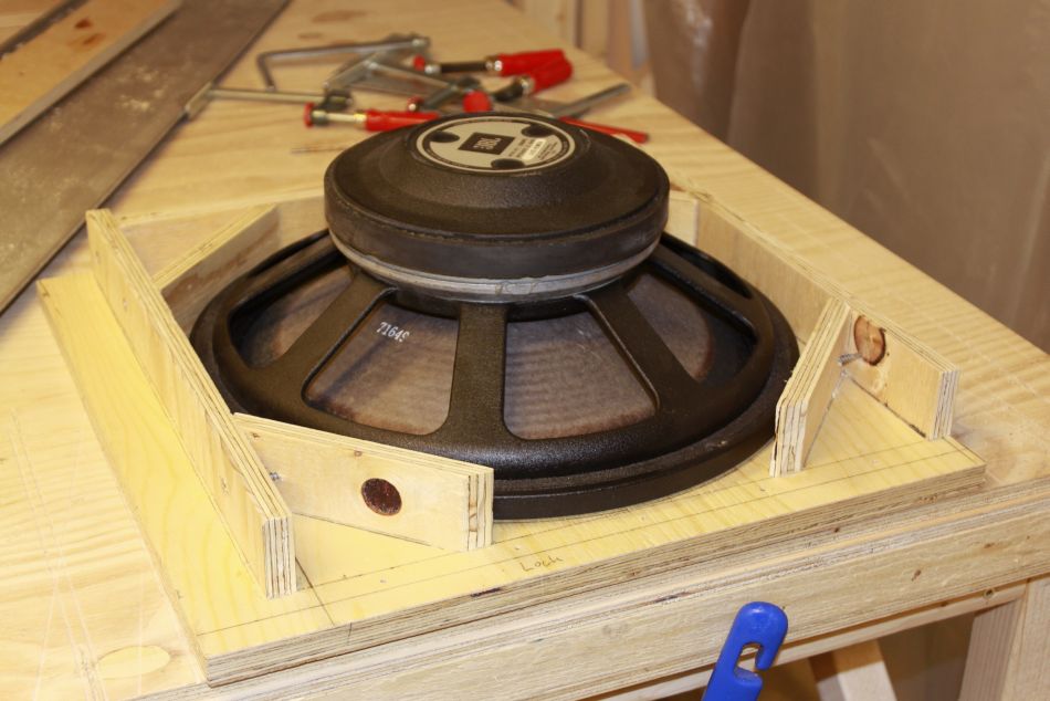

Even more old pictures

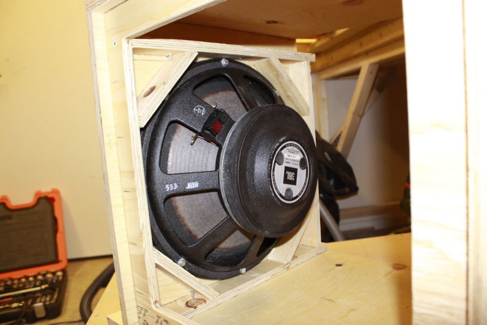

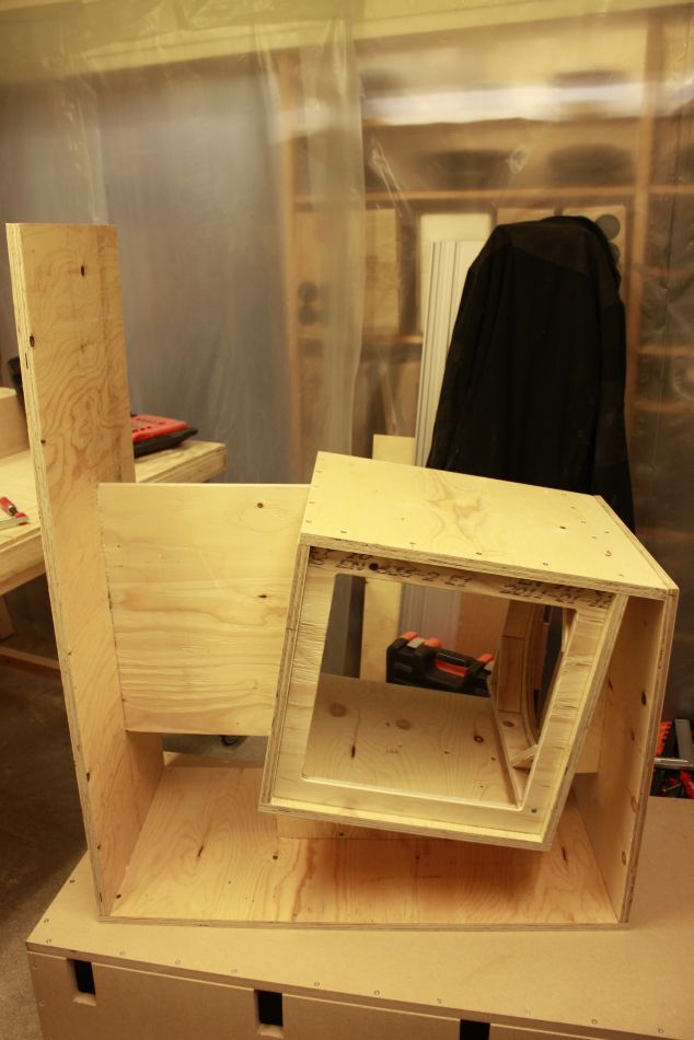

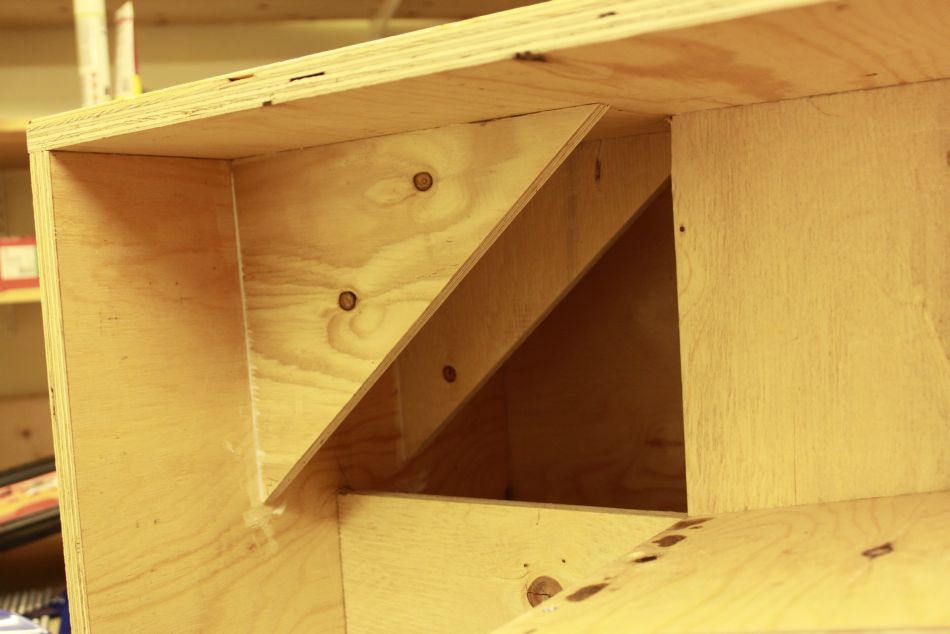

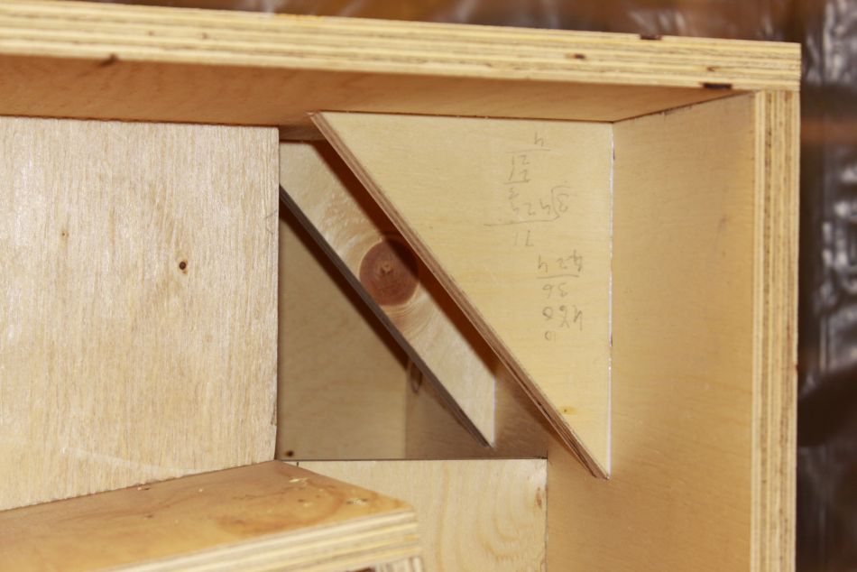

This is a very appealing folding solution from a DIY perspective, just as elegant as it is simple, just rotate a square within a square, brilliant, I have been toying with the idea to have the driver access in the angled mouth panel thus adding a bit of length (roughly 400mm in the 15" case) to the horn, the box will become bigger if everything else stays the same so some tweaking is in order should one pursuit that idea.
I know this has been our for a while now, but it still is worth attention in my opinion, thanks for sharing.
Thanks for the flattery Martinsson!
As I have said before, it is inspired by your Tham series of designs. All angles except one is 90 degrees.
