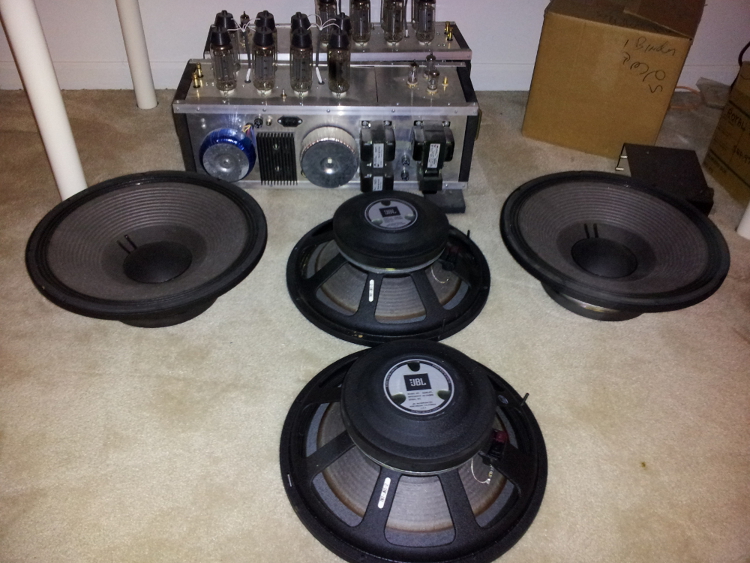

Nice Work ! I really like your microphone stand ! Should I assume that this design will work just as well for the JBL 2226J (16 ohm version). What is the dimension of the horn. I have four 2226J that is looking for a project. This might be it.

The reason I built with JBL 2226 is because I have a few of them. And thats is beacuse I like JBL and collect their drivers. I did not use 2226 because it is good value for money. It is still a very good driver, but overpriced.
The Eighteen sound 15W700 is a much better choise if you want ferrite magnet. They cost new what JBLs cost second hand.
The Faital Pros are much better, but a bit more expensive.
After all, 2226 is a 20+ year old design. They should cost at most 100$ a piece, but when you try to bargain they say, well it costs 480$ new and I want 250$ for it. The only reason JBL can sell them for 480 is that there so many of the srx boxes. Every sold JBL driver is for replacing a broken SRX box. The only reason 2226 sell for around 200$ is because we pay that for them.
