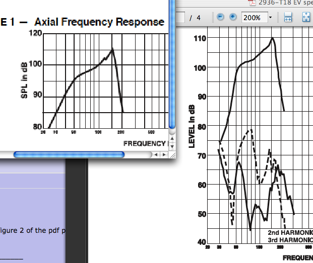

38Hz Fb with not much output down that low.
The falling low end response limits 40 Hz output to about 118 dB with 500 watts, about as much as the speaker will safely take.
Up around 100 Hz, it can do about 10 dB more, more than twice as loud sounding.
If the T18 frequency response and output level suits the music you play, nothing wrong with it, though it takes a lot of EQ to get close to flat 40-100 Hz.
Check the speakers out carefully though, old surrounds may be ripped or ready to rip.

The T 18 has an FB of 38 Hz, a steep HP of around 30- 35 Hz for home use would be OK. In room response may improve the falling LF response.
The box design is what it is, optimized for high output with the cone it was designed for.
I don't recall the JBL e145 parameters offhand, but my guess is it won't work as well in the small box as the EV cone.
Can't hurt to try, and even if it does not work as well, you will get almost 6 dB more bottom with two cabinets than one.
Just make sure both cones are the same polarity, many of the old JBL drivers are backwards from the rest of the industry.
EDIT:
Looking at the specs again, looks like the Fb is probably 48 Hz, not 38 as they stated.
A 24 dB BW HP at about 45 Hz would make sense, though the spec sheet says an "active 32-Hz
high-pass filter with a slope of at least 12 dB per octave" should be used.
EV usually was pretty good with their specs, the T 18 sheet is a mess.
Hi Weltersys!
Figure one yes.
But refering to figure 2 of the pdf plot for 30W.
The specs are all funky, I see what you got your figures from.
Looks like the box Fb must be 48 Hz, not 38 Hz, another mistake in the spec sheets.
