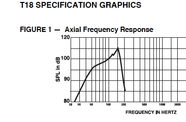

i'll bite on this one. what in particular is wrong with the EV T18 (especially if you can get it cheap)?
38Hz Fb with not much output down that low.
The falling low end response limits 40 Hz output to about 118 dB with 500 watts, about as much as the speaker will safely take.
Up around 100 Hz, it can do about 10 dB more, more than twice as loud sounding.
If the T18 frequency response and output level suits the music you play, nothing wrong with it, though it takes a lot of EQ to get close to flat 40-100 Hz.
Check the speakers out carefully though, old surrounds may be ripped or ready to rip.

Hi nuconz!
See EV's Spects and plots for 30W:
http://www.fullcompass.com/common/files/2936-T18 EV specs.pdf
83dBs at 40Hz, 97,5dBs at 50Hz, near 105dBs at 100Hz, and near 110dBs near 150Hz, and than plus 25dBs down near 200Hz;
Look at HD at 30W only;
If we search here at DIY some TH 12 examples and verify that they do the work better than that (near flat), with a fraction of EV's T18 total volume appears to me that I have to let EV's T18 rest in peace.

PASC,
I would agree to let the T 18 rest in peace.
Your numbers are incorrect however.
There is a mistake in the EV graph, the top line should read 110, not 120, as the graph lines are in 5 dB increments.
To put it in to perspective, jbel’s Stadium Horn is over twice the volume of the EV T 18 , 692 liters compared to 320 liters for the T 18.
The Stadium Horn is about 102 dB sensitivity, pretty well flat to 40 Hz, it has about 8 dB over a pair of T 18 at 40 Hz, a huge difference.
At around 70 Hz and above, a pair of T 18 actually have a sensitivity advantage over a single Stadium Horn.
Playing music recorded in the pre CD era (when the T 18 came out), the difference between the subs would not be so noticeable, but with music recorded in the last couple decades, the difference is huge.
