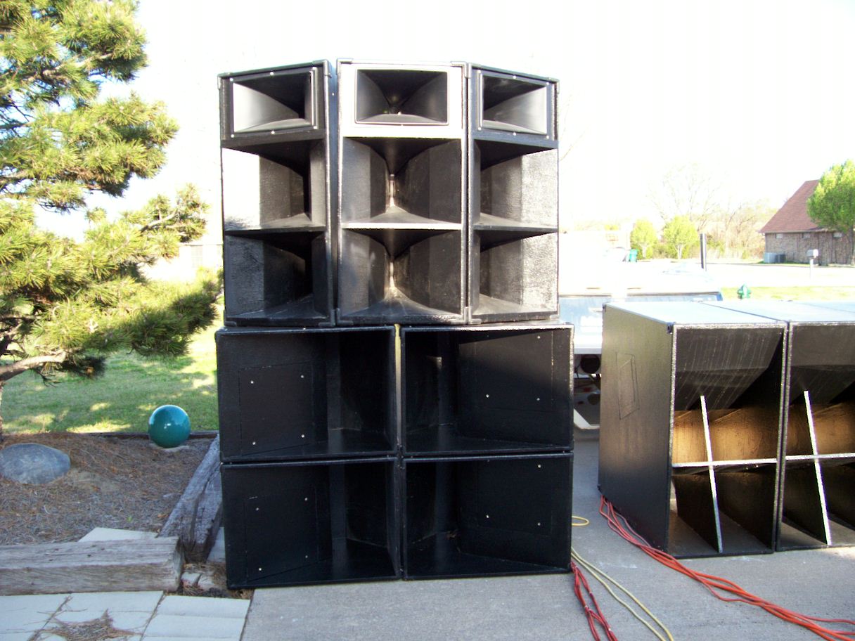

The first full range BF design with a straight horn was the Omni 10. No phase plug, rectangular throat, single angle horn plates. Slot port in the baffle, which I remember some bass players complaining about "chuffing" at high volume. The horn was about 15" wide, the cab 21" wide and tweeter array on the side.
These were actually very good sounding boxes for small PA duty. I corresponded some with JBell around this time, he had shoe-horned the O10 horn into the wedgehorn 8 shell. I built a slightly different version, really a tilt back O10, as a monitor that worked quite well with no ports at all.
In general, using the Eminence drivers with "rising response", the phase plug, LP/HP crossover were all purposed to offset/improve on the limited range of the piezos. None of the original designs with piezos had any crossover at all.

Power response of that type of horn start to take a dive by around 800 Hz. With highish mass low BL drivers (ie. Eminence) its worse than old standbys like the EVM12L - which would have trouble making 80 Hz on the low end. Unless you're gonna cross to a 2" CD/horn you'll still need a rising response in the mid/bass driver.
Of course some would have you believe that you can EQ out any anomaly caused by things like falling power response. Works ok above 5k where you don't need many watts. Eating up headroom in the midrange causes problems IMO, so the flatter you can make it the better.

An exception with the low BL Eminence cones would be the Delta 10A, which horn-loads rather well. Wayne Parham uses it in his Pi Midhorn & crosses to a 1" driver at 1600Hz. He shares the design details on his website.
The Delta 10's were the original high mid driver in my 'cluster****s' array, before biting the bullet and getting 8PE21's. You don't get something for nothing with them though - they don't go down spectacularly low. Only 100 Hz in a reflex box, not quite that far on a horn. Really good 200 to 2k. I was still looking for the nirvana driver that could horn load down to 80 (with enough excursion to do something with) and play to about 1.3k cleanly without relying on EQ. I finally said the hell with it, split the band at 300, and folded the bottoms. It made for a really big system, but with 8 lab horns who cares if the tops are on the large side?
