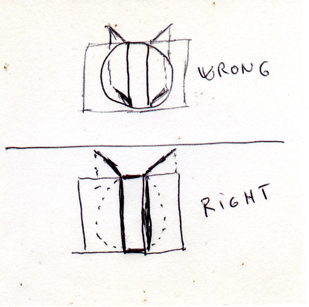

Sorry to note that you must close overture between outpeaker bord and 4" cutout, otherwise is an acustical short circuit. You have no front compression because wave goes short by direct connection between front and rear waves:nownow:.
Looking at the original plans on page 1 of this thread, you can see that Jbell does close off the outer edges of the speaker in the plans with scrap pieces of wood.
