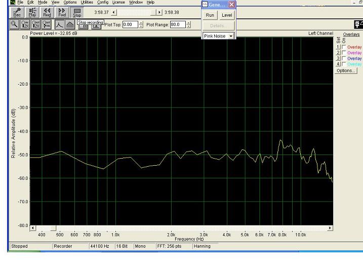

I can't remember if this was no eq, or if I had applied a db or 2, I know I have VERY limited eq applied in the dcx2496.
I originally went to drastically tame the 8khz piezo spike, but in the end, I didn't completely eliminate it. Leaving it let the system seem 'crisper' even though I know it should have been eq'd out. Also notice, the complete lack of the 500hz 'boxy' sound that you get with a 10" long mid-horn. It was breezy enough that day (from memory) that I was only looking at 350hz on up.
I wasn't using smaart for this (didn't have it on my laptop at the time) so this is Spectralab, creative usb mp3+, art preamp, and superlux ecm999 reference mic. Measurement in the stands, about 10 yards to the side of the press box, about 15 yards to the front of it.
Oh, and tops integrating with the TH... well, let's just say a big grin happens anytime I listen to this system
that's about all I can remember from a year back.

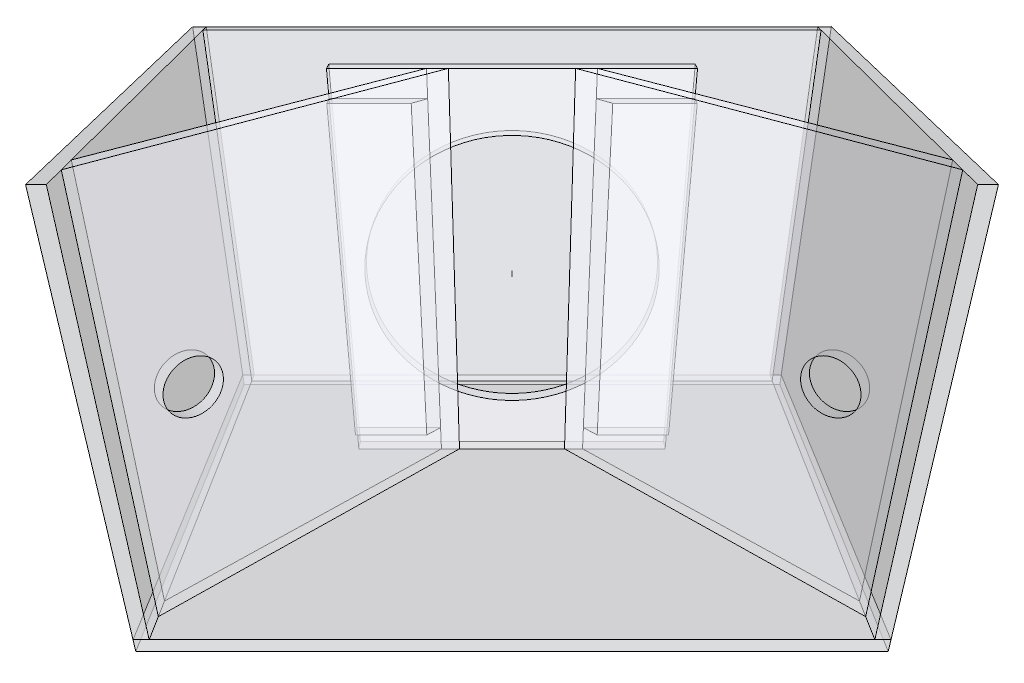

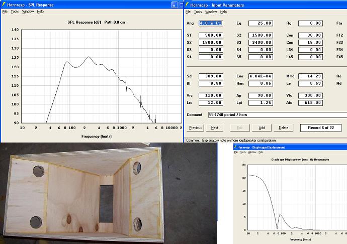

Did some playing around with hornresp, and it appears that the dual flare box I'd built awhile back, still seems to come out pretty good in 4pi space. I've learned the hard way, to ALWAYS use 4pi when designing a top. Also as you stack, the response evens out, and is not near this lumpy.
Anyway, if you are interested, your beta 10's would do very well in this style cabinet. Notice the bump at 250hz, instead of 500hz... If you want more details, I can provide them. (or maybe don will be kind enough to draw this up in cad, like he did for the TH.)

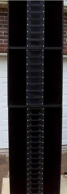

What I have simmed is a dual driver cabinet, 24" cube. If you stack 4 cabinets high, that'll be 8 drivers, and 132db@1M, and with some nearfield line array propagation, well, these should carry pretty well. If you stack 6 cabinets high with all 12 of your drivers, that'll get you 135. That's rock concert level a long ways from the stacks.
Attached is the hornresp sims, and a pic of a single driver test cabinet. I started cutting out ply tonight to make some dual driver cabinets for my park pa gig later in the summer.
cabinet details:
Dual 10" top.
build 24" cube shell.
horn path, two flares
13" long x height, 20degree at horn throat, 25degree at other end
8" long 45 degree at front of cabinet, square against joining 25degree angle
Where above two boards meet is approx 6" from front and 6" from side.
horn throat/driver mounting baffle, is 12" by height, with 3.5" wide x 8" hole, driver centered over hole.
Note, rounding top and bottom of driver opening slightly, instead of square hole sounds better.
Ports can be either deep in horn (even on driver baffle) or toward front of horn. If ports are 'back in horn' it lowers cabinet tuning.
Best sound with subs+tops is with ports tuned to 80-95hz with tops crossed at 100hz.
Here's a pic of one I was playing with, using the port deep in the horn throat.
Yes, if you use 3.5K piezo's you get a big hole in response, right where you don't want it. If you use 1800hz piezo's, you don't.
I know this design is kinda lacking at 100-150hz, but with the overlap between the subs/tops at 100, this seems to integrate well with the tops coming on strong at 200. Also, if you run your port tuning up to 100hz, you'll minimize your excursion in that range and you can push a little harder

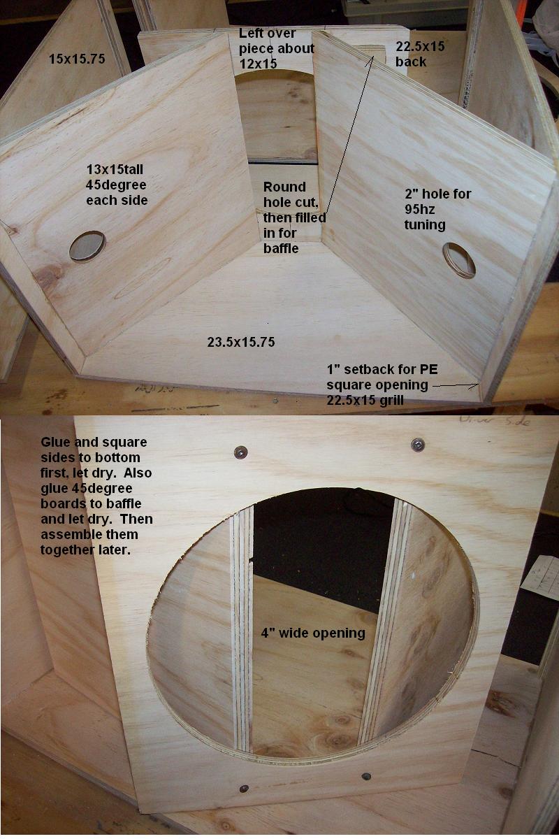

Here's the best pic to show how my tops are built. The horn 'plates' are 13" long, and 45 degree angles on each end. It was designed to use partsexpress 15x22 metal speaker grills. I just bolt a 12" dayton waveguide to the metal grill and use a 16ohm selenium crossed at 2k. It uses an eminence beta 12a-2, and ports are tuned to 95hz. (sorry, not a fan of the cheap eminence compression driver....)

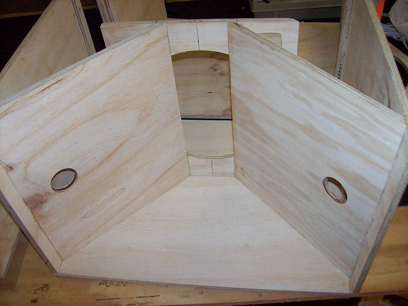

I've had a couple questions about the HS12 tops that I've been using with the SS15 subs. The name HS12 is 'half sheet' 12" driver tops, as I can get a pair of them (barely) out of a single sheet of ply.
Attached are a couple pics, and any enterprising person can from these, reproduce my tops. I personally use eminence beta 12a-2's with selenium 16ohm 220i compression drivers. I use a simple 12db/oct 1900hz crossover with high C=2.6uf, L=2.68mh and low C=5.24, L=1.34mh. (at least that's the values the crossover calculator gave me.) I used parts express components that were as close to that as possible, the high capacitor needs to be a poly, and the high inductor needs to be air core, electrolytic and iron core is ok for woofer. If you are going to stack, the goldwood gm-500pb horn works, and for single cabinets I've used the dayton h12rw 12" conical waveguide. In both cases I just bolt the horn to the metal grill. The PE square hole grill is very strong and is actually what I designed this cabinet around.
Ports on the sides create feedback. Ports deep in the horn sound funky...
The baffle with the small 'fill' plates is easier/faster
The cabinet size is designed for a PE metal grill / and horn lens bolts to grill. (only use the square hole grill, round hole PE grill is too flimsy)
The horn is a low pass, and the eminence typical 'rising response' counteracts that. (horn low pass keeps you from having to eq out the midrange 'honk')
Any cabinet not 'midbass heavy' in 2pi sounds weak in 4pi (on stands) so yes, this is kinda a 'midbass heavy' design. You can see how even in single cabinet, this design is strong to 100hz.
A selenium 220ti-16 80w/40w sounds MUCH better than an ads1001
16ohm selenium matches up to the 8 ohm beta12a-2 almost perfectly, no resistors needed in crossover.
VERY LITTLE eq needed when used with the dayton 12" waveguide, and a nice open, non honky sound comes from compression driver.
1.9khz crossover means no 'fillers' needed, no need to get 12" to run up to 3.5k (selenium can go down to 1.5khz if needed)
95hz port tuning means this cabinet is good xmax down to 60hz if you 'have' to run no subs, and is strong down through 100hz. (which is important for male vocals)

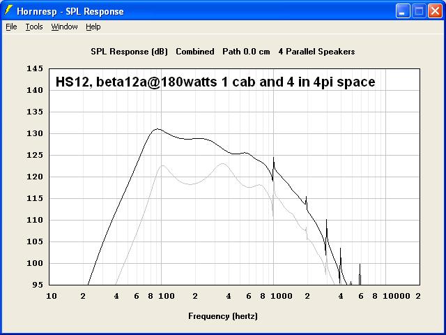

SS15 is good for 63v (500watts) and HS12 with the beta12a-2 top is good for 37v(180watts)

SS15 is good for 63v (500watts) and HS12 with the beta12a-2 top is good for 37v(180watts) Your kappa+psd tops (if you build them) would be good for about 49v(300watts)

Ben, you are on the money on the design. Yes, I started with an OT12 style cabinet and fixed the things I didn't like.
A selenium 220 sounds MUCH better than an ads1001
Has anyone built these yet? Did you keep the top/bottom removable in order to access components for replacement/crossover tweaking? I'm planning on it.
I made the back plate removable... I made 2 versions... one just like the measurements specify and one that was 24 wide by 16 deep.. Woofer I used was from ebay.... Pro Audio 12" Pair DJ Replacement Woofer Speakers 1000W PP121 | eBay and they sound very decent... I have no way to measure results and you can't push them too much but other than that very very pleased with the sound.

I've built 4 of these so far and I am really impressed... I am almost finished with my final 2 boxes, which will use the Dayton 12" and the eminence CD... will post pictures once it is completed...
Here are the pictures of my 4 Builds...

According to jbell's post: "Ports deep in the horn sound funky"
Those ports seem fairly deep in there. Did you experiment with port placement?
Also, have you experimented with compression driver horn placement? One of its purposes is to prevent beaming of the woofer by mounting it in the center. I notice on your 2nd (from the bottom) enclosure you've got it mounted on the top. Is this due to mounting difficulty in the middle? Or something else?
I just placed them in the center of the panels, I read that but I guess I didn't think they were deep in there..
The top ones sound like the bottom one, so yes I am still experimenting...

can beaming be measured?
I am still trying to learn the REW software and what all those things mean.

I assume beaming will show up as being heavy in some frequencies head-on and less so off axis.
REW gives me fits on my Mac (or I'm not doing it properly). Gonna give it a shot on the Windows machine soon.

Beaming? It's only the directional curve at various frequencies.
For a small cabinet place it on a record player turntable, place a protractor on top and do a frequency response curve every five degreed or so. Then turn it on its side and do it all over again. While you're at it, change the pink noise generator for a fixed frequency oscillator, and do a series of polar curves like that.
For a big loudspeaker extend your protractor larger than the cabinet, find a railway shunting yard which shuts down at night, with a railway turntable…😀
Then repeat for two stacked cabinets, preferably with the mic at different heights.
