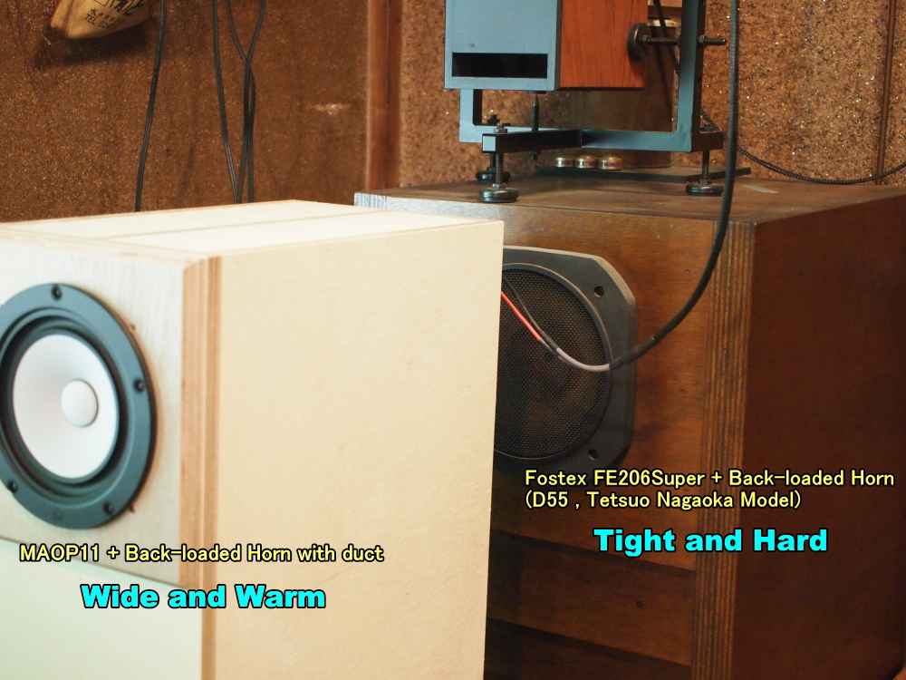

MarkAudio MAOP11 is almighty driver.
I use BH with duct.
Jazz Sounds at MAOP11 and 300B-single

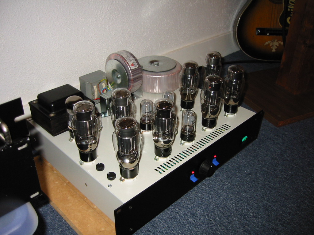

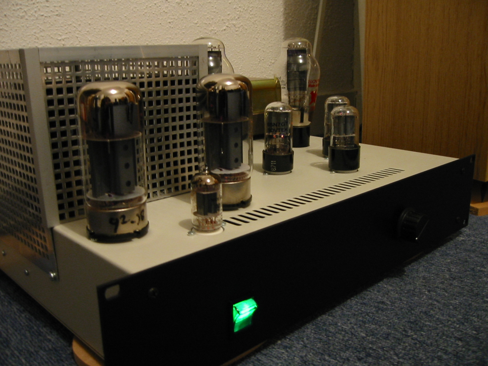

Hi xrk,
Thanks for comments, I was trying to avoid my 'version' in description because I never listened to them with 300B amp, all my tube gear by now is gone.
But 20 years ago I had extensive amount of self made tube gear - all used with Rogers and later with KEF LS3/5a and it was really most saturating musical experience to date.
I have only one picture left with my first tube ( 6V6 PP mono-block ) amp next to the Rogers and later with KEF together with 300B and 6080/6AS7 OTL amp.
None of them were power monsters but still more then enough power to drive them nicely, surely because of high impedance provided by ls3/5a...
