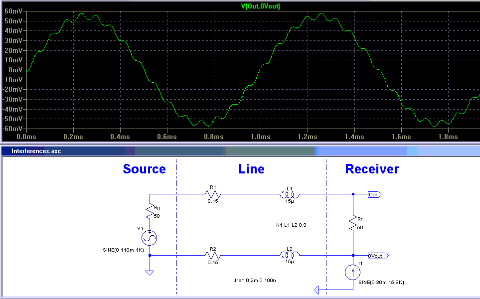

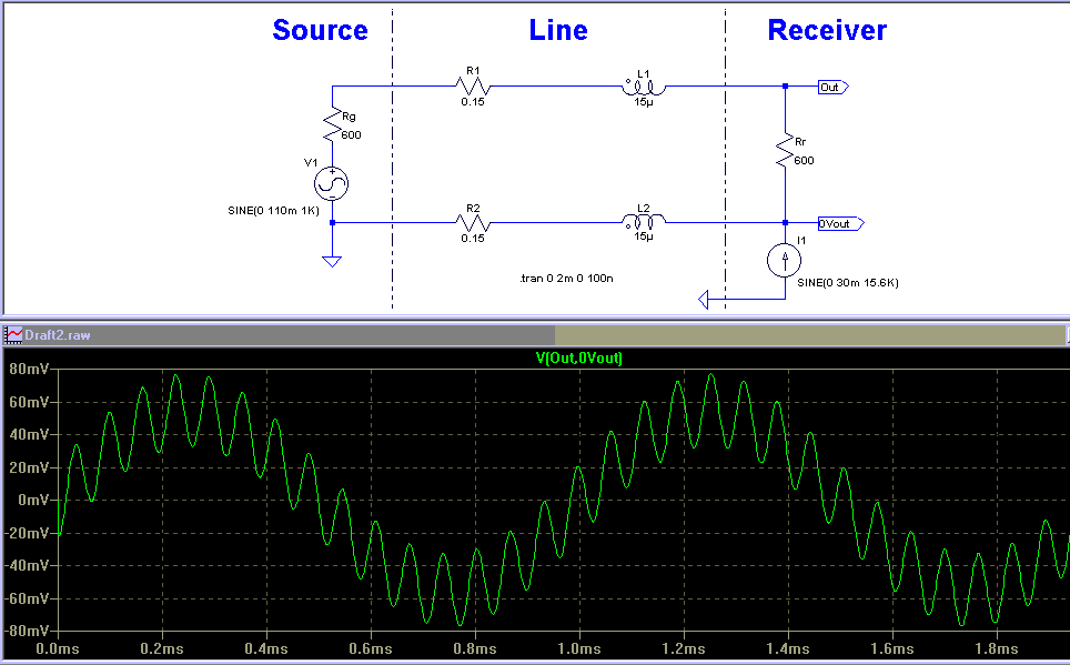

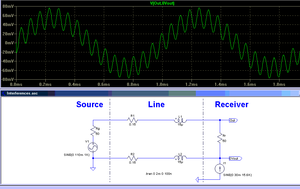

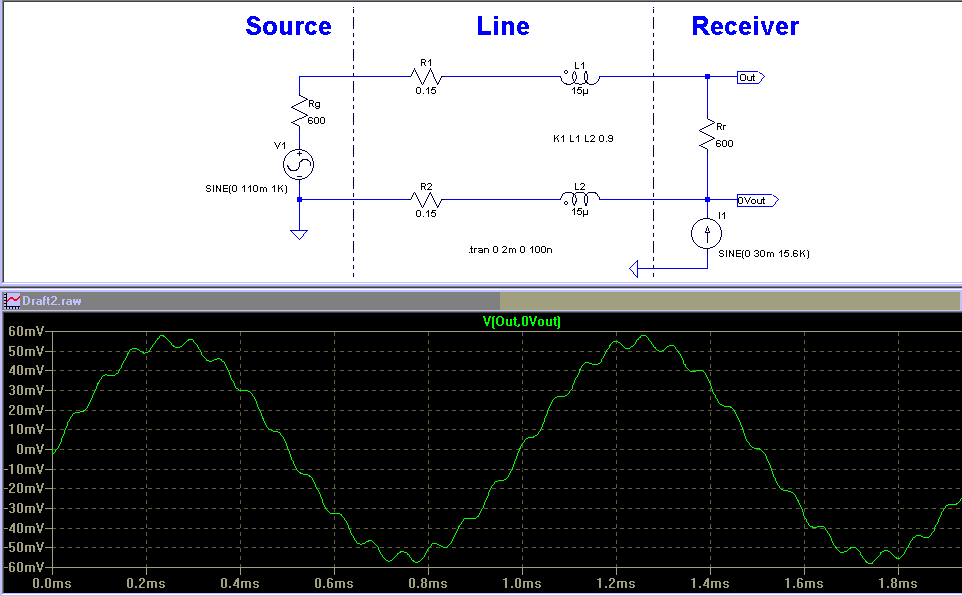

I was talking about induction from ground wire current into signal wire.
Here is a typical example: a 1KHz source transmitting the signal to a receiver injecting a 15.6KHz 30mA^ current into the ground.
First picture is the case where the induction between signal and return wires is negligible.
Second picture shows the effect of a strong (0.9) coupling between the wires (equivalent to a tight twisting): some cancellation of the unwanted signal occurs.
A ferrite on an unbalanced connection is a bad idea because it will increase the noise induced into the signal line by ground currents. It may help, if the noise from EMI was much greater than that induced by ground currents.
It will indeed increase the "absolute" noise voltage on the ground, but at the same time, it will reduce the relative effect of the common mode to differntial conversion, and will ultimately be beneficial (unless there are multiple connections, some not sharing the same ferrite)

Thanks. Although I see that you also changed Rr, instead of just Rg.
So, what can we conclude from that?
Is it always a good idea to tightly twist ground- and signal wire with unbalanced connections?
Both from the point of view of minimizing loop area for minimizing RF interference, as well as for minimizing coupling ground ripple & noise (both inductively and capacitively) into the signal wire?
jan
I would tend to answer unreservedly "yes", , but we have to careful: as soon as I say it, somebody will come up with some exception I hadn't thought of.
Thus, let's say: in general and most of the time, yes.
