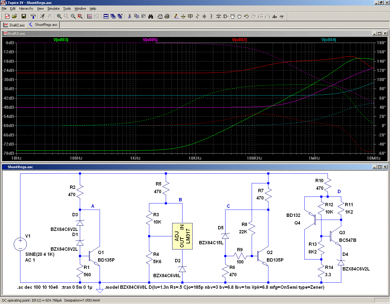

One or two informations, for those unfamiliar with simulators.
The behavior of the regulators is studied by looking at the transfer of 8Vpp ripple superimposed on the 20VDC power source, V1 (time domain).
Frequency domain is identical, except the ripple frequency is swept from 10Hz to 10MHz, and is small signal.
Hint:
The colors in freq. domain and time domain are identical (I didn't think it could turn out as a hint, but there it is).
Further hint: the simplest solution gives the best compromise between static and dynamic performances.....
The problem I have with for instance the green V(n003) is that in the freq domain it has the best suppression (-70-something dB) while in the time domain it has the highest ripple amplitude. I can't make any chocolate from that 😕 . Unless I miss something grandiosely?

LTspice seems to have played tricks on me: the colors did change between the frequency and time domains.
Sorry for the blunder.

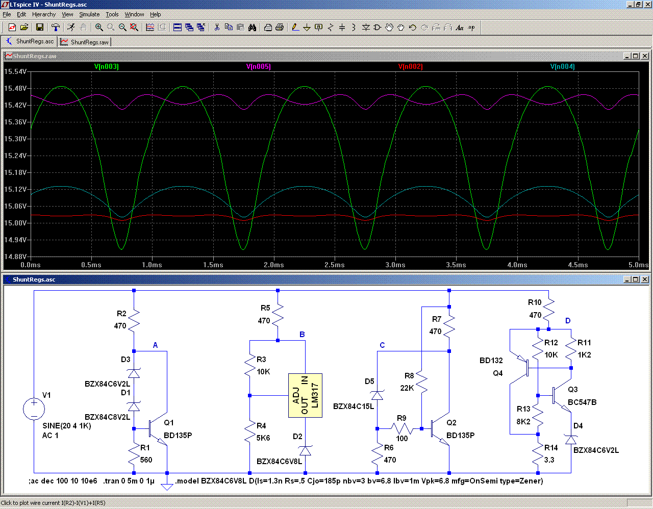

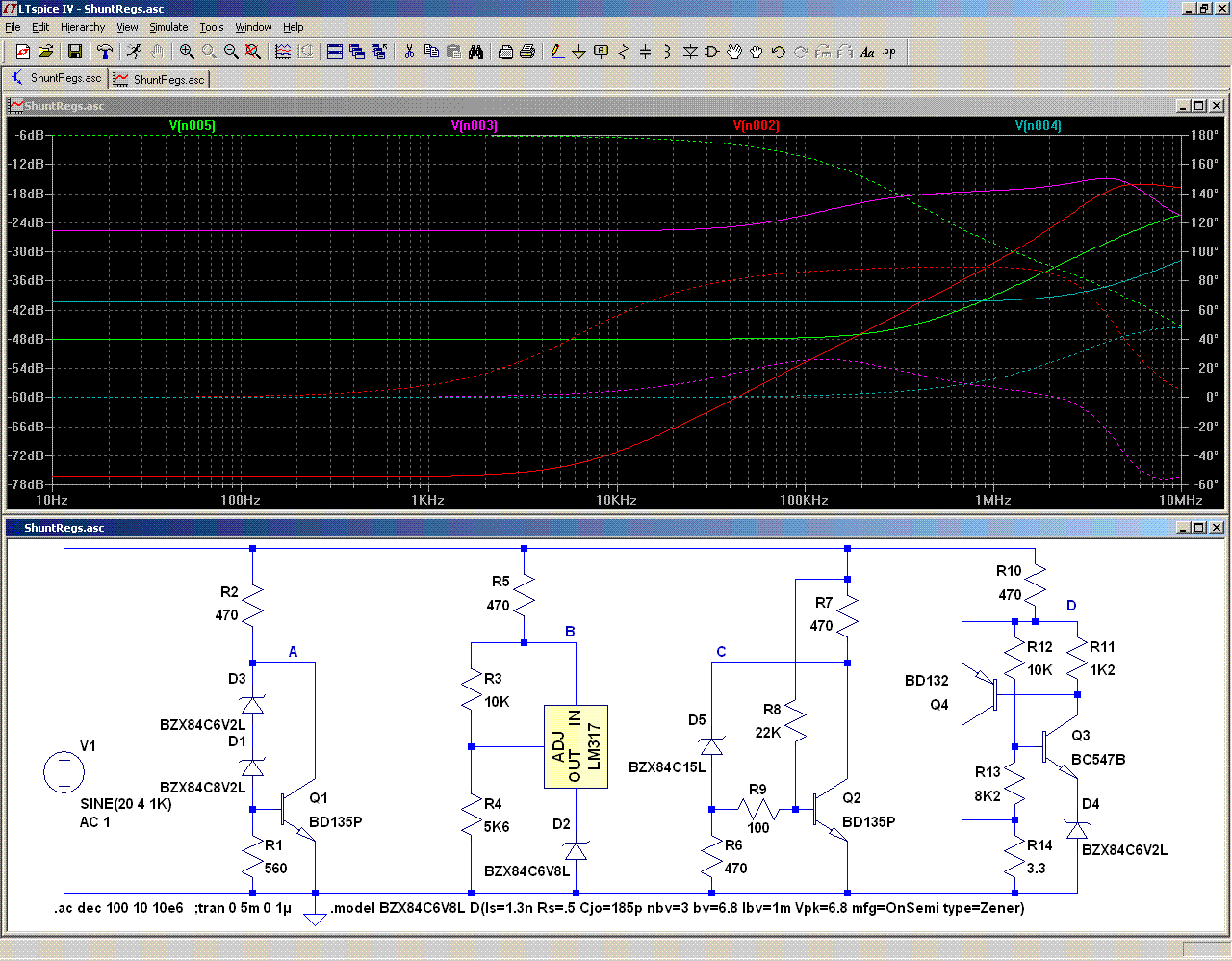

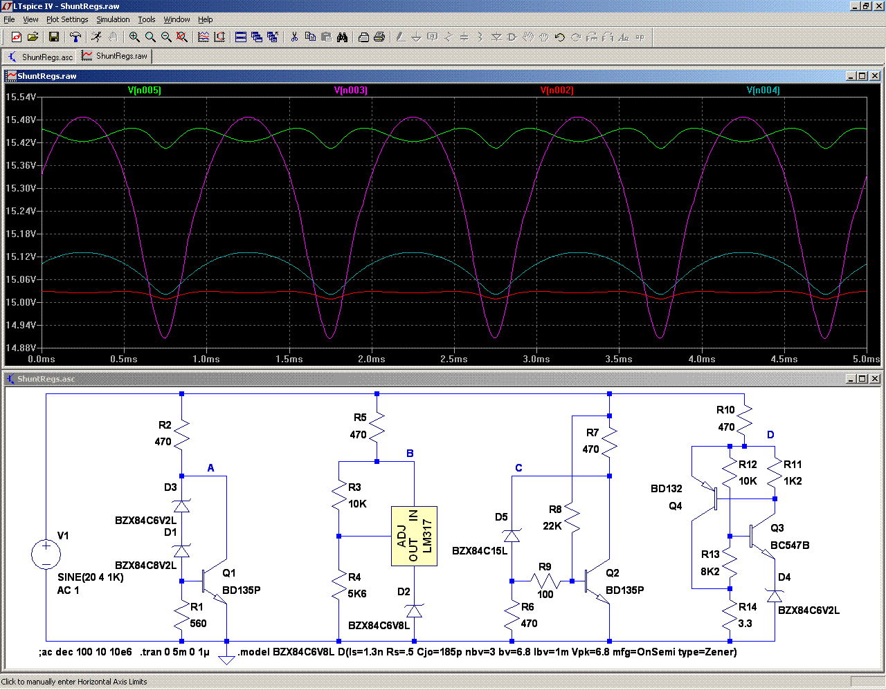

Here are the two diagrams side by side again, hopefully with consistent colors this time.
Two of the circuits are compensated. They should be easy to spot from the time domain.
I would think D is the red trace, and wonder how critical the various circuit values are wrt device variations.
On the C circuit, I wonder how it would look if R8 were filtered? Or do you need R8 to cancel partly the ripple?

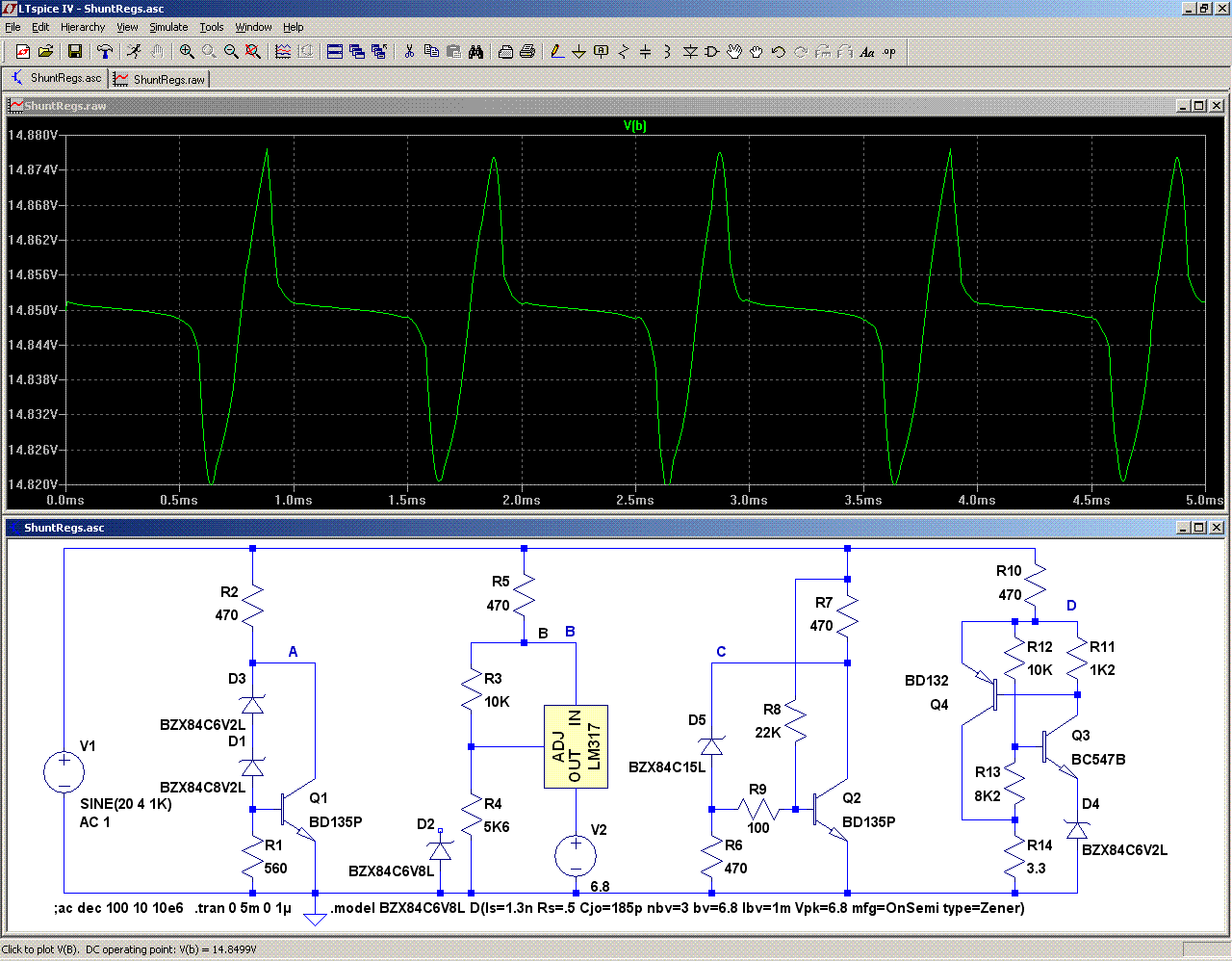

For the B circuit, could you run that with an ideal voltage source instead of the zener in the 317 output leg?

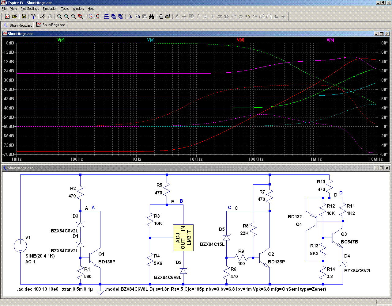

Edit: red=C, green=C, magenta=B and pink=A I think.

That is correct, and for a given output voltage, the sensitivity to components is low.I would think D is the red trace, and wonder how critical the various circuit values are wrt device variations.
The value of R14 must be adapted accordind to the voltage, but once it is done, components variations have little effect.
Filtering R8 would cancel its compensating effect.On the C circuit, I wonder how it would look if R8 were filtered? Or do you need R8 to cancel partly the ripple?
Here it is:For the B circuit, could you run that with an ideal voltage source instead of the zener in the 317 output leg?
Green=C is correct, so is magenta=B, but there is no pink trace?Edit: red=C, green=C, magenta=B and pink=A I think.
Interesting! Looks like the zener is indeed the weak factor in (B). With a voltage source instead, it's almost as good as the best at least for lower frequencies.
BTW You can gain another handfull of dB's ripple supression by putting a cap across the top resistor of the output voltage divider.
