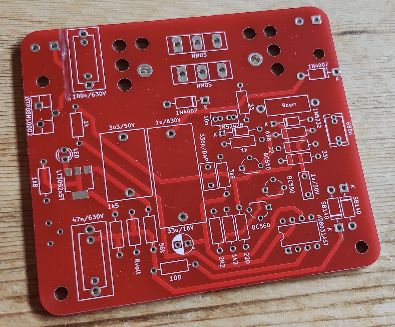

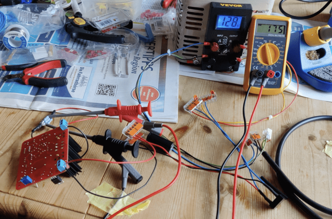

I have now finished Jan's T-Teg5 with my own layout (just a little bigger than Jan's original, but I like to do my own if I can).

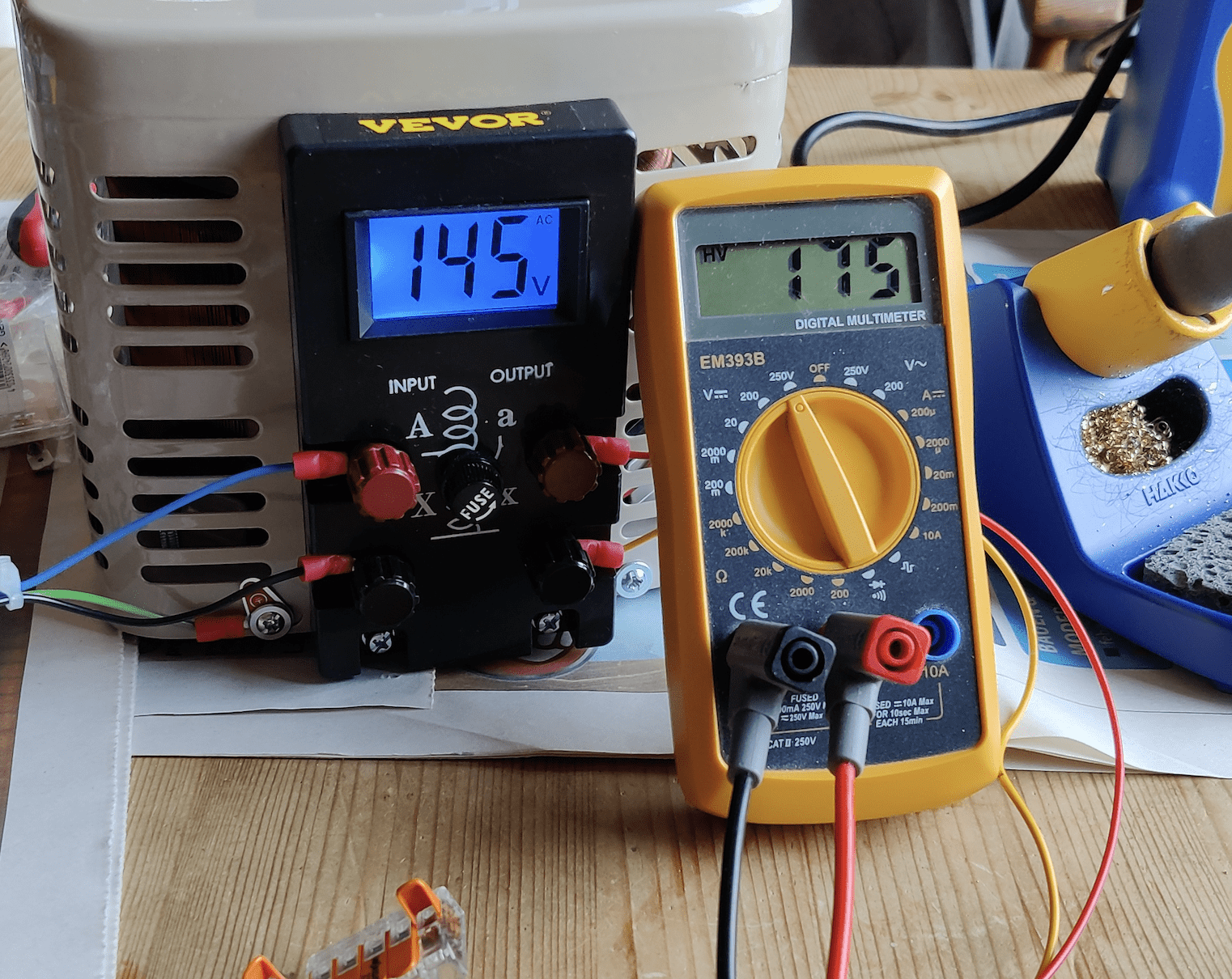

In my test setup, using a variac as input, followed by just a bridge rectifier and a 100u cap, I met the targeted 175V almost on the spot (I used spice to find the right voltage-defining resistor at 50% pot setting for 175V).
The regulator is intended for a 300B B+ supply at 425V, so the 175V was just a test, but I am confident that will work too, given the flawless operation at the test voltage.
Regarding MOSFETs, I have tested with IRFPG30PBF, as well as with IRFPE40PBF, both from Vishay. Both are working perfectly without any change, like the Zobel circuit I had used in my sims (see some posts above).
Thanks, @jan.didden for publishing the circuit.

Also, be aware the above are TO-247, which will not fit on Jan's original board, but there might be identical with the footprint Jan has used.
