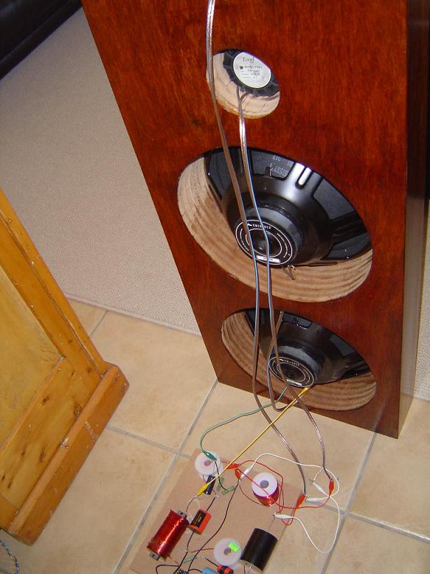

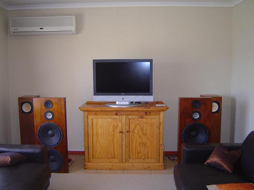

Just a quick update on progress so far. Attached photo of my J909's (Joseph 909 🙂
Ended up using Quaser Mk II type baffle - 7 layers mdf sandwitched together covered in walnut veneer. The Jamo bended baffle was just to difficult to get right for diy construction.
I'll have audio quality crossover finished by the end of the weekend and will post some feedback.
I had some fun listening to the J-Clones this weekend! I initially had the wiring to the mid mixed up and started with really horrible mid range sound. Going back to schematic fixed it and suddenly there was sound. These speakers were not the cheapest diy projects with 8 drivers which included expensive scan speak and seas drivers but I'm not disappointed. I'm sure the Jamo's will be better (Jamo did employ audio engineers on this as a 8 year project) and more refined but I'm sure that these will come fairly close. I'd like to spend a bit more time with them before really commenting, but certainly all the usuall comments apply made by open baffle converts. What did surprise me was how quit these speakers are, the bass is there when it should be not otherwise. I will certainly be burning my box speakers! Another surprise is that how efficient they are. Even with my EL34 valve amp I've never had the need to go past 34% on the volume control. There are also no distortion even playing very loud, so much so that it is difficult to realise just how loud you are playing.
On the downside, there is one specific note that is jumping out somewhere in the mid/high crossover frequency which I would like to tame a bit. I'll do some measurements in the next few weeks and try to find what is causing this.
The other fault (and I'm not sure this is a real fault) or just how good high end sound should be? I'm not sure the different drivers blend together properly. This I say because it is so easy to distinguish different sounds from multi instrument music. I certainly don't get this sense when listineing to normal pop music.
A last comment is on the tonality of the mid range sound, it's just a bit different my conventional speakers but you ears adjust to this within a few minutes, then the ob's sound better than box. Is this just part of the speaker colorations/character or a design flaw in the crossover?

At the end I’m extremely happy, you can’t see it in the picture (I’ll upload some decent pics tonight) but the walnut finish is really rich and alive. The thin “box” look also makes it look like a conventional speaker.
There is one small problem with a 4 1/5 inch baffle. The cavity behind the mid driver caused some serious resonances. A quick fix to this was a couple of socks jammed into them, later replaced with some hollow fiber filling. I guess this cavity is deep enough to start acting as some sort of port. I’ll do some measurements with/without the stuffing to identify the exact frequency. Another maybe better option would to enlarge the hole a bit? I don’t really want to loose the open baffle sound by using too much filling. This has really fixed my concerns previously mentioned, the sound is now very well behaved and even the hardest metal sounds very smooth.

If the cavity around the midrange is resonating I would try flaring the hole towards the rear. It's too late now but cutting holes of ever increasing diameter in the layers of the MDF would probably have been the simplest way to create a flare.

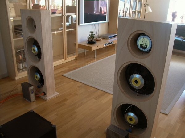

I finally have a couple of accelerometers (part MSP1001-ND) from Digikey so I hope to finalise my baffle shape/construction soon.

Wouldn't be too hard to file or route the rear side of the mid cutout.

You could use a Stanley Sureform or equivalent, like this (the flat file, but with the half round blade):
http://store.qualitydist.net/stsuto.html
It would mean removing the drivers because it would have to be done from the rear towards the front with the baffle face down, but it could be done free hand. I would not file closer than about 1/4" from the front surface, and I would mark a guide circle concentric with the existing circle but at the intended final diameter, as a visual aid.
I used to do this as a matter of course with my mids, which were usually mounted in 3/4" mdf.

With regards to the mid cavity you are right; I will need to open it up. What an embarrassing flaw, in hindsight it is so obvious this cavity will cause resonances and impair open baffle sound. I haven’t encountered many thick baffles like this on the forums except for the Quasar. See attached picture.
You are right, it should be easy enough to enlarge even if it means a bit of elbow grease. I'll try to find the longest router bit available and the use a file to finish it off. The question is what diameter will move the resonant freq out of the mid's operating range. Will refer to Vance's book for the formula before I start cutting. It certainly would be sad if you just move the resonance around within the mid's operating band.

I once talked to BD himself about this back cavity in the Quasar II. He said it did help in getting the frequency response of the fullrange driver right.
Looking at your pictures your back opening in the Jamo clone looks narrower than in the Quasar. Maybe you should open up the back step by step and control results in between.
Ang said:could be useful to widen the rear cavities asymetrically - might have to do it by hand though
I was thinking the same thing - don't want to create a rear-firing horn, although to an extent it's impossible to avoid.
Maybe the real answer is to make the hole in the baffle much larger and employ a thin, set back sub-baffle for the mid and tweeter. This could also provide a degree of time alignment, especially if tilted back towards the top.
