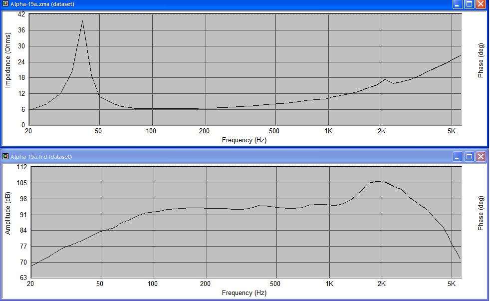

Originally posted by josephpo

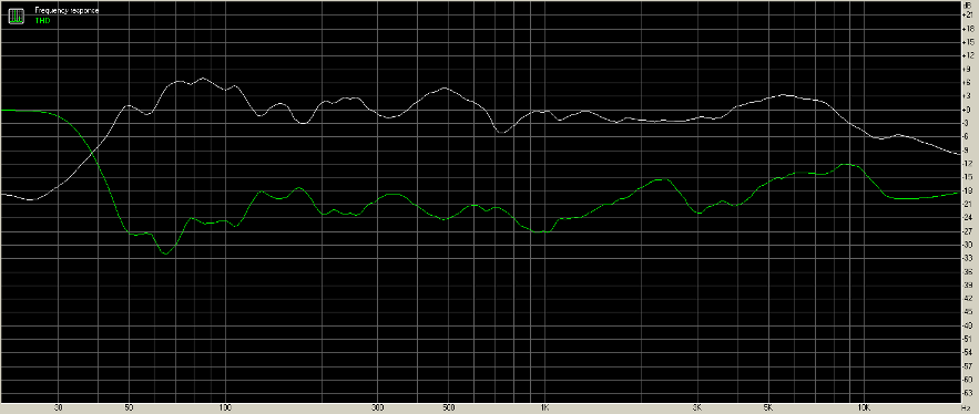

The crossover is based on manufacturer's data adjusted for baffle response using edge and floor reflection from the MJK paper. For this I used FRD consortium's spreadsheet and adjusted each driver's response and calculate phase information. Speaker workshop was used to do the crossover simulation.
I realise that the combined response can be futher smoothed especially the open baffle reversal just after 500 Hz. I don't really want to start tweaking on a simulated crossover, adding complexity to the network. I'll leave this for when I've got actual measurements taken...
I have attached the open baffle effect from edge for interest sake.
It is good to use baffle placement simulations to optimise driver placement and check floor bounce, etc. But your crossover design is best derived from the measured acoustic response and impedance (of course, after having done aforementioned optimisations).

Originally posted by josephpo Good idea, I'll play around with a notch and see if it can smooth things a bit at the top.
Another option would be to change the mid/high crossover to a Butterworth or try to get to a 3'rd or 4' order LR crossover to get the mid to roll off quicker. The dip is measured 85 db (5.2 KHZ) while the peak is at 87.76. db (8.2 KHZ), this is within my +- 2 db goal.
The problem is that such peaks are usually indicators of cone breakup or other resonance. Leave them untreated and you might end up with a bright or honky sound, even though the summed response might look smooth. If you have not experienced this before, I'd recommend that you do a before/after comparison for tamed/untamed treatment. There's no substitute for actually hearing the effect.

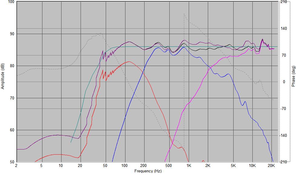

Attached a revised chart with the notch filter added to tame the mid's peak. The new combined output (black line) is compared with the previous crossover (purple line).
Since it's just an addition of a notch filter it's worth a listening test. It does seem to change the mid's character a bit bringing it down a 2 db's from 0.8KHz to 3KHz. I think this will suit the overall design better though.

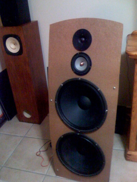

Ok, here she is, old faithfull prototype. My wife's been very patient but understandably would like me to get rid of her 🙂
Thinking of bending the plywood at the base to form the base. It will create a curved single baffle using the Jamo shape.
My room is L shaped open plan with speakers in the dead end, 4.5 m wide and 10 m long, couch position 3 m in front of speakers.

Looks great. Is the panel really curved or is it lens distortion? If curved how did you do it ?
Glad if you can share us the xo too.... I've always liked active as it is easier (and cheaper if the amp is already owned) but curious if the passive xo is simple enough.
How is the bass is is deep enough ? 😎
The baffle is slightly bend, it is only a single 6mm mdf sheet strugling to carry the weight of all the drivers - no fancy construction technique 🙂. This instability does reflect in the measurements, also the tweeter is pointing about 30 deg off axis.

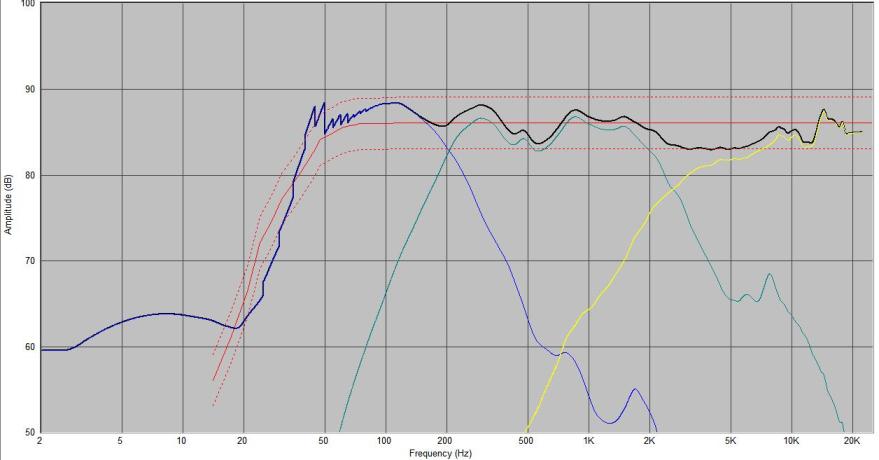

Attached measurement taken at 2 1/2 m distance at 1 m height.

The components you chose are all of very good quality, however they are not very effcient, to get 88db at the same time driving the overall speakers using one amplifier is some thing which I don't agree.
Currently I am building something similar to your configuration, tweeter, midrange and twin woofer. The components I pick are:

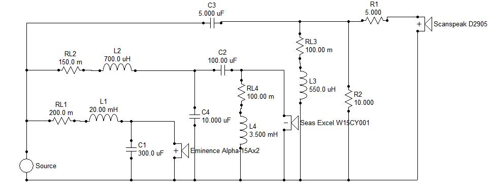

Output goal is 86 db, this is mostly limited by the SEAS excel driver with stated sensitivity at 85.5 db.
I do plan to play with active setup at some point but figured it would be interesting to compare with a passive design. I'll live with the passive crossover for a while before doing this.

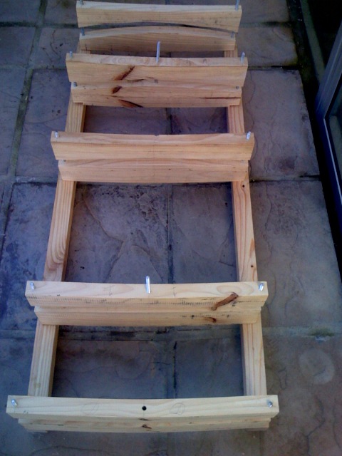

Here's the jig that will bend the baffle into shape whilst the glue dries. Learned the hard way that the ply direction is important. If use 3 ply, make sure that it is cut with single ply horizontal. This makes it easier to bend! Going to try again this weekend.
Here's parts list from Madisound. Still contemplating replacing C3 with a Mundorf Supreme cap!
Low
C1 300 uF Bennic 280 mfd Electrolytic
L1 20 mH Sledgehammer 20.0mH 15AWG Steel Laminate
Mid
L2 0.7 mH Sidewinder 0.7mH 16AWG
C2 100 uF 100 mfd Solen Fast Cap 400V
C4 10 uF 10ìF PX Range Polypropylene Capacitors
L4 3.5 mH Sidewinder 3.5mH 16AWG
High
C3 5 uF 4.7ìF SA Range Polypropylene Capacitors
L3 0.55 mH Sidewinder 0.5mH 16AWG

Interesting jig; looks promising! You say that you are going to use ten layers of 4mm ply? How are you planning on bending and joining them all? My first thought is to glue two boards together in the jig at once. Hopefully the dried baffle will then be rigid in the final shape. Then if you glue copies of the same shape together, maybe in the jig under light pressure. Or is the jig strong enough to bend ten layers of ply at once? I'm guessing that might be tricky, taking into account having glue in there as well and getting all the layers to line up while bringing up to tension.
Have you thought about using a non-hardening adhesive between the panels - the so called constrained layer damping approach? Of course this might well add extra problems to shaping the baffle!
I take it your plywood is void-free as well? Apparently quite a lot isn't void free, and if there are loose knots and things rattling around in the inner plies, that can be very annoying! If you're going to so much trouble with your baffle it might be worth using top grade wood.
Have you considered finishing off the baffle edges with some half-rounds of hardwood? Then it wont look like the baffle's plywood either.

The key to bending the 10 ply's together is to cut the ply so that the strong side is vertical with the weak side horizontal. Since it is only 3 ply only a single layer would be against the grain in the horisontal plane. This makes bending much easier, almost like wiggly wood. It should be strong enough to hold all 10 layers together, if not, your suggestion sounds good!
The jig would have probably worked better with mdf, but I don't like mdf from a wood working view.
The key to the jig is symmetry and identical curves, otherwise the end result won't look right.
I'm planning to route the edges smooth and then use some sort of filler to smooth the rough edges. Finally a glossy piano black finish. My friend is planning to make his Ferrari Red. Did I mention we're building 2 pairs! Thats 8 X 15" Alphas in my garage!
If the jig does not give good result plan B is to use square baffle from with classy veneer finish. Much easier and less time consuming.
