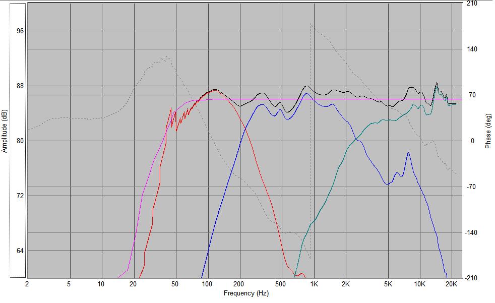

I managed to make good use of the holidays and have finished a crossover that might just work. I based the modeling on MJK's article and adjusted for baffle response and floor reflection. Attached is a picture of the combined response with crossover at 222 and 2450. The mid/high crossover is a 2 order LR alignment but the low/mid can't really be described as either LR or Butterworth, it's also probable more of a 3 order crossover. I have some concern with the impendance peak of the two Eminence Alpha woofers at Fs 41 Hz and how this will affect the crossover, time will tell if this will be a problem. Overall effeciency is 86 db within +- 2 from the goal function. The graph legend is
black - combined output
red - two Eminence woofers
blue - Seas mid
green - Scanspeak tweeter
pink - goal
Next step is to build the crossover and take the actual measurements.

I would recommend that you tame the mid's 8kHz peak with a notch filter. If you used the drivers' actual impedance data, you need not worry about the woofers' impedance peak (unless the inductors have significant series resistance).
Is that a SpeakerWorkshop plot? Did you do acoustic measurements?

Hi Shaun,
The crossover is based on manufacturer's data adjusted for baffle response using edge and floor reflection from the MJK paper. For this I used FRD consortium's spreadsheet and adjusted each driver's response and calculate phase information. Speaker workshop was used to do the crossover simulation.
I realise that the combined response can be futher smoothed especially the open baffle reversal just after 500 Hz. I don't really want to start tweaking on a simulated crossover, adding complexity to the network. I'll leave this for when I've got actual measurements taken...

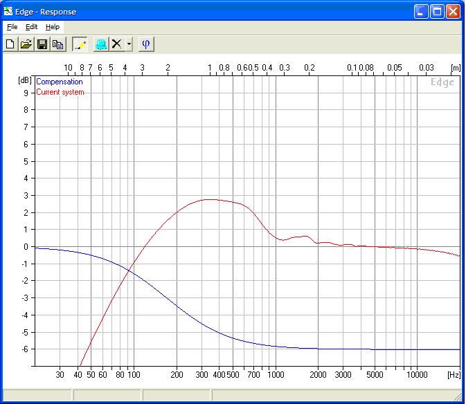

I have attached the open baffle effect from edge for interest sake.

Hi Shaun,
Good idea, I'll play around with a notch and see if it can smooth things a bit at the top.
Another option would be to change the mid/high crossover to a Butterworth or try to get to a 3'rd or 4' order LR crossover to get the mid to roll off quicker. The dip is measured 85 db (5.2 KHZ) while the peak is at 87.76. db (8.2 KHZ), this is within my +- 2 db goal.
