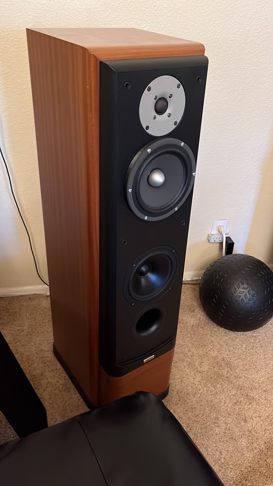

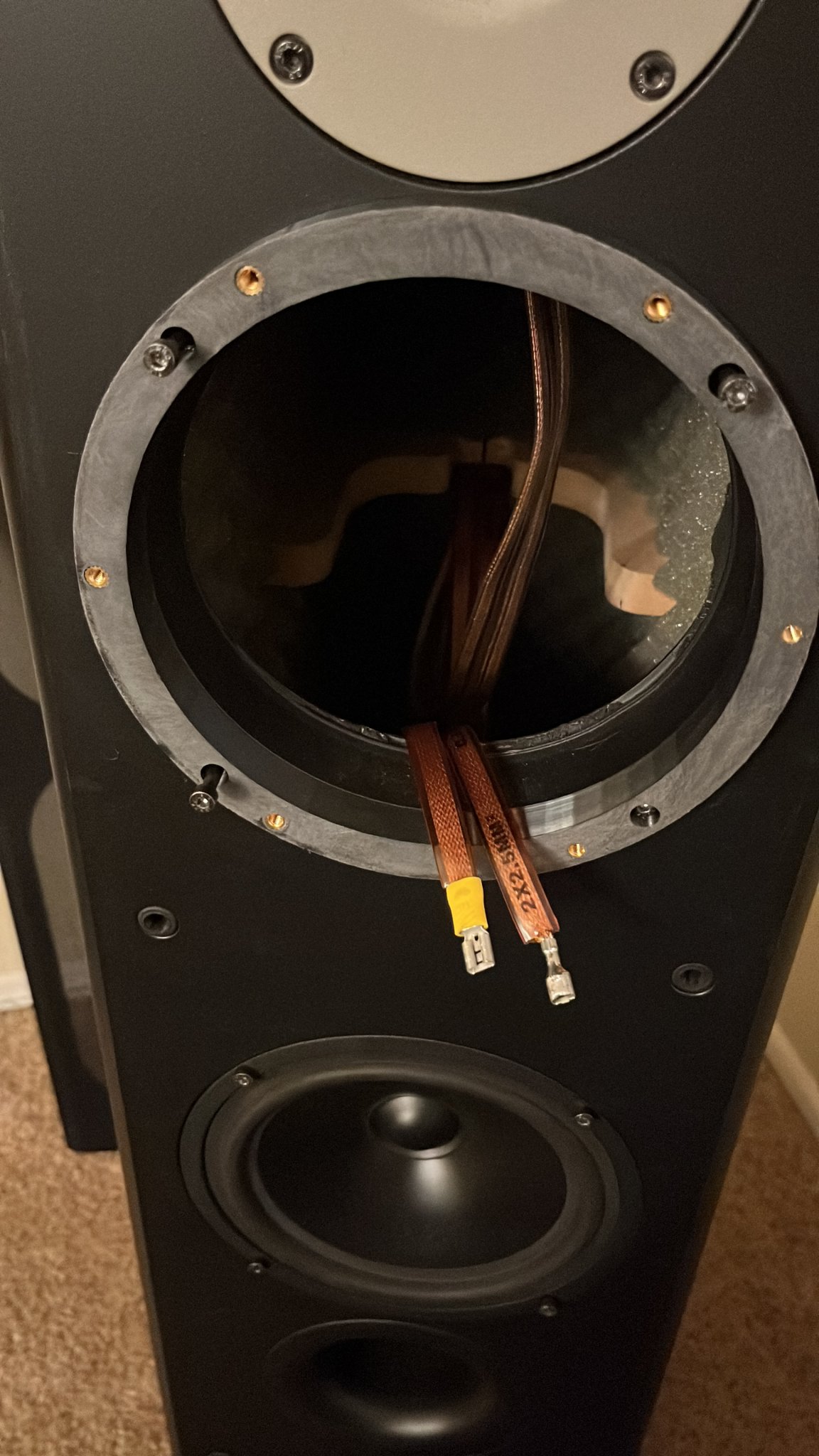

Hello all, first post. I just picked up a set of Concert 11s for 500$ with cheapo Vifa replacement drivers for the corroded/shattered Mag woofers. Actually sounded pretty good, and for what I paid phenomenal, but I wanted to know what they were really supposed to sound like with the SEAS Excel midrange drivers. So I designed some adapter flanges for the new generation 6-hole pattern at 176mm diameter. I opted for the W18NX001 version of the excel driver with the paper cones instead of the W18EX001 Mag cone because I’m not keen on expensive speaker drivers that shatter after 5-10 years of use. Here’s some pictures of them installed. The adapter sits 10mm proud of the face of the speaker, and the grills don’t fit anymore, but holy hell, these are the best sounding towers I have ever heard. Feel free to flame me if you think they are ugly, I’ll be busy listening to some live concert recordings. 🤘🤘

Cheers Mike, I didn’t have the heart to modify the cabinet. Also, I don’t know what material they used for that black portion of the cabinet, and whether or not it would play nice with a router bit, or shatter from vibration. I would like to get some measuring equipment, because while the W18NX is pretty damn close on the spec sheet to the original W17E, I have no way of knowing what woofers to use for the low end of I want to upgrade them in the future. The only thing I know about them is that they have 10-ohm printed on the magnet, and the magnet seems way too small/light for a proper high excursion woofer intended to be a dedicated low end driver in a 3-way tower. I see that SEAS has a nice looking(on paper) bass driver in the H1878-08 that would fit the cabinet using my 170mm to 176mm adapter flange, but there’s no way I’d get away with dropping that in there without needing to rework the crossover network. Not brave enough or experienced enough to take that project on today, but maybe in the future with the right equipment.
