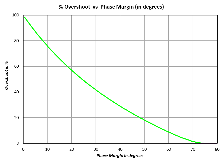

If the amplifier is well-approximated by a second order linear system, theoreticians have worked out LOTS of this_versus_that relationships. Google finds them but it takes more than 15 minutes (and less than 90 minutes). Here is a plot of one such relationship:
Overshoot of square wave response
versus
Phase Margin
You will notice that SOME overshoot is expected in MOST amplifiers.

Yeah, and it gives the perspective I didn't have. The overshoot in my picture is about 1/2 of 1%, which appears to be pretty minor.
(Funny enough, the chart also makes an accurate prediction with the CFA, which has a 69º phase margin. It doesn't do quite as well with the Hitachi topology which shows no overshoot but has a similar 68º phase margin.)

Nice graph. Hadn’t see that one before.
http://eas.uccs.edu/~cwang/ECE5955_F2015/PowerElectronics_f2015/ch9/Sect9-4-2.pdf
Oh, neat, and that one does indeed predict oscillation:
