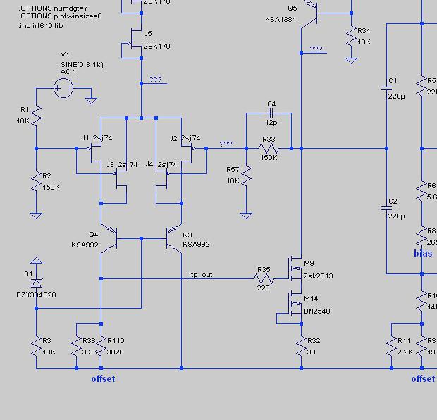

... In post 32 I would cascode the VAS mosfet....
Like so?
(I also tried it with another 2SK2013 biased with the LTP cascode's bias circuit. That showed slightly worse distortion.)
Jeff.
I'm not entirely sure what I'm trying to accomplish with the cascode (pointers appreciated), but here are the THD results I get at 120W:
No cascode 0.064
DN2540 below 0.063
DN2540 above 0.066
2SK2013 below 0.063
2SK2013 above 0.070
The two below are a (slight) improvement, while the two above measure worse than the baseline. But again, I'm not entirely sure what I'm looking for so maybe it's just not encoded in to the THD?
(They do have different sweet spots for the degeneration, which I didn't think to include in my previous reply which accounts for thinking the 2SK2013 was worse than the DN2540.)

Hi Jeff,
1) I would remove the active load M14 and cascode M9 with a bipolar transistor.
A simple resistor voltage divider to bias the cascode should suffice.
2) Remove the exrta pair of fets in the differential.
3) Use a bipolar current source for the differential (makes it easier to adjust the current). Much like the VAS.
4) Replace R36 with a trim pot for easy adjustment.
This should be a good start.

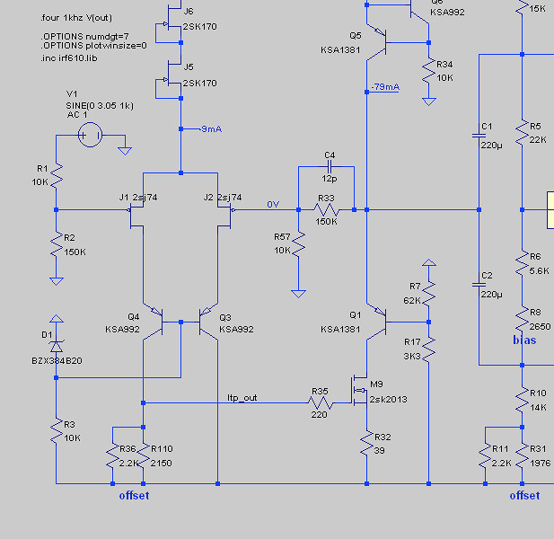

Another attempt below. I think I've got it right this time. (The resistor ladder turned out to be surprisingly finicky.)Hi Jeff,
Hey, I saw Nelson do it in the J2 so thought it must be a good idea. (Then again, I guess the J2 has no VAS...).2) Remove the exrta pair of fets in the differential.
I originally had it this way, but the bottom CCS transistor needs a heatsink whereas the JFETs share the dissipation.3) Use a bipolar current source for the differential (makes it easier to adjust the current). Much like the VAS.
R110 is the trimpot. I've just always shown them as resistors with a label in spice.
Borrow ZM's opto CC in the Bablefish J2 I linked earlier
That's for the output device CCS; Jam and I were discussing the LTP CCS. (Or were you suggesting using an optocoupler there?)
@RNMarsh, THD 0.0005% @ 1W, 0.08% @ 120W. Not built yet, so those are according to SPICE.
@2pico, no, I can't make it work. A fixed bias off the rail doesn't work because the VAS swings from more-or-less rail to rail. I've tried bootstrapping the bias off the VAS output, but it gets squirrelly. I might give it another go tomorrow....

In that case, just use a voltage source from ltspice, just the voltage symbol and attach to base of transistor, ground the other end and just keep changing values till it starts working correctly, once you know the voltage, then substitute in some circuitry to take the place of the ltspice voltage source.
It should be straight forward. You could post what you have, it might be a silly mistake, I make them all the time.
