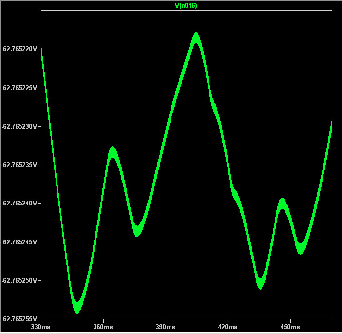

Yes indeed, it does oscillate. This is it approaching 180º:
Interestingly, it doesn't materially harm the performance. This is showing a 30uV delta-V reaction to a 3mA delta-I, so it's still within the 10mOhm spec. And once it gets to 180º and runaway gain, all it does is hammer the signal dead flat.
But is this generating a ton of heat in the pass device?
While ugly pictorially, the oscillation frequency is around 20KHz. Since the device is expected to operate at that frequency anyway, it doesn't seem like that should generate excess heat.

Do the phase margin and gain margin simulations suggest that oscillation is simply impossible?
Or, traversing the path in the opposite direction,
Does the observed oscillation suggest that the phase margin and gain margin simulated results are simply mistaken?

I'm injecting my AC into the base of the feedback transistor in the LTP. Measuring the output gives me stellar margins.
However, if I probe the output of the LTP I get a hump which goes above unity gain (around 25KHz), and the phase is over 180º there.
First off, are those reasonable strategies for testing the stability?
Next, the ugly wave forms I observed in the transient analysis only appear around 11KHz (and it's a very narrow window, disappearing at 10.98KHz and 11.05KHz). That raises a suspicious eyebrow, but I'm also suspicious regarding whether or not I know when to be suspicious. 😉
