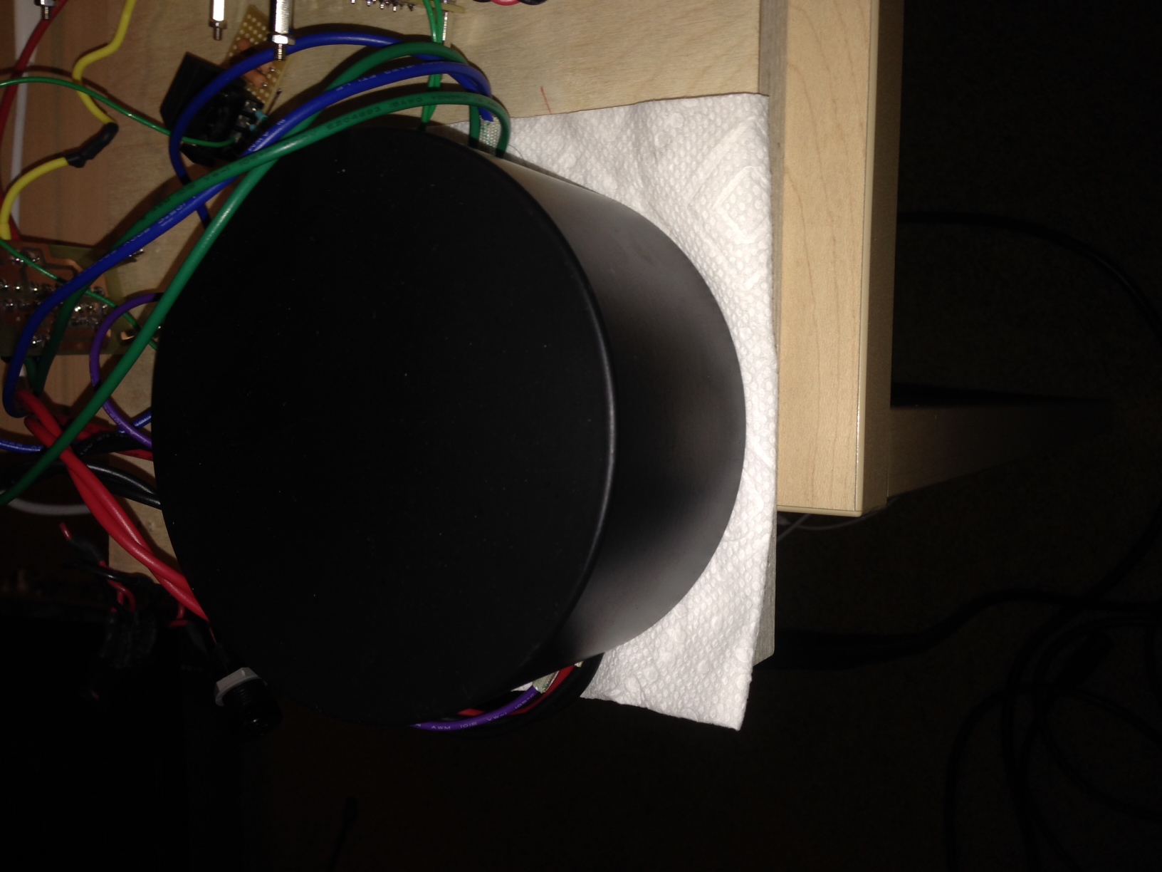

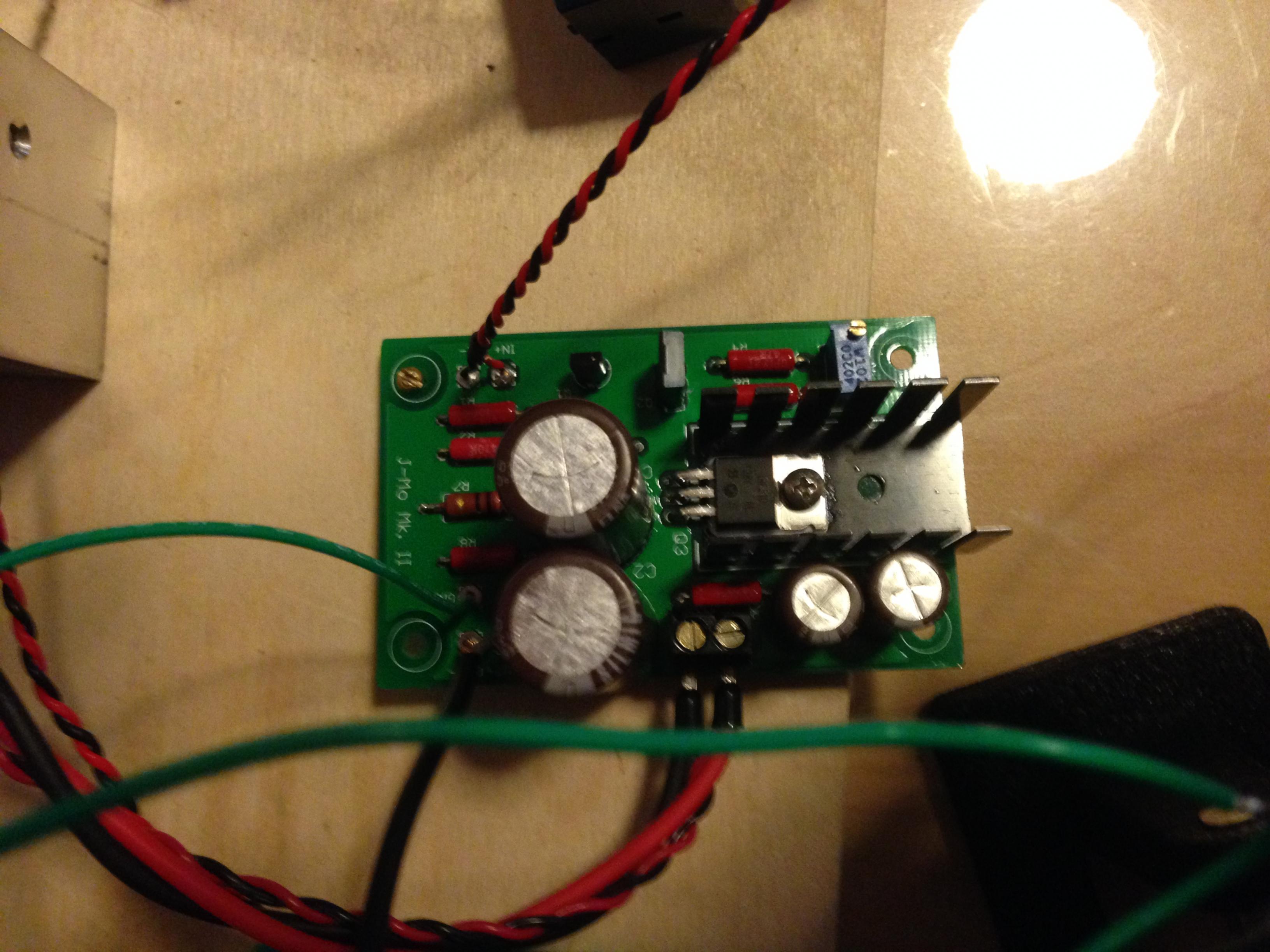

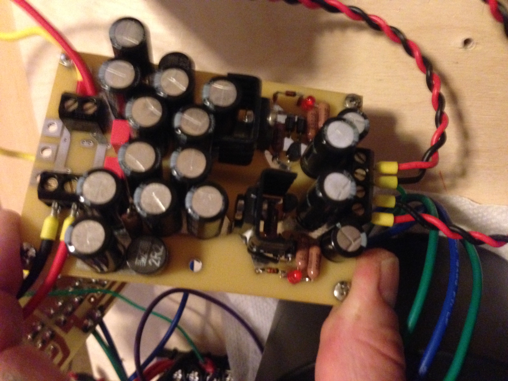

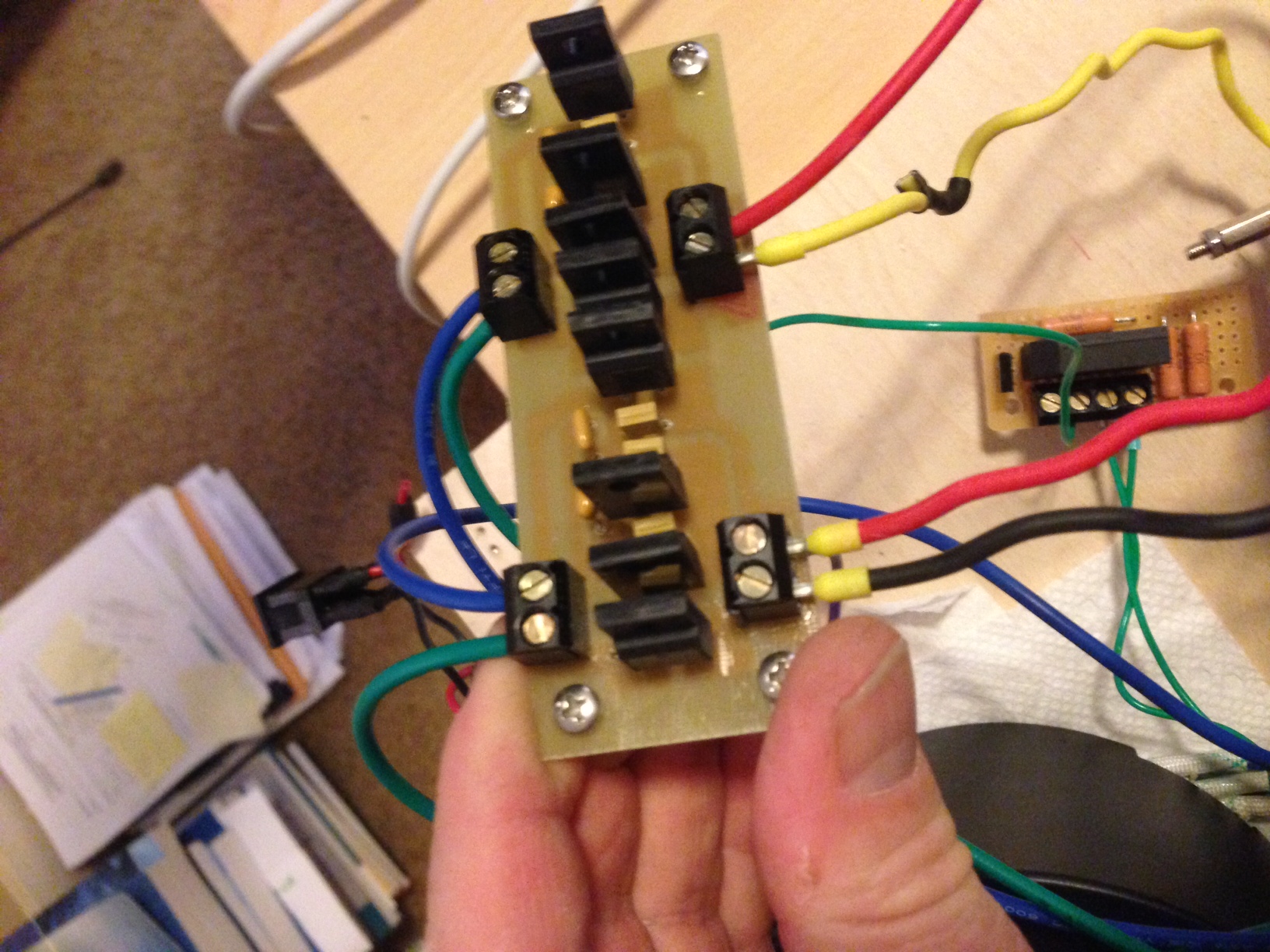

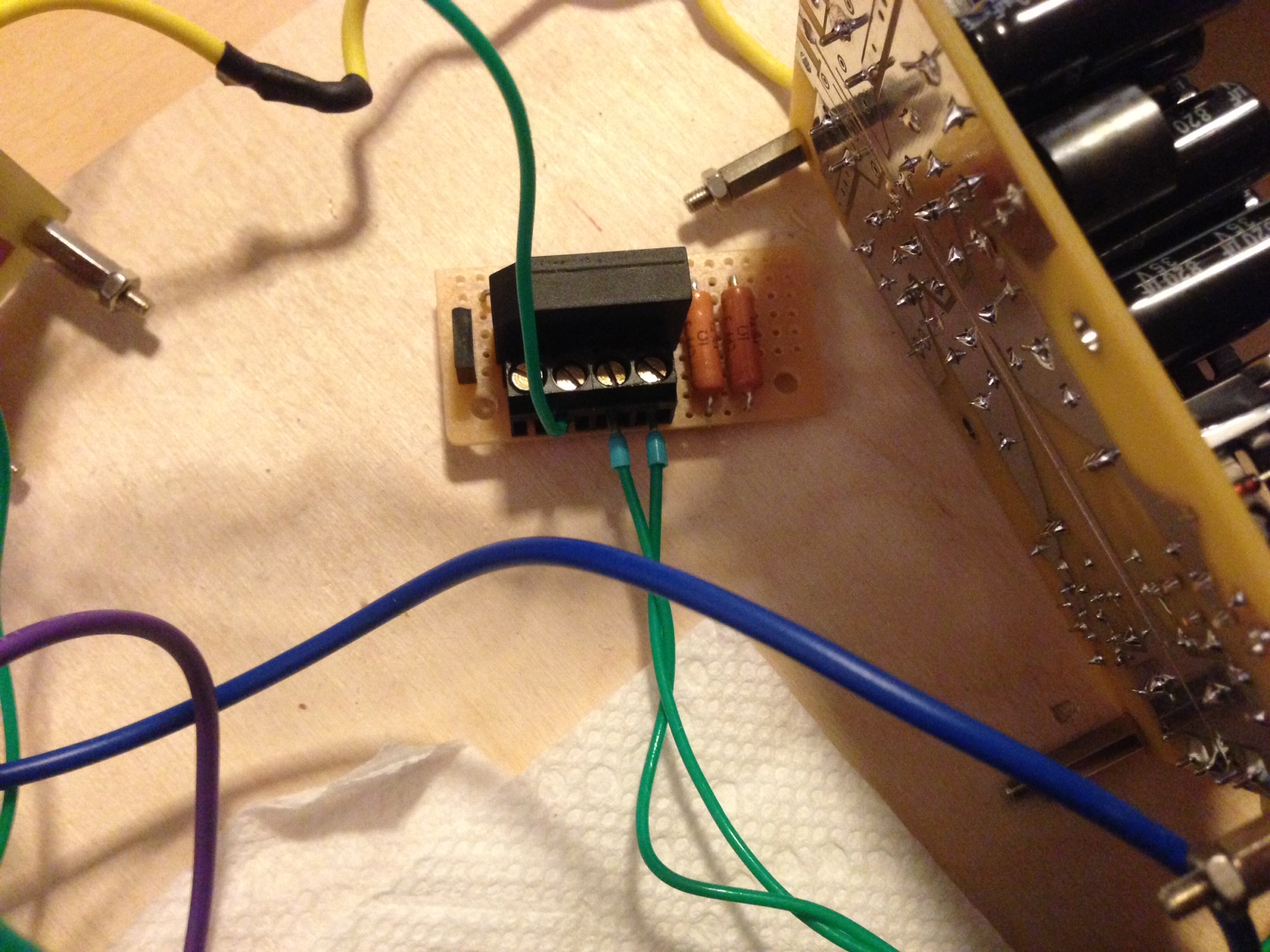

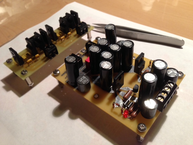

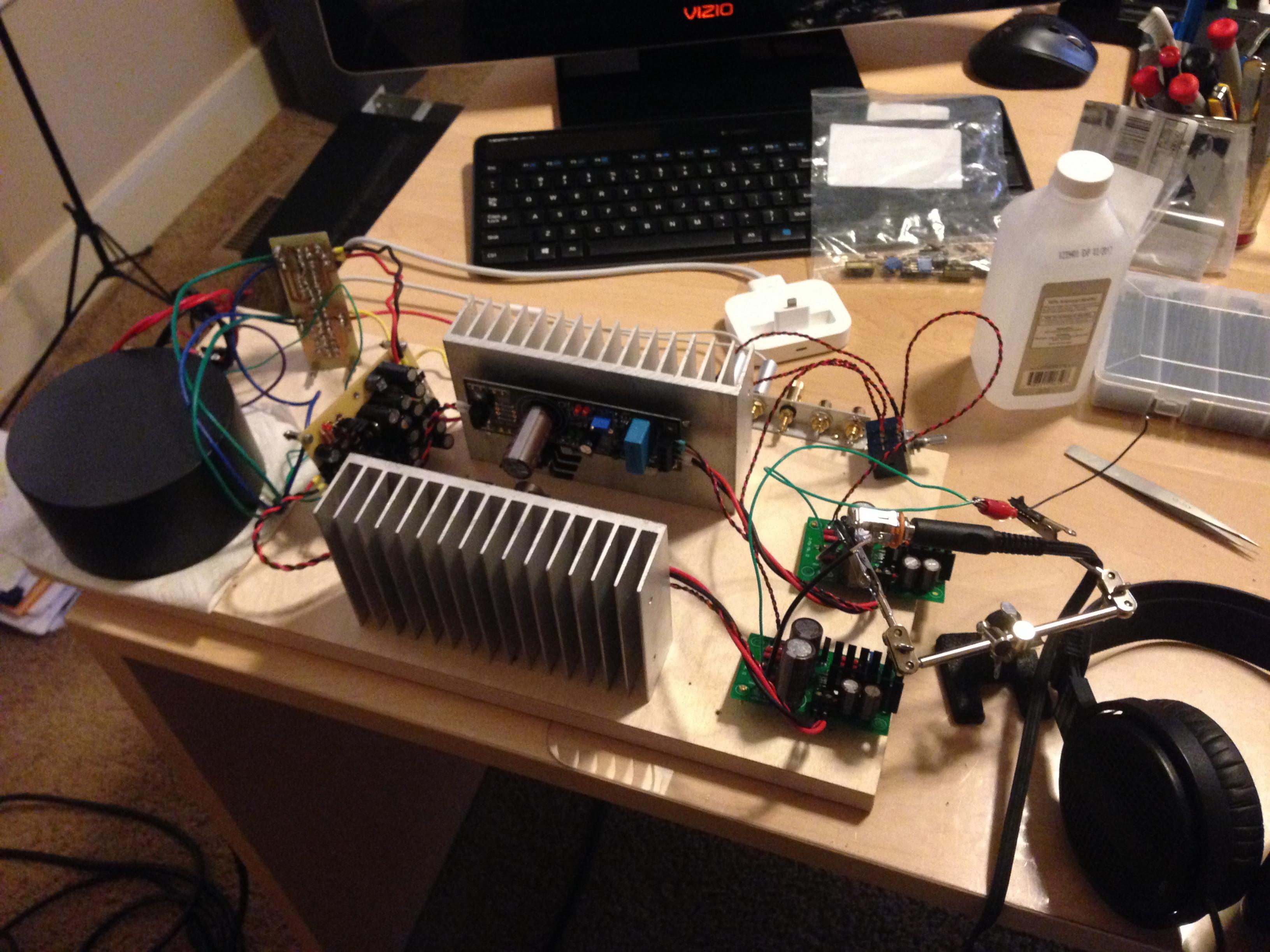

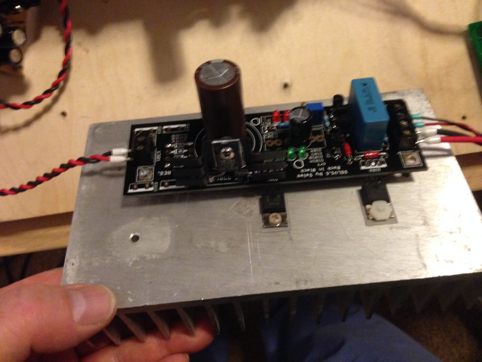

I'm done with my J-Mo Mk II headphone amplifier.
Excellent results even with my old and not top-line MB Quart Q-45 headphones!
I use external rectifier, CLRC board with K-Multi with about 2V drop and it is feeding 2 Salas BIBs for each channel. Very clean power!

I'm changing Salas BIB setting for 400mA (originally is set to 300mA). My both MOSFETs are at room temperature and I use almost everything from it. Now, I hope, I'll have a room for spare current. Salas told me that I might have some objective performance increase by dripping output impedance by several mOhms. I'll report my outcome soon.
Did not notice a big increase in performance with more than 300mA, but I did notice a substantial increase in detail using more raw voltage feeding the shunts.
For 15V output of the shunts I suggest feeding them 25v rawDC just to have 10V differential in out.
I'm performing two more changes for PSU for my J-Mo MkII amp. I already added 2200uF Panasonic FR cups to KM's input, just in case, and I'm changing toroid to 20V secondary vs. 18V which I used till now. So my new delta on Salas BIB Vin vs. Vout will be 10V. I have 6V now. I'll report soon.

Here is my setup:
1. I use Antek 20V AS-1220 toroid (100VA 2x20V).
2. Then, I have rectifier. I made PCB with rectifiers and snubers (F06U20S diodes).

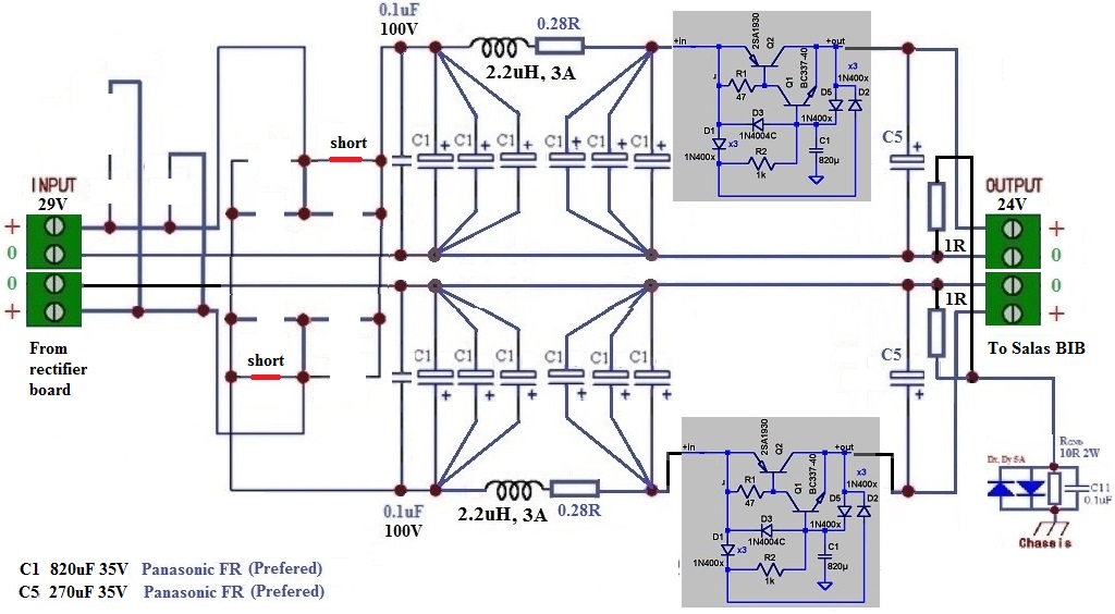

3. Then raw DC board with KMs. Please see attached schematics. The only difference between schematic and my setup... I added one more 2200uF C to input for each channel. KMs are clasic once from Keantoken site: The K Multiplier
3. Then, I have Salas BIBs set for 356mA current and 16V out.
4. Then, I have headphone amps. I used Elna RFS Silmic electrolytic caps and PRP 0.5W 1% resistors. Only R7 is Vishay CFP 33R 1% 3W. Also, trimmers are exchanged for 3296 Bourns.
5. Source: NAD M5 CD player.
6. Headphones: MB Quart Q45 (I'll get new pair soon. I'm going for AKG K701).
7. Connector: Neutrik #568-NRJ6HM-1-AU

It is very nice layout, but it is hard to use boutique or flagship (Nichicon Muse KZ or Elna RFS Silmic) capacitors with 5 mm and 7.5 mm leg-spreads. It would be a nice to add such capability. Soldering is not easy and need to heat pads a bit longer then usual. I think it is related to nice-huge GND plain (but it is heat consumer), but also gold plating might help to create tighter eutectic connections.

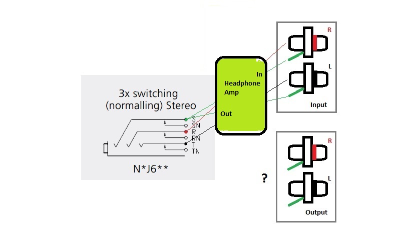

Question:
How to make connection to the source if I would like to set it constantly in-between CD player and Pre-amp. Also, I need to switch its Pre-amp output when headphone is plugged in?
