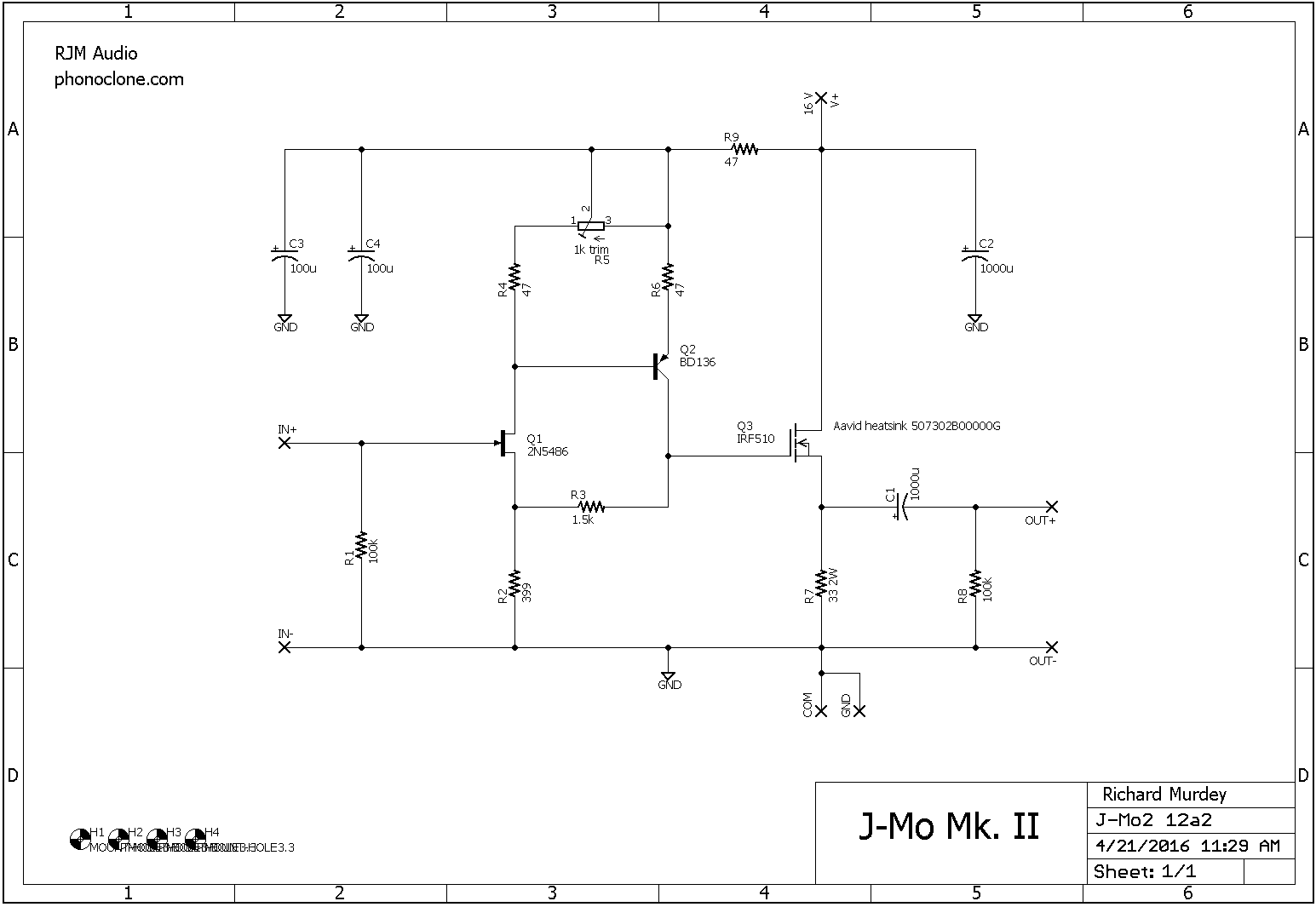

hi sorry i only access to tablet while travelling. circuit draw difficult. very same as the one on your website anyways. mine run with salas bib shunt (x2)
i add snubber to output of shunt, big improvement in hf.
ferrite bead to mosfet gate + 500ohm on output (moosefet preamp inspired), slight improvement in hf
add inductor+ zobel at output, another slight improvement
everything measured with ear only.
surprised psu change most evident because salas shunt already best.
maybe i add 10ohm at the output of shunt.
sounds even more fantastic than before, but mosfet 'glare' still there.

I have finished my JMO-MK II build recently.
It sounds really great. Thank you Richard for the good and interesting project.
Although I am having a bit of background hum noise when connecting it to the Phone or Ipad.
While when using my DAC, either battery powered DDDAC TDA or line powered PS Audio Digital Link II I can not hear the hum.
Will need to investigate it further. Generally the hum can be going from transformer. I have tried to moved signal wires closer and further and it reduces the hum when they are further.
On the other hand it looks like it could be coming from a power strip or lack of grounding in the phone/ipad what do you think it could be.
My grounding is built from a headphone jack directly to the chassis and third pin of the power inlet.
I will upload a picture in a while.
Thanks for your thoughts in advance.

The 2N5486 comes in with a typical turn off voltage (V_gs0) of 3.5 V and beta of 0.9m [measured with R1 1.5k, R2 475]. This is a bit lower than the LTSpice values I based the circuit values on originally.
I'm changing the BOM, the resistor R2 is lowered from 470 ohms to 330 ohms.
No other adjustments are needed. In fact the value of R2 isn't all that critical, it can safely vary from about 150-400 ohms. The lower the resistance, the higher the circuit gain, but the change in gain is not especially wide, ranging from about 11 dB (400 ohms) to about 16 dB (150 ohms).

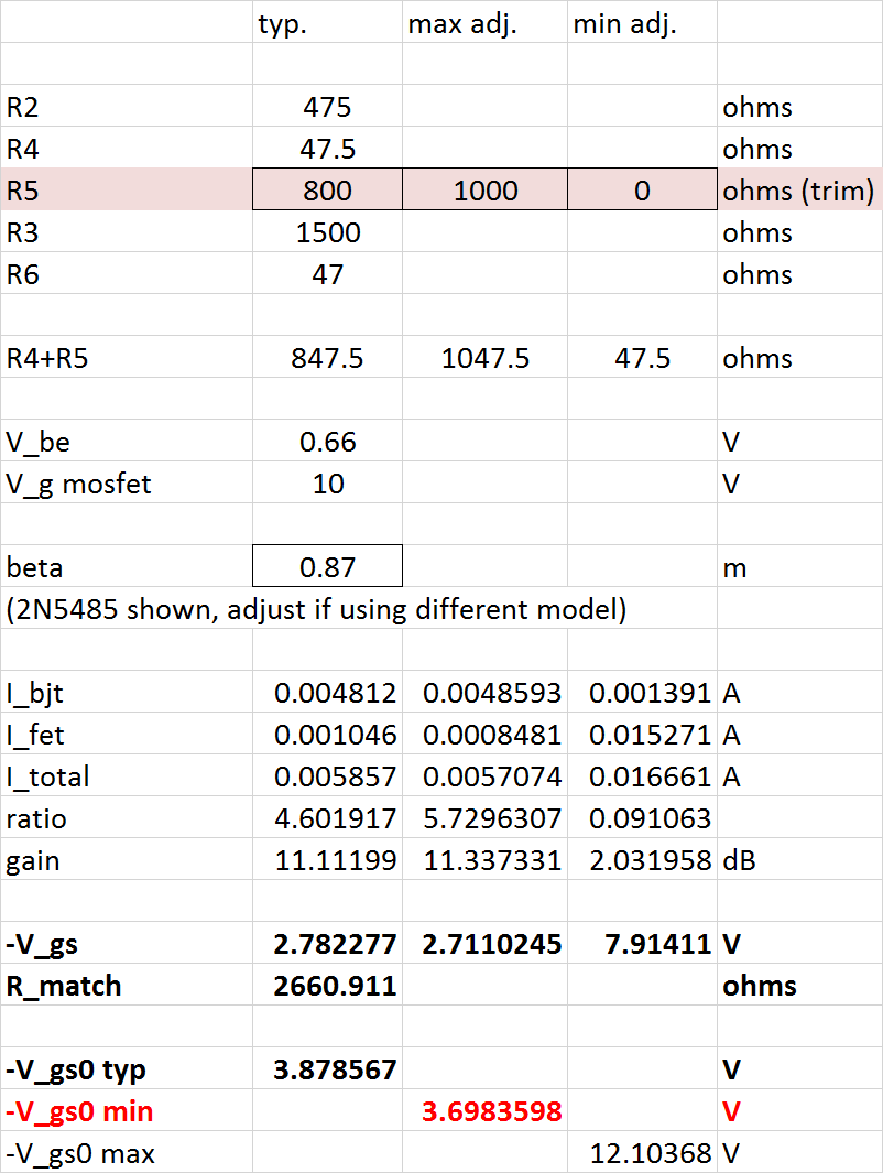

Not necessarily. It depends on the characteristics (pinch off voltage) of the individual jfet you happened to end up with.
With the power off, measure the resistance across the trim potentiometer, pin 1-3, as you have it set currently. If it is above 800 ohms, I recommend reducing R2.
Let me walk that back.
This circuit is a pain to work with, because all the variables like distortion, gain, and FET characteristics are interrelated.
Short story is the pinch-off voltage (V_gs0) of the JFET defines the optimal circuit gain you need to operate at the lowest possible distortion. It is slightly more than 10/V_gs0. The game runs like "The Price is Right" ... the closer you are to the target value the better, as long as you do not go over.
R2 = 475 is the "better" guess, but it is also the "riskier" guess. There is a higher chance that it is too big for the JFET. If you can adjust the mosfet bias to the proper range using the trim potentiometer, then fine, stay as you are. If you are building the circuit and are not sure what the V_gs0 values are of the JFETs you are using, you are safer using a smaller value.
If you do know V_gs0, or at least estimate it, you can set R2 to an optimal value initially, as
R2 = 1000 * V_gs0 / (10 - V_gs0) ohms.
-- Bob Barker reminds you "Help control the pet population. Have your pets spayed or neutered." --
That formula isn't so accurate.
Here's an excel worksheet that does it better, but I could only do it the reverse direction: input circuit values and output the appropriate V_gs0, so if you know the V_gs0 you have to play around with different values of R2 until you get the output value of V_gs0 close to the jfet you have.
Cut-to-the-chase,
R2 = 475 ohms, minimum V_gs0 3.7 V
R2 = 330 ohms, minimum V_gs0 3.0 V
About half of the 2N5486 I measured the other day appear to be too low to work at 475 ohms. The J-Mo II I built some while back worked fine though, so either I got lucky or maybe I'm overthinking this.
