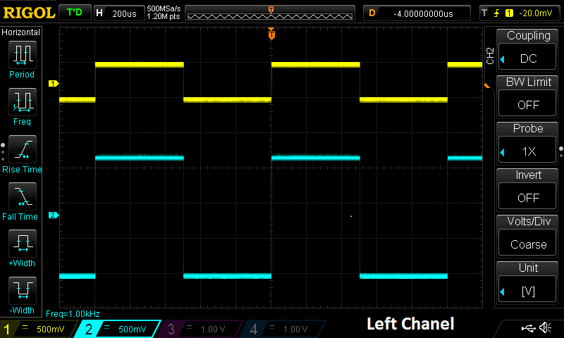

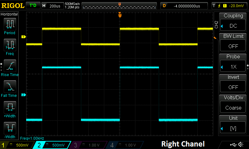

4 month of usage and I decided to check it. All voltages are fine and I did not adjust anything. I took square wave In and Out. Please see attached.

Normally you'd run 10 kHz and 100 Hz square waves to check for high and low frequency response, respectively. You are looking for a clean rise/fall with no overshoot. The 100 Hz response will not have a flat peak due to the AC output coupling - this is normal.
The square wave response is a diagnostic tool for troubleshooting a broken circuit or quickly checking that the circuit is working OK. Your square wave response just tells you what you already knew: your J-MoII is working fine.
Without a more sophisticated test and measurement setup, getting into a qualitative evaluation (of noise, distortion, frequency response and so forth) there isn't much more you can learn. I personally rely on simulations like LTSpice and my own ears for the operating point optimization vs. distortion, while using simple measurements to check against "unsimulatables/unhearables" like instability and noise coupling.
In addition to the square wave response (properly loaded), the FFT of the output (inputs shorted, no signal) is a quick and easy way to check your noise floor.

Not really, since there's a volume control between the input and the amplifier and anyway a square wave isn't representing any kind of standard input signal amplitude.
Adjust for 1 V peak output amplitude. And, if you want to be completist, check for 10 mV peak output amplitude also. This gives you the "large" and "small" signal response.
