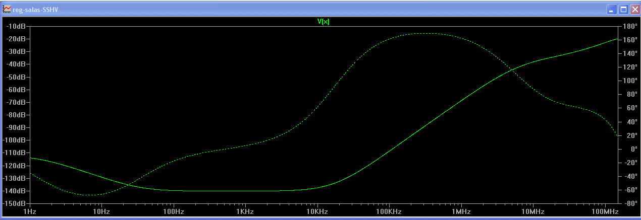

What are they opinions of Broskies IXCP + LT1085 HV regulated power supply? It is so simple but is the only reasonable power supply I have found with a low enough ripple to be appropriate for my application. The sound is a little too solid state-like in the bass department, but the background is dead black.

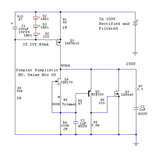

Is this ripple rejection acceptable to you? If yes, then you can try this one also. Its simple too. You can exchange its enhancement mode CCS with depletion mode Ixys or Supertex, and have even lower parts count. R1 scales the current by a 2.2V/R1 crude formula, the trimmer fixes needed Vout. Up to 300Vout with MJE350, more with -400V PNPs. 15-50V Vin-Vout difference is OK. Whatever current is not demanded by the load is constantly burned on the shunt NMOSFET. Allow +20% constant on top of your load's peak demand for that. Its reported as better than some series regs for tone and smoothness by enough builders.

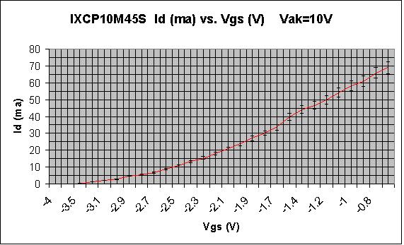

Recently i acquired a batch of IXCP10M45S from Mouser and decided to do couple of simple measurements:
1. Id vs Vgs for fixed Vak=10V. This measurement is supposed to duplicate the chart in the data sheet.

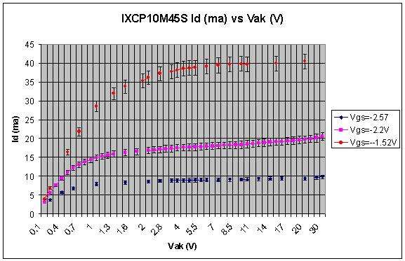

2. Id vs Vak at several fixed Vgs (characteristic curves).

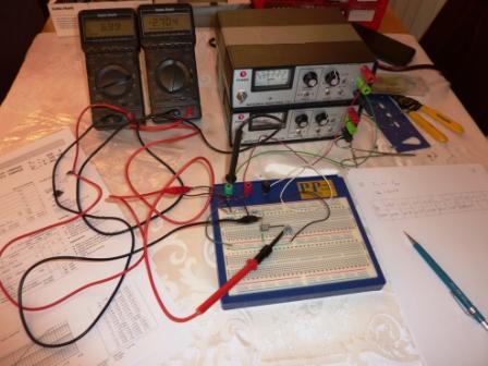

My experimental setup is shown in the attached photo. Really. there is nothing much in there, just the meters, regulated power supplies, paper and pencil (no computers or automatic data acquisition). Very much like good old times 🙂. One power supply is providing Vak and there is an ammeter to measure the Id. Another power supply is for Vgk.
1. I measured Id vs Vgs at Vak=10V. The result is shown on the attached chart.
2. I measured Id vs Vak at three fixed Vgs: -1.52, -2.2 and -2.58 V. The results are shown on the attached chart.
these results are obtained for ONE chip. however, I repeated the first experiment using another chip from the same batch and the results were the same.
I would estimate the experimental error conservatively around 5% which is also indicated with bars on data points.
Now the results:
1. Id vs Vgs differs significantly from that of provided by data sheet. For example, I measured Id=11ma at Vgs=-2.5, while data sheet chart shows 25ma. i guess this is not a big deal, because we adjust Id experimentally anyway.
2. Id vs. Vak (characteristic curves). I expected the saturation region to be much flatter if you consider Id=20ma curve, the slope (more precisely, the reciprocal) is around 6.5K, far cry from the stated 160kohm.
Also, the pinch off region is around 2-7V (depends on Id). This is important for the cascode operation (see below).

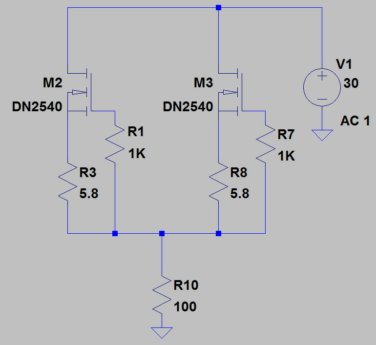

Have you tried DN2540 for CCS? What current are you running it at?
