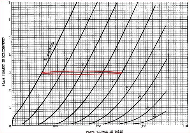

The driver tube still has to drive the Crss of the top MOSFEt in the cascode, which even if one assumes 5pf MOSFET + 5pf wiring and interelectrode is 10pF. I think it's questionable for a 12AX7 to drive this at 160VP-P but it does put it into the realm of possibility. Maybe with both sections in parallel?
10pF is a lot better than the 50pF or more that directly driving the 300B grid would give you, so I think one could get away with a much higher Rp driver than for example with choke loading.
Anyway here is an approximate load line for capacitive load of 10pF on both sections of a 12AY7 with a 40 KHz, 180V P-P sine wave (0.22 mA at 22V/uS) note the different place the load line crosses the -2V grid line in each direction (looks like slight slew-induced distortion).
