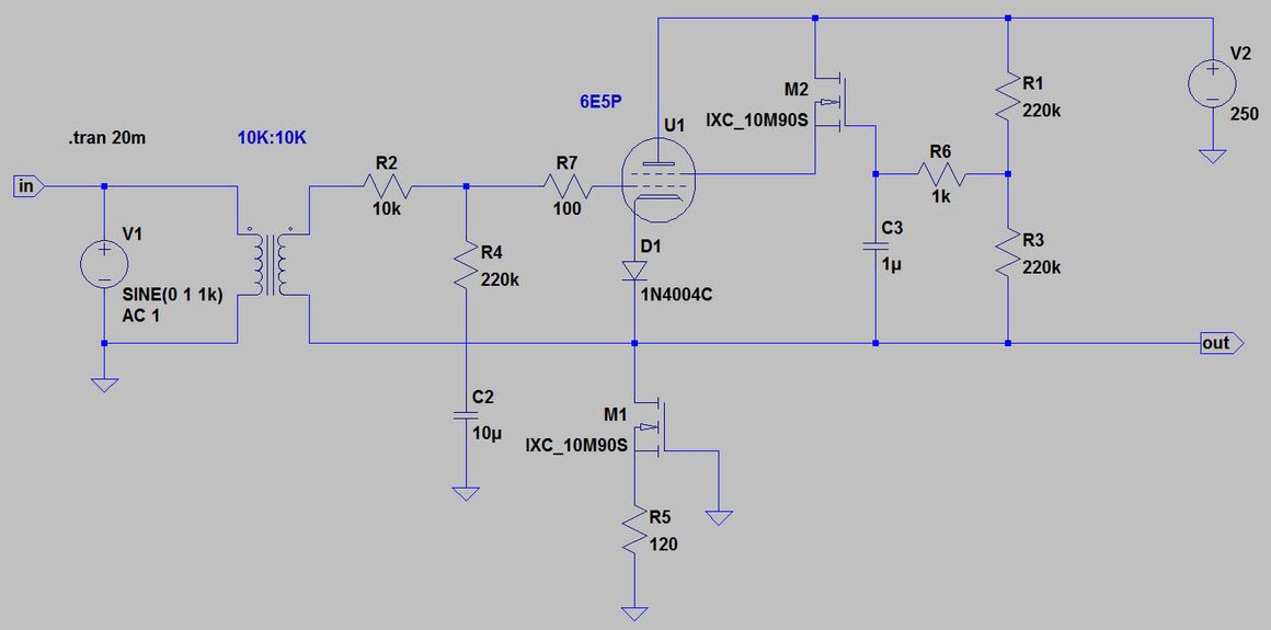

Unfortunately the attachment was scrubbed from the post and Morrison doesn't explain its operation. At first glance it looks like a regular pentode cathode follower with an active cathode load M1/R5 and screen regulation, except:
- the screen looks held at Vpk/2 instead of a constant screen/cathode V
- D1 in the cathode
- the 10k on the transformer secondary
Is the original schematic available? Maybe here?

I am still waiting for one to be built just as in the schematic that is in Post # 12 . . .
And then waiting for the test results.

It has no plate load and source is applied between grid and cathode. What provides the gain?
Cathode load replaces plate load. It is almost equivalent. This is only possible with transformer input - it is decoupled from the ground.

RDF,
Thanks. In an earlier post, I finally understood that there is gain in Post # 12 circuit.
However, that circuit makes the input transformer requirements more expensive than if the circuit was common cathode.
And common cathode can give the same gain as that more complex circuit.
The common cathode circuit will not reflect the amplified signal back to the transformer primary (well the miller effect capacitance can transfer a little signal back to the secondary).
But the floating secondary in Post #12 will reflect lots of signal back to the primary, and to the input signal (unless there is a grounded shield between primary and secondary).
That is because the whole secondary is moving up and down by the full amplitude of the amplifier's amplified output signal.
Reverse transfer of the amplified signal that will reflect to the input signal needs to be
considered, especially at high and maybe even mid frequencies.
I see no grounded shield between the primary and secondary.
None in Post # 12, and none in Post # 26.
