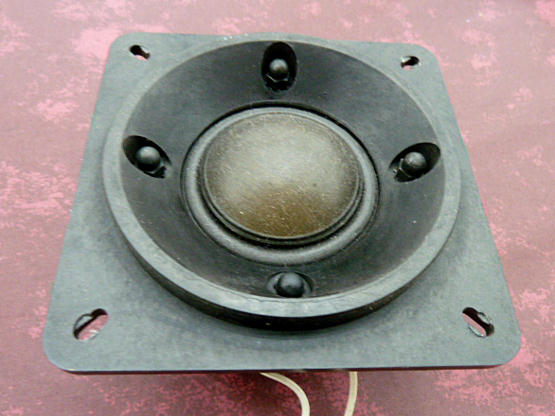

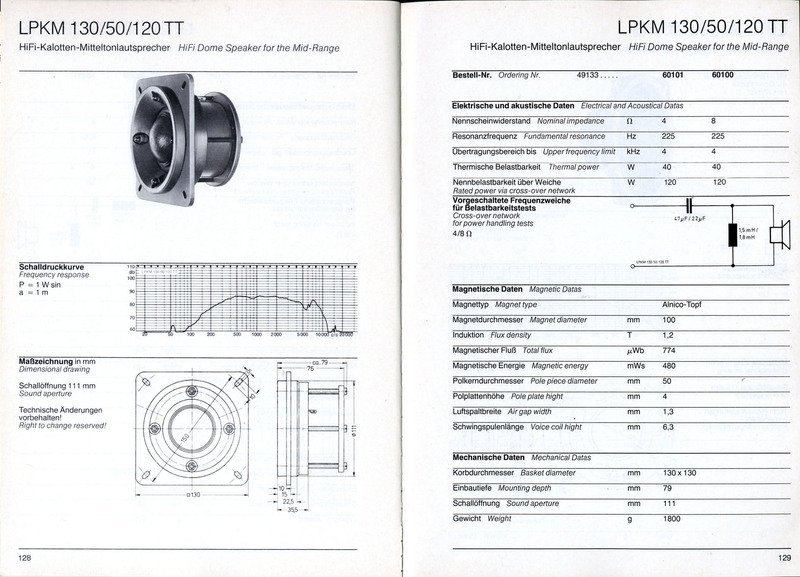

Hi ! i have a question on this topic
My drivers are marked on the back LPKM/105/37/120 FTR
I received few days ago a Dayton Audio DATS impedance meter
I immediately checked the domes and with a very sad surprised i have seen fs of about 1kHz on one and 1.5kHz on the other
Also the impedance module at fs is quite different
How is this possible ? do i have to stop buying vintage drivers ? can they degrade so much to be unusable ?
A mid with a fs=1kHz is not a mid It is just a fat big tweeter

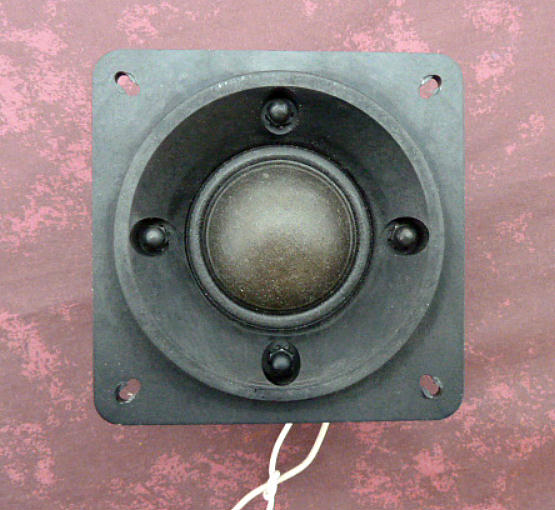

Hi and sorry I opened one out of curiosity and i managed to assemble it again and it measures the same as before Good
i do not understand why the coil leads are above the lens ,,, weird solution
I wonder if replacement diaphragms are available like for compression drivers
I am not sure that the high fs could be the result of the diaphragm aging But 913Hz seems way to high for a 2" dome midrange
And the other even more like 1.2kHz
could it be the magnets loosing power ?
suggestions ? to throw them in the bin ?
