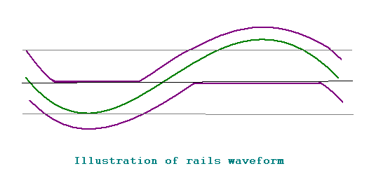

But, Mackie is regulating the supply (make it variable). May be there are no patents for this Mackie, at least we know that it could be used for subwoofer. Then by using this regulator it may be better for low ripple and only one power dissipating transistor (half transistor needed in dissipating power compared to normal amplifier).
Workhorse's ANFET is similar with that classG patent.

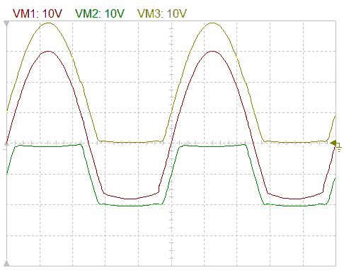

Here is the target waveform from the mixture.

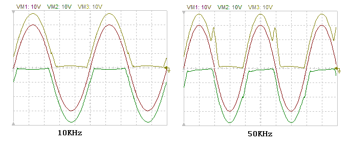

It finished, much easier than I imagine while seeing Mackie complex schematic.
Their schematic makes me feel that it will hard.

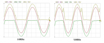

It is simpler, only 4 of DB's(2for switch, 2for regulator) and 3 of IRF's(2for switch,1for regulator). Work very fast 50KHz and more.
It is time to built it.
Thanks for all, special for workhorse and djk.
see you next time🙂
