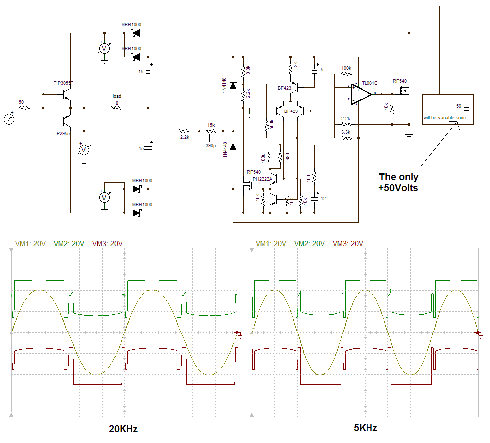

Its only need +50V for +/-45V outputs.
I have seen this kind in Mackie subwoofers it is good for their complex supply, it need only one supply for both +/-.

Its not complex IMHO,
Under normal conditions the +/-15VDC is keeping the bjt amplifier into quiescent conditions and for large swings the floating mono battery just swaps its position to required polarity in order to juice up more voltage with respect to ground via mosfet switches and schottky diodes combination.😀
To make it more interesting one can use grounded collector or emitter with floating rails to overcome the need for high voltage preamp/vas stage.

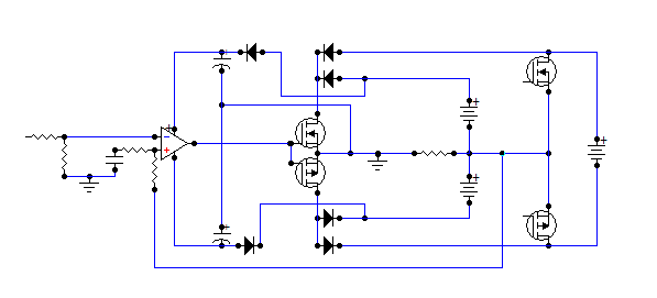

I think i can make a similar use of this topology in Mosfet grounded source configuration for Class-A on +/-20V and just one Floating High Voltage source to get more swing.
Yes, that also working, but all batteries are floating, Mackie is winner 😀 working in classB with tracking rail. Still,, your configuration is better than what I have think before, it is full bridge in my mind for single supply.

I think we only need the mono battery + low tier bipolar supply floating for each channel and kick this thing into something powerful.

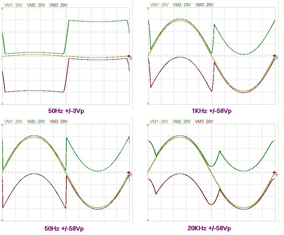

Hi, Workhorse, your idea are best, look this one, The WON!, Mackie aro no longer win😀.
This will start this way. and it doesn't need that bootstrap if gain only 4x or less. Also another supply could be added at series if needed 100V and more.
This THE WON😱

Yeah, it will work this way also..........😉
CE output stage gives you voltage gain also, so no more bootstrapping.😀
