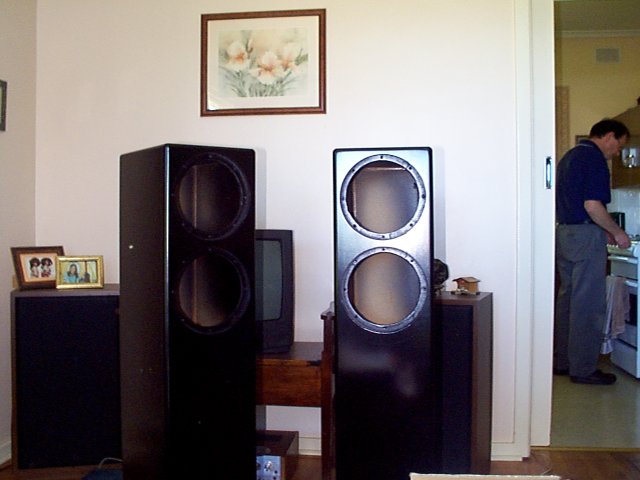

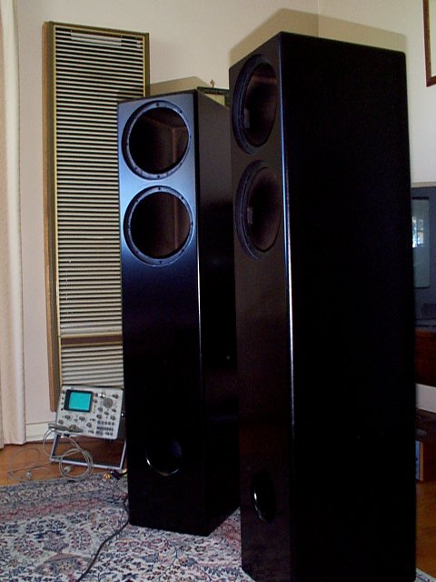

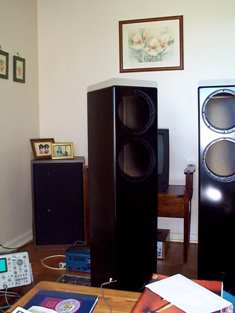

Bahh.. stuff it.. lol I'll worry aout it once I have painted the boxes.. 🙂 for now I'll just leave the piece of foam/sponge in each box.. lol I mean... it almost seems that the speakers sound WORSE now that the baffels are glued on... 🙄 they really need a midrange... 🙂

So..... do I need the tar based type dampening material? or do I need like fibreglass stuffing? 🙄 I have no idea what I am doing.. and I am running out of time![]()

Sorry about the tar dig 🙂 I have seen recommendations about using scraps of roofing ashphalt before, thougt I'd make a joke....... My existing speakers have some stuff from Jaycar (polyester mats). Circlotrons suggestion is a good one, I'm glad he said that cause I suggested spotlight to someone else even though I hadn't checked to see if they actually had the stuff. His comments about taking your mum, or looking helpless are spot on too, you will probably feel like your the only guy there (You could take your girlfriend too, if you've got one, but you may never get her to leave)........

Okay... I'm getting a bag of the stuff from spotlight or wherever... putting half in each box... with a piece of foam in each as well directly behind the drivers.... and... I am putting terminals on the back to I can connect the drivers in either parallel, series, to seperate channels of the amp, or only connect one driver... 🙂 OK!!! the boxes are at school now... 🙂
