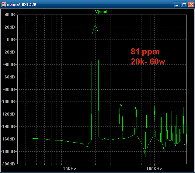

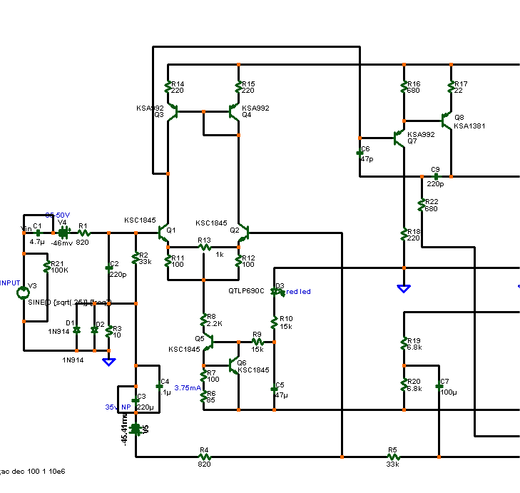

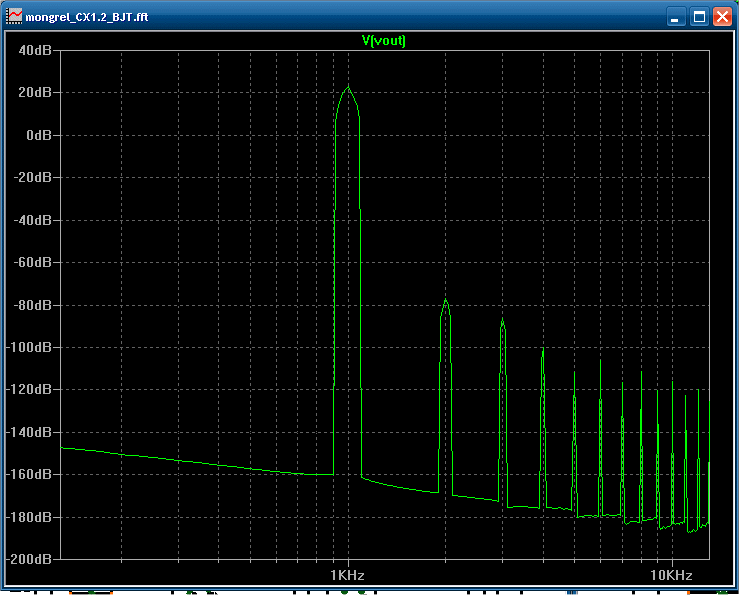

Yes , lots and lots of gain... with KSA/C's + beta enhancement = 100DB , and Nico RAS's inspired design BOTH a current mirror and a beta enhanced VAS (symasym style) = 135db+ (too much - especially with the Ksa1381). If you use the old MJE340/50's with one of these these "gain monsters" (pix1 - 105db) AND add a touch of "spice" (TMC), you get some real sound 🙂 - (pix2) The MJE's Higher Cob/lower beta actually makes some designs (especially the one in pix1 @ 80db- w/mje340) , sound better by moderating the loop gain.

You have been gone awhile ... your "patchwork" = "blame ES" = my BX. Your patchwork was a great inspiration for a great amp. On "steroids" (TMC + VAS beta enhancement ) , it can be a good PPM / near perfect amp. 🙂 I'd LOVE to have a couple 2SA1407's to plug into it.
Check dis' out ..(Below 1/2- no lie) Works and works GOOD...
