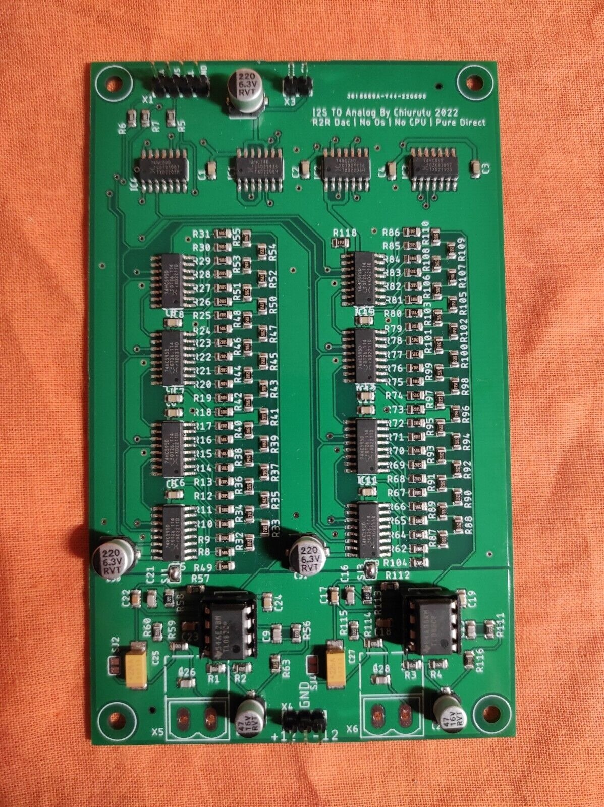

Has anyone tried this r2r dac from an Italian guy?
It uses only discrete logic - (74hc74 and 74hc595) so no cpld or dsp) and stops the clock after the data is transferred. It came with TL082 opamps which will be replaced with LME49720 or OPA2134.
The price is low enough for me to buy one but haven't tried it yet as I haven't finished assembling my LiPO4 power supply.
I2s source is from a standard DIR9001 spdif interface.
https://www.ebay.co.uk/itm/325231264279

The UK ebay description is in Italian so for others convenience Ive pasted an online translation below:
I2s to Analogue Ladder Converter Board PCB No CPU, No OS
- PCB board which makes I2S to stereo analogue output.
- A handful of TTL ports and an R2R ladder resistor network for the analogue output.
- Up to 24 bits are converted. At 16 bits the last 8 are zero, they do not work and are irrelevant.
- The two left and right channels are perfectly synchronized.
- Linearity is guaranteed by the resistors used with a tolerance of 0.1%.
- The integration section with classic OP Amp for a low pass to get 8vpp output.
- It comes with TL082 but you can mount any version you want, including discrete OP amps.
- The interface is totally in hardware there are no CPUs.
- It works in non-oversampling mode and accepts clock frequencies beyond the classic 44.1 Khz.
- 5V DC power supply for digital, +/- 12V DC for analogue.
- EUR 85.00

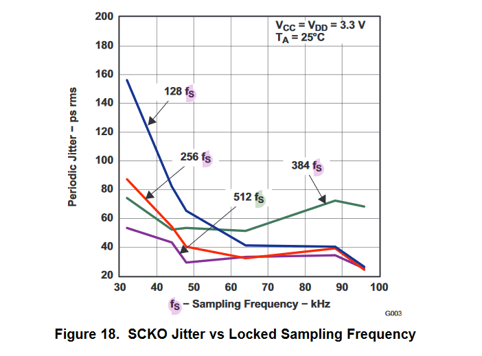

Can I ask about jitter control in your new R2R DAC tests? I assume the R2R board has no clocks sand runs off the I2S?
Will you be clocking the DAC just from the DIR9001? The DIR9001 datasheet cites low jitter at higher sample rates. It might be worth upsampling in software to 96kHz. Foobar has some good free plugins in you run Windoze.

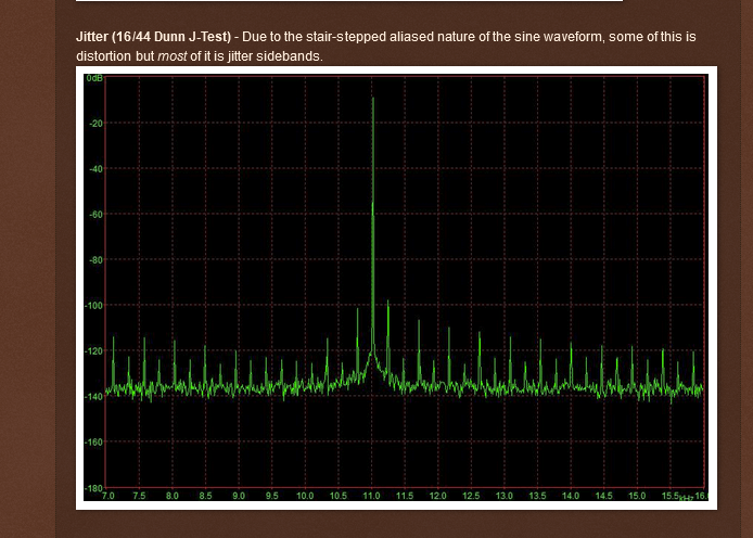

But a real world jitter test at 44.1 doesnt look so great
MEASUREMENTS: MUSE Mini TDA1543x4 NOS DAC
The DIR9001 digital receiver in this unit allows up to 24/96https://archimago.blogspot.com/2013/02/measurements-muse-mini-tda1543x4-nos.html
Do you have any other I2S sources with dedicated clocks?
Are there any equally affordable eBay USB-I2S boards to match your ebay R2R taht have XMOS and paired clocks with low jitter?
That 16/44 jitter test result does not look that bad as it is 16-bits so sidebands should be visible above -140dB.
Archimago himself wrote this:
"Looking at all those sidebands in the jitter plot, I'd estimate it to be >5ns; but yet it still sounds quite good! IMO, more evidence to say there's no point to quibble about the odd sidebands and whatever picosecond jitter found in well engineered gear..."

I'll be using it with 44.1 and 48kHz fs and the jitter is around a claimed 50ps so not worth trying something more sophisticated.Can I ask about jitter control in your new R2R DAC tests? I assume the R2R board has no clocks sand runs off the I2S?

It seems that the ladders uses a lot of current from the 5v supply so not possible to use the LT3042 or TL431. Need a 2a low noise supply - eg LM338 or discrete regulator.
