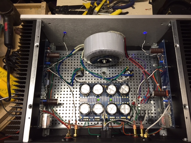

Amp is up and running and sounds great! Rearranged the layout as recommended. Replaced the 2 resistors that I hosed up. Am using it with some Dennis Murphy ER-18s, a Wadia 121 and a B1 Buffer. I took the buffer out of the rig and, while it sounds better with the Prima Luna PL4 amp, the F6 didn't seem to care. The speakers are not efficient (~88bd/watt at best) and are 4 ohms. Really smokes the PL in most every way. Biased the amp at 5.65v and it is heating to about 49 degrees at the heat sinks. May try to increase it just a bit.
Thanks for your help. Learned a lot and had fun.
Jeff

Nice layout, did you end up getting the 90º angle bracket for the transformer?
Regarding the heatsink temperature, make sure you check it when/if the weather gets really hot. A couple of days ago the outside temperatures reached 38C/100F. The temp in my room went up and my sinks were at 60.5C, they were at 54 when I first biased the amp one month ago. Still safe though and sounding great!
Made an mount out of a shelf bracket. Worked pretty well. Right now the amp is in the basement at ~68 degrees F. I will re-check bias and try to reduce the brightness of the LEDs with some sandpaper. I think I used 10K resisters. They are brighter than I would like.
I would use another resistor to decrease the brightness. Buy 2 or 3 values to see which one gives you the brightness you prefer.
