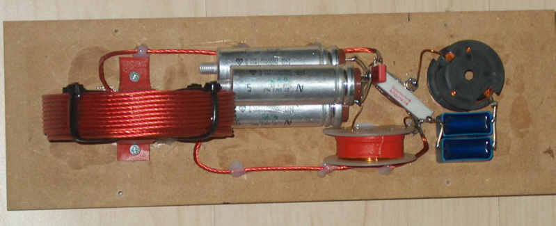

It is me
Just a photo of everything tested out

btw. if somebody is interested, the switch had some changes
meanwhile and is "Finished" for the 10xxx time 😉
