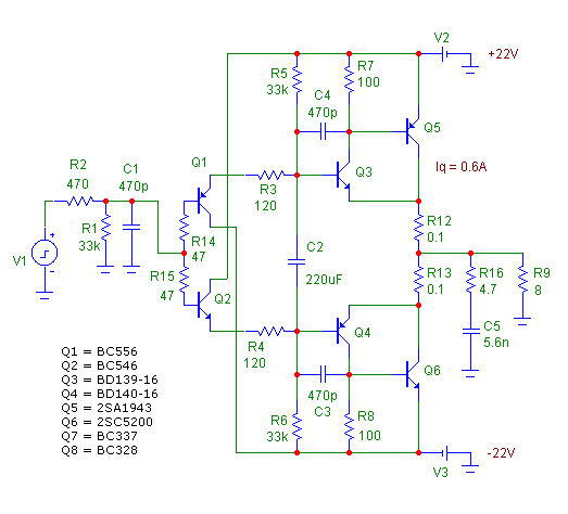

But, read the description again and think about the operation of this circuit at very low bias currents... much more interesting. I haven't decided if it really qualifies as proper class-A, just by keeping both output halves from turning off... current handling would be akin to class-AB, and that diode would conduct major current for half the cycle. It won't have a wonderful open loop output impedance. Seems to me the idea of preventing complete transistor switch-off in class-AB has been tried before, without much success, apparently. Maybe there's even prior art for this circuit? Anyway, I don't think I'd expect wonderful performance out of it (even at high bias). More simulations are called for to better characterize it's operation, but I'm not going to bother running them. 😀
yeah, that's what I thought initially too... still applying typical class-A bias levels in my head. In this case, the circuit would work something like the Aleph active current source.Depending on component values this circuit will work. I made a simulation and got reasonable result at iddle current of 1.5 Amps.
hifiZen,
I agree and I am also not going to spend more time with simulation of that circuit. I have got other interesting projects to do 🙂
Pavel

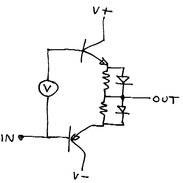

Here is an output stage with a similar effect. The bias is
set across the resistors just short of the diodes conducting,
and choosing your values correctly, you get a low idle
current but forward conduction over the operating curve.
This circuit was part of the 800A, 400A, and 4000 from
Threshold, and it helped keep the active bias circuit simple
by smoothing the bias transition curve.
