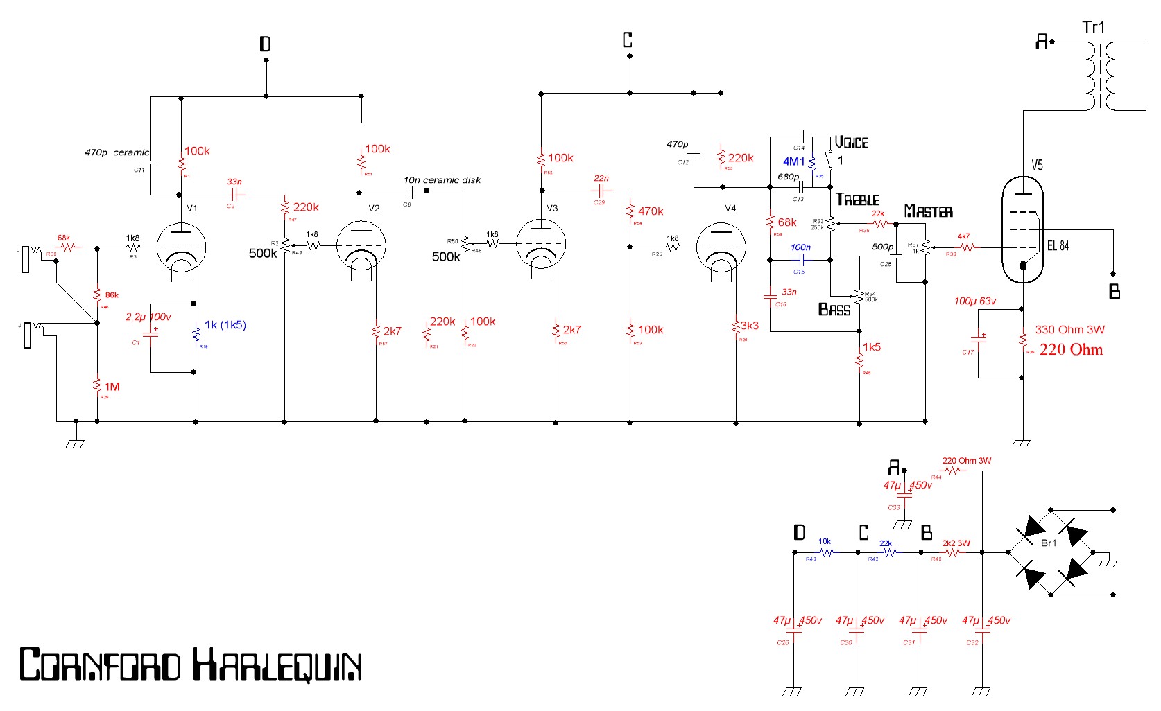

I need to keep going back to one of the simpler shematics for reference (see attached image).
I think either of your choices sound OK- the decision may depend on layout and space available, wiring points near the tube socket, etc. Grid stoppers are one of the few places where I break the 'every component anchored at both ends' rule as I often put the resistor at the end of the connecting wire (shielded or not) with heat shrink over, soldered to the tube pin with as little lead as possible.
I also see some amps appear to have a low pass filter with a 470pf cap across a 470K resistor that is in series with the grid and input, do these serve as a noise suppressor?
I see other configurations with caps across the input to ground, but not sure what purpose these serve, as i found i got more noise adding them.
Can you remember specific examples from schematics?
Usually caps across the input are to prevent RF noise, I think.
I also see caps in parallel with the plate resistor, which I understand is an 'oscillation tamer' in some designs.
Here's an example of the latter, which also shows separate grid stopper and input resistors (Cornford Harlequin).
Was that the Kendrick Roughneck amp?
I think the idea there is to allow the higher (audio) frequencies to bypass the 470k resistor to give a 'bright' input - that's what the labels seem to imply.
Thats what i remember in that schematic you have!
IDK why fender dont use gridstoppers there?
Alot of amps i see only have a gridstopper on the first stage anyway, and i guess thats because thats where most of the noise is picked up in.
Interesting that fender dont use one in that position, but TBH i have not noticed any audible difference with or without them on the other stages of my amp, so ill probably remove them to make it tidier.
Ill still keep a gridstopper on the first stage I think anyway.

I have had another look at your original schematic - there is no bypass cap on the power valve. You could easily try one and see if it helps get the sound you want.
Reducing 1 or more of your coupling caps may help the mud - I tend not to use anything bigger than 0.01u, and you could try going as low as 2n.
This circuit still has a lot of potential for improvement.

Should i be taking negative feedback from the OT into the driver stage?
That cleans it up but lowers the output typically.
Interesting about the coupling caps, i could try some 4.7nf caps i have floating around somewhere.
Dont know why 0.022 is so popular though.

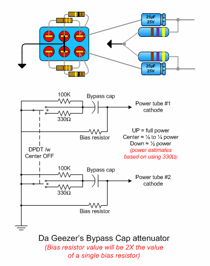

I agree with Jim's recommendation about the bypass cap on the output tube.
It's a feature of a lot of guitar amps (5F1 Champ, 5E3 Deluxe, 6G10 Harvard, Marshall 18Watt and on and on), and definitely increases the 'loudness' and changes the tone.
It's a simple mod (a 25volt 25uF electrolytic will give you the idea), and it can be made switchable if you want to make comparing the effect (with and without the bypass cap) easier.
Switches are great - especially for before and after while deciding on final values and design.
You could try feedback from the OT. My amps often have a 3 way switch for this aiming for different levels eg a lot (fender), a little (Marshall ), none (Vox)

That looks interesting indeed, i probably will give this a try and i could always add a switch as you say.
In my case, would it be as simple as putting a 25uF cap across the cathode resistor?
Another thing i was going to ask was if i need a heavy wirewound resistor on the cathode.
I could make the wiring much more tidy if i could get away with a 1W carbon film.

You can measure the quiescent voltage across your cathode resistor and use the formula P = (V x V / R) to find the power dissipated in that resistor. Then double that (to give a good safety factor) to check the power rating of the resistor.

Yes - since it will be an electrolytic, observe polarity (- to ground) and that will do it.
I usually use a 50v-rated axial cap there (they are so small and cheap nowadays) but you can measure the voltage across the resistor (which you'll be doing anyhow to figure your cathode resistor power dissipation) and probably get away with a 25v cap if that's all you have in your parts bin.

Ive just done some more work on the amp and added a cathode bypass cap on the output tube.
Im getting about 25v when idle and just over 30v when playing at full blast.
The resistor is getting extremely hot to touch, its rated at 5W, but my calculations at 330ohm work out to only 2.7W, which is not alot.
Anyway, i placed a 25uf cap across the resistor and it gives way too much gain, it makes it louder, but at the same time, very overdriven, hard to run clean. Would also oscillate and whistle when you turn up to half volume or more.
I put a 2.2uf across, and this made some improvement, but will still oscillate if turned up enough.
I probably only need 0.47uf or 1uf across it perhaps?
Im yet to increase the resistor to 470 ohms, this may also help.

2.7W @25 volts is over 100mA - or is my math wrong?I
The resistor is getting extremely hot to touch, its rated at 5W, but my calculations at 330ohm work out to only 2.7W, which is not a lot.
What's the power dissipation for your tube at 100mA?
Also, I'd be thinking about 'turning down' the preamp gain as one possibility for taming the oscillation, after lead dress and grid/screen/plate stoppers and 'the usual suspects' were tried.
The maximum voltage i measured across the cathode resistor was 30v so I worked out 30V / 330 ohms = 0.09A, which is close to 100mA like you said.
0.09A x 30V = 2.7W is this correct? At 100mA it should only be 2.5W according to my calculations.
It doesnt go below 25v when idle even with no signal going through with volume down, so 100 mA is probably the maximum current on the cathode resistor.
Adding the cathode bypass cap has increased the gain significantly and i kind of was expecting the oscillation with how loud it was at only a moderate volume. Only issue is it makes it sound more overdriven and less clean, infact its dont the opposite of what i expected, as i was expecting it to sound cleaner while louder at the same time. I have not scoped it yet, but i expect there will be significant clipping.
Anyway, i have not measured the output of the amp yet, but i expect i am probably getting 15W RMS from it.
Im not sure what the power dissipation is of the output tube when idle.
I usually just put a tone through the amp and measure the RMS output in watts, which is probably a good 15W.
