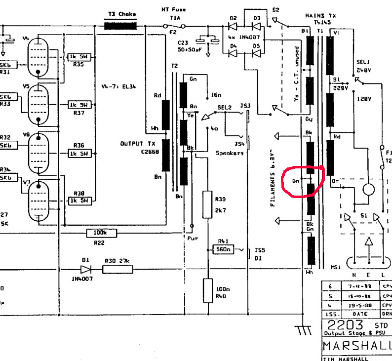

Issues with Single ended guitar amp build
I was thinking of doing something similar and wire both resistors as gridstoppers together on the valve socket and connect with shielded cable to the jacks.
Ive already got a hole in the chassis with a jack installed, so i may as well use it .
Ahh, yes your right, that is how the fenders are configured.
Would say using a 4.7K grid stopper be a better idea and then wire both input jacks in a similar fashion to a fender amp?
I probably would stay with 56K instead of 68K
As I proved with my stupid comment earlier, input jack wiring is something that I seem to find confusing!🙁
I need to keep going back to one of the simpler shematics for reference (see attached image).
I think either of your choices sound OK- the decision may depend on layout and space available, wiring points near the tube socket, etc. Grid stoppers are one of the few places where I break the 'every component anchored at both ends' rule as I often put the resistor at the end of the connecting wire (shielded or not) with heat shrink over, soldered to the tube pin with as little lead as possible.

Fender didn't use any part they could omit. The goal was profit, not engineering.
You aren't meant to hear grid stoppers (normally). Leaving them out is like taking out your seat belts cos you didn't have an accident last time you drove.
The advantage of DIY is being able to include good engineering principles and not try and save every dollar possible.
I have had another look at your original schematic - there is no bypass cap on the power valve. You could easily try one and see if it helps get the sound you want.
Reducing 1 or more of your coupling caps may help the mud - I tend not to use anything bigger than 0.01u, and you could try going as low as 2n.

I agree with Jim's recommendation about the bypass cap on the output tube.
It's a feature of a lot of guitar amps (5F1 Champ, 5E3 Deluxe, 6G10 Harvard, Marshall 18Watt and on and on), and definitely increases the 'loudness' and changes the tone.
It's a simple mod (a 25volt 25uF electrolytic will give you the idea), and it can be made switchable if you want to make comparing the effect (with and without the bypass cap) easier.

Ive just done some more work on the amp and added a cathode bypass cap on the output tube.
Im getting about 25v when idle and just over 30v when playing at full blast.
The resistor is getting extremely hot to touch, its rated at 5W, but my calculations at 330ohm work out to only 2.7W, which is not alot.
Anyway, i placed a 25uf cap across the resistor and it gives way too much gain, it makes it louder, but at the same time, very overdriven, hard to run clean. Would also oscillate and whistle when you turn up to half volume or more.
I put a 2.2uf across, and this made some improvement, but will still oscillate if turned up enough.
I probably only need 0.47uf or 1uf across it perhaps?
Im yet to increase the resistor to 470 ohms, this may also help.

The resistor is getting extremely hot to touch, its rated at 5W, but my calculations at 330ohm work out to only 2.7W, which is not a lot.
2.7W @25 volts is over 100mA - or is my math wrong?
What's the power dissipation for your tube at 100mA?
Also, I'd be thinking about 'turning down' the preamp gain as one possibility for taming the oscillation, after lead dress and grid/screen/plate stoppers and 'the usual suspects' were tried.

The maximum voltage i measured across the cathode resistor was 30v so I worked out 30V / 330 ohms = 0.09A, which is close to 100mA like you said.
0.09A x 30V = 2.7W is this correct? At 100mA it should only be 2.5W according to my calculations.
It doesnt go below 25v when idle even with no signal going through with volume down, so 100 mA is probably the maximum current on the cathode resistor.
Adding the cathode bypass cap has increased the gain significantly and i kind of was expecting the oscillation with how loud it was at only a moderate volume. Only issue is it makes it sound more overdriven and less clean, infact its dont the opposite of what i expected, as i was expecting it to sound cleaner while louder at the same time. I have not scoped it yet, but i expect there will be significant clipping.
Anyway, i have not measured the output of the amp yet, but i expect i am probably getting 15W RMS from it.
Im not sure what the power dissipation is of the output tube when idle.
I usually just put a tone through the amp and measure the RMS output in watts, which is probably a good 15W.
