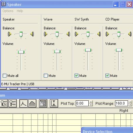

You have most likely a problem with the 🤐 PatchMix. Use the default profile and mute down anything not absolutely required.
Did the muting, gained 1.5dB better noise floor, THD the same. This is fantastic performance for my standards. I am chuffed. Maybe it can do better with a faster 64bit PC with lots of fast mem. It also does well for noise floor up high to 96kHz when sampling at 192k.

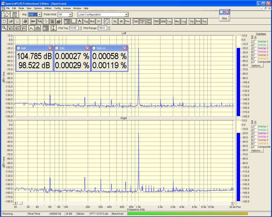

EMU0404usb - 192KHz/24bit
The PC used is: Intel C2D-3GHz (E6850), 8GB DDR2 sync, FSB 1332MHz. The OS is WinXP x64.
EMU is connected in loopback mode via two balanced cables from out to in. The results presented are not the better. I have obtained better results when the EMU is a little warmed. After half an hour, those are worse. This caused from the analog ICs used in inputs and outputs, as well the volume pots... by no way i can obtain the results of the PCI EMU of Syn88. This because i have installed only the drivers of EMU and its software mixer sliders (only 3) are in max place, so i can adjust volume only from the physical pots of EMU which is a bit difficult. Also, if you are patient and have a good PC, by selecting 1,048 millions FFT samples, then there is an improvement in results.
Anyway, see the results in the picture

salas said:0.00041% and -150dB noise floor from 300Hz to 24kHz with the USB one at -15dB like your level. That's the best I will ever get with tracker pre, and its super for my needs. Buttons and USB cable give the edge to your PC card. Thanks Syn08.

I will also mute the unused inputs in windows mixer. The meas shown in my picture was taken with all inputs unmuted. I will inform you if there are better results.

Yes, the mutting of unused inputs was some effective. In the right channel i got:
THD arround 0,00020%
THD+Noise arround 0,00021%
SNR arround 114 dB.
These values obtained, are very close to PCI EMU of Syn88 presented in his first post.
I think can be better because the little instabillity presented by the EMU usb. Looking the spectrogram running, i observe allways the three parameters to get gradually better values untill some moment, and after it again gradually to get worse values. But, for example, THD never exceeds 0,00050%.

i still don't understand: what did you exactly mute? and where did you mute those things? through the mixer?
mmmm....i can't reach that low THD, what setting did you use on spetra for the specific case of THD 0.00020?
I did notice that numbers go down till a certian point where all of a suddent they go up....maybe it is due to the fact that the PC is elaborating some other datas for Win...i don't know!

Me I muted those on the pic but I only got 1.5dB better noise floor. I don't know if I understood well. The 0.0004% vicinity I reached was with -15dB level on the generator, and for non delayed channel. The displayed S/N ratio worsens with less db than your -9dB setting as expected.

salas said:Me I muted those on the pic but I only got 1.5dB better noise floor. I don't know if I understood well. The 0.0004% vicinity I reached was with -15dB level on the generator, and for non delayed channel. The displayed S/N ratio worsens with less db than your -9dB setting as expected.
Don't you use the EMU PatchMix? I don't know how good is the integration with the poor Windows control panel. I doubt you can mute the digital channels (if you have any).
I will on the laptop which is only for measurements. Now I just check it on the PC (got Emu yesterday). So I don't want to fully install stuff in the general purpose machine that runs router, firewall, all my applications, etc etc. Just familiarizing a bit. Thanks guys, I got to know almost all there is to know about Emu Tracker and more (VS dedicated, Spectraplus manipulations) in just one day! It was a nice lucky incident that Stefano had to open that thread just 2 days ahead of me.
