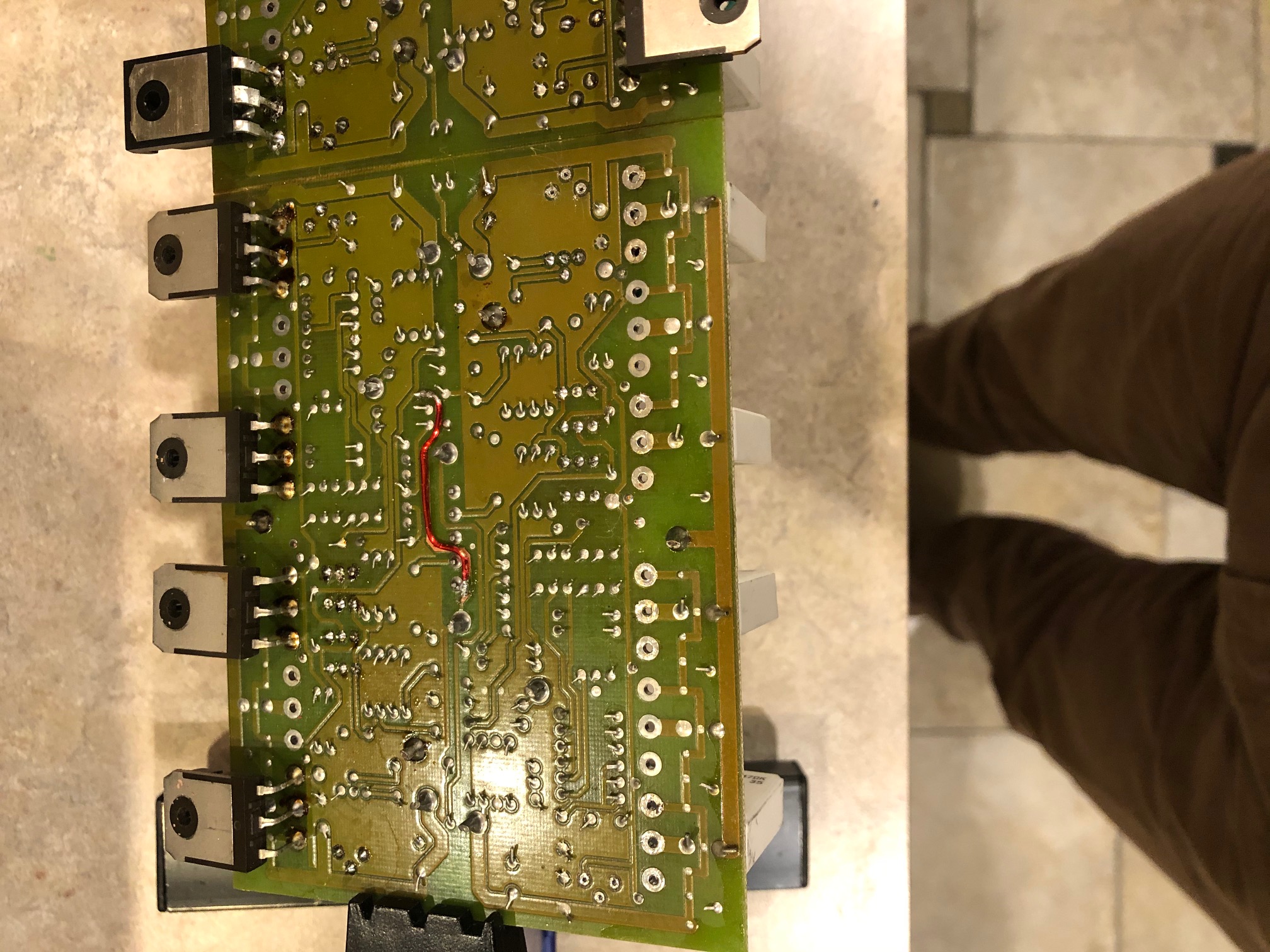

Bad news - while testing why the outputs were not getting drive, I shorted a resistor and blew a trace off a working channel, as well as the negative side rail fuse for that same channel.
Repaired the traces, resistor and tested all pre-drivers, replacing any that tested as bad (I think there was 3 on one channel and 2 on another).

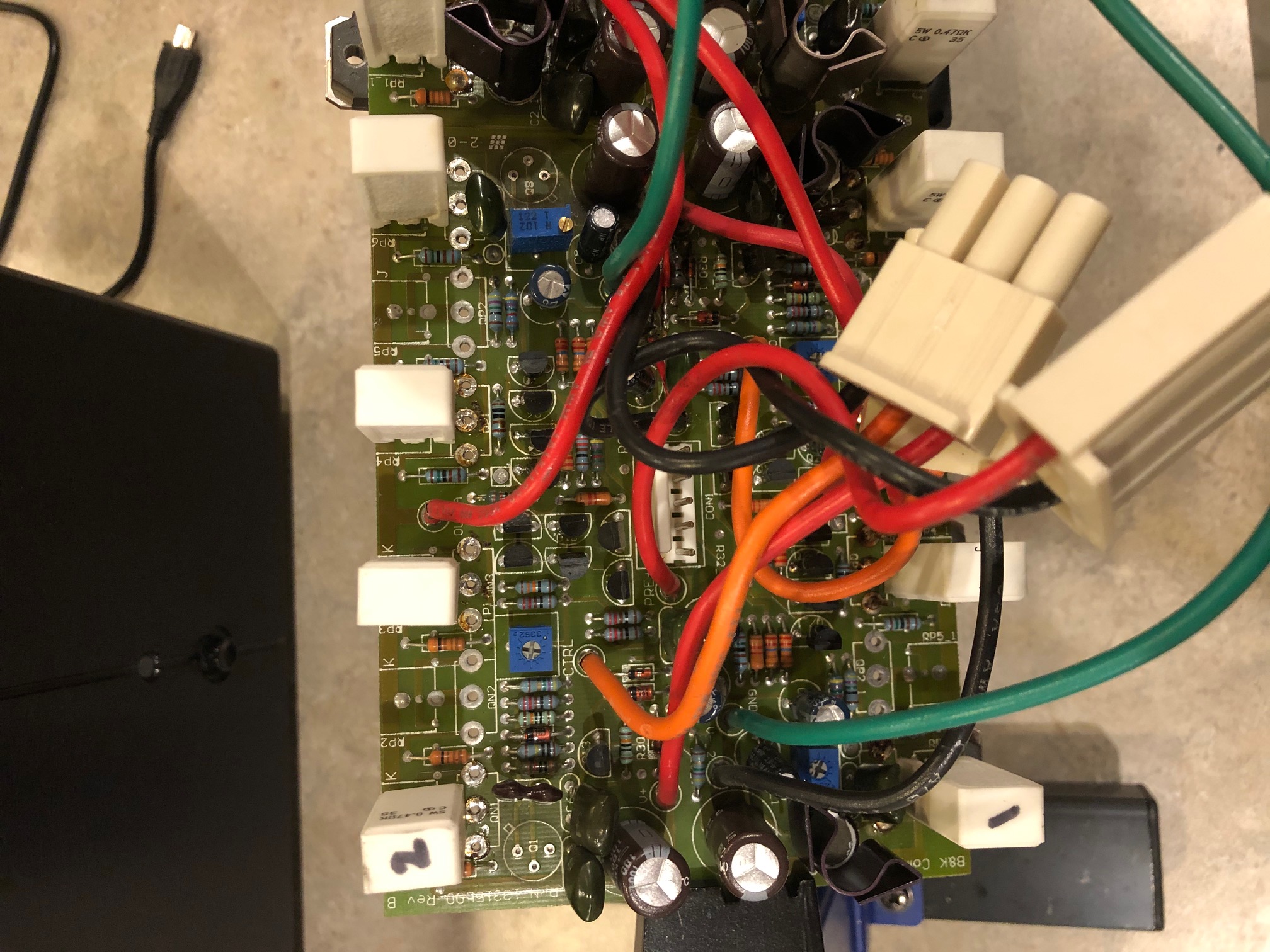

I put the amp in my HT rack, with brand new XLR cables and watched 2-3 movies and my son played xBox for about a week. After about a week, I finished watching a movie with my son and I wanted to feel how hot the amp was getting and make sure ventilation was adequate.
I touched the top of the case and heard a "crackle" (a small 1-2 second buzz, then pop) through one channel (Right surround). The case was warm but not hot at all, probably 35-40C, which is slightly more than is ran on my test bench for a week.
I turned it off and when I turned it back on 2-3 minutes later to see if the "crackle" was still there - DC out of that same right-surround channel and before I could turn it off, it had a loud BUZZZZZ and blew the woofer (5-1/4") in that surround speaker. Now that channel is dead - no DC being output?
I pulled the amp, tested all the other channels (they all work fine) and this channel was a working channel when I bought the amp, but was one of the effected channels by my "mis-hap" with the DMM probe.

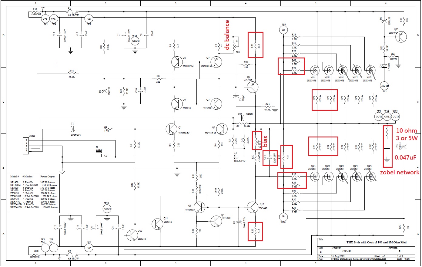

Your amp channel maybe oscillate and cause heat, please add zobel networks resistor and cap to all the output post of your amp if it has no installation.
Next time if you found your amp something wrong, don't turn on with speaker connected, disconnect speaker first to do the further test.

Please make sure all the resistors around the driver and mosfet ouput are ok and add the zobel networks to all outputs post if there is no installation.

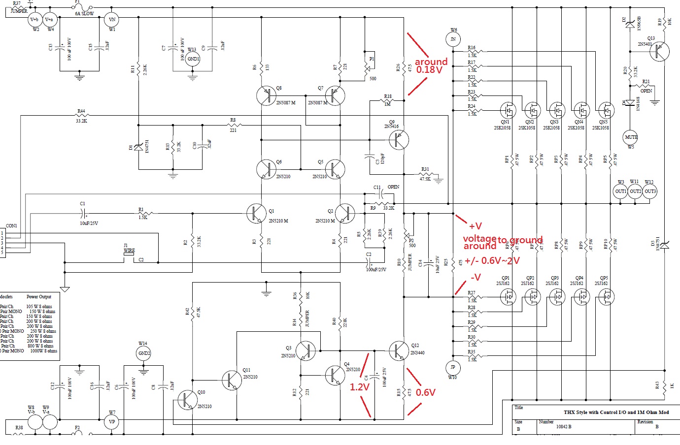

The only strange part is it has +/-65V (red/black) going to the 4 channel board, and also has +/-65V (Red/Orange/Black) along with Ground (Green). Not sure why it needs two wires carrying the same rail voltage, but I think it is a mute circuit possibly, testing if there is full rail voltage (guessing though).
Based on the schematic it looks like they set up the amp front end to be CRC filtered and unfused, thus the reason for the two separate DC bus wires.
OK - I tested the outputs and drivers again (replaced the drivers with new ones, with similar Hfe (124 & 129). I also re-checked all the pre-driver transistors still on the board, both for shorts with the DMM, but also related to the three other working channels as a comparison (all checked out good). I also checked more than half the resistors again, comparing to a good channel - all measured good?
The amp powers on (I brought it up with a DBT at 60w, 150w and then w/o bulb) - I can set the bias (currently set low at 20mV). Everything seems to be working, but I'm getting +65Vdc on the speaker terminals. Bias and voltage on speakers is stable, but I only had it on for 5 mins., wanted to see if I could get some help before I caused more damage.
Any idea what these symptoms point to as the problems?
Amatuer, but leads me think one pair of the outputs are actually bad? Noob theory - does the +65Vdc point to 2SJ162 (negative rail) side of outputs? Or better yet, does it point to a pre-driver transistor on the negative rail? I have spares and they are easy to change, should I pull and test all of them again?

If you put back new drivers and mosfet, power on with no burning parts or fuses but showing output one supply rail voltage, then it maybe caused by bad solder joint, joined solder points or a broken PCB copper trace, If all parts are ok.
Please investigate the PCB solder joints and copper traces special on the negative supply driver side 2n3440.

I have not added the zobel yet, was going to add to an external speaker protection box I am planning to build before putting this back in service. So speaker out to protection box (zobel on the speaker posts), then to protection board and out to speaker posts, these will be connected to speaker wires going to speakers. Will this work? If not, I will have to tear-down the amp much further, to get access to the back panel to install.
It's painful for me to repair amp board with a double side PCB, desolder the through-hole parts without broken the PCB through-hole connection is a tough job. If the through-hole connection broken, it may cause a open circuit on one side, so that we must double check the connection on both side after a new part replacement.
For the bias problem, please test the VR if it's value change linear when tuning. Maybe need a new replacement.
It's good to add an external speaker protection circuit for the amp, I think the zobel add to the protection box will be ok, it just added for safety, the original amp can work without it.
