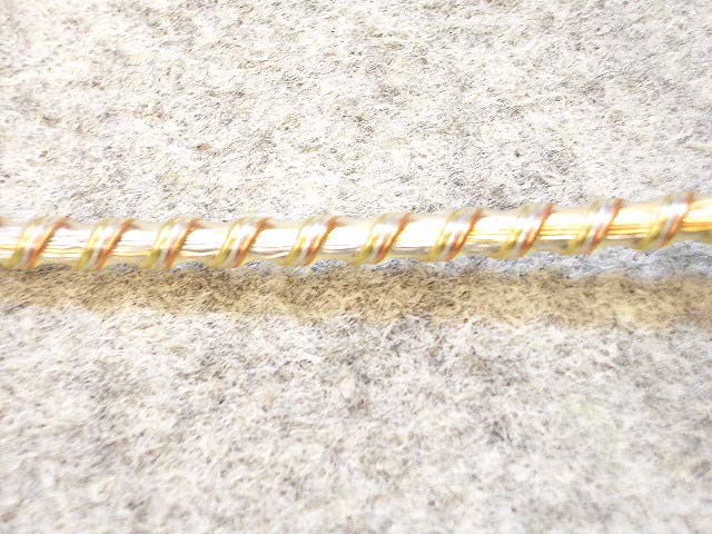

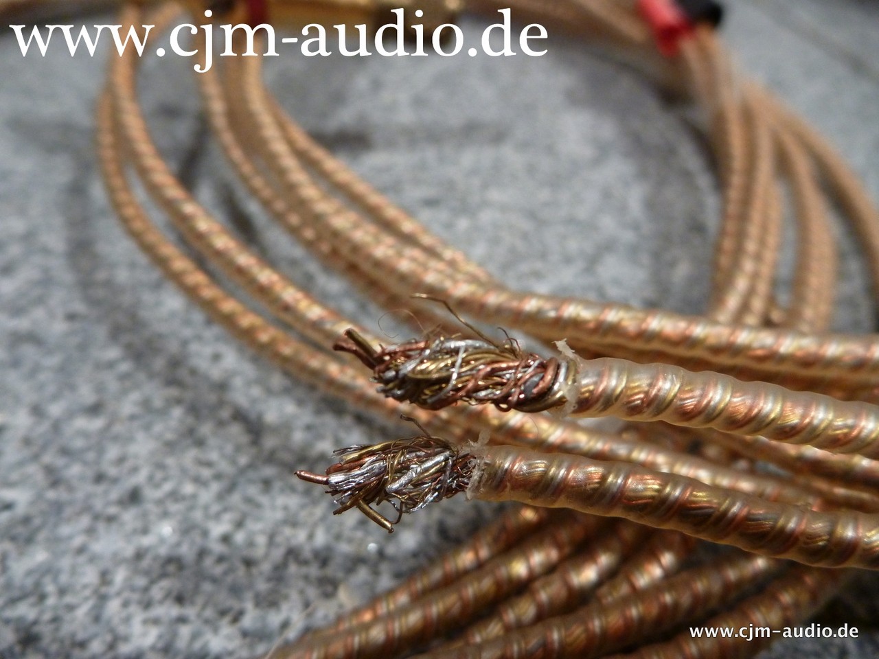

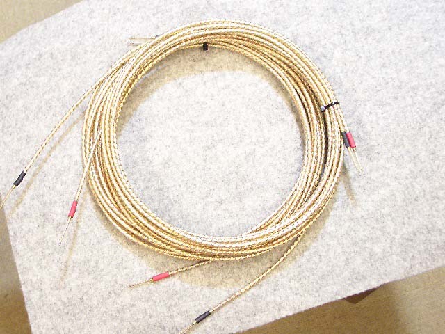

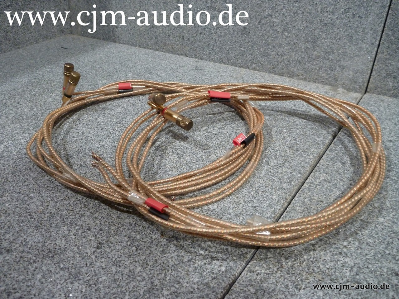

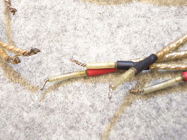

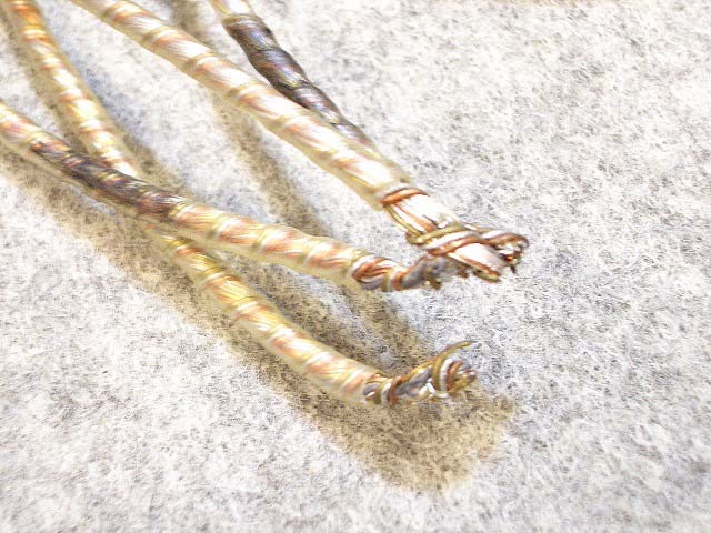

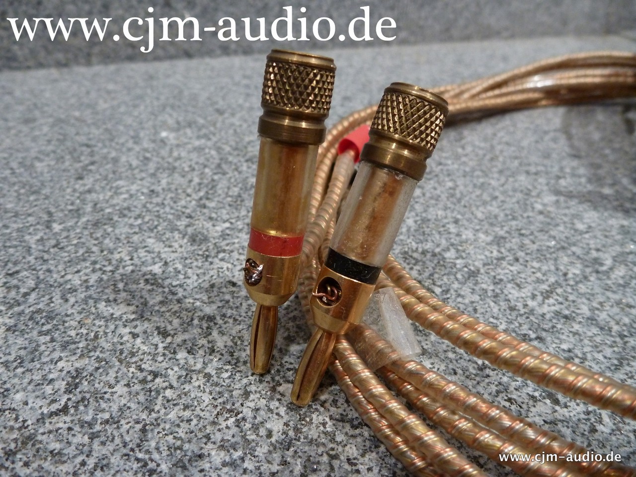

ISODA Speaker HB-55 HB55 Single Wire Cable - what other Option?
The cable from the attached images are already since a long time no longer available from currently manufacturing.
Sound quality very good in all respects.
What alternatives should one shortlist?
And a second question:

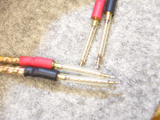

In what way is it best to make the connection to the plug
From my view image II seems to be a good approach but image VII not.
Thank you very much for advices.

Hello,
Pano will also know that these were considered very special in the past. AND i think they are still very special. There is however one thing that takes special care. There is aluminium used as well that needs to be presoldered with aluminium solder otherwise normal solder will not function. Probably if you just crimp it the aluminium wire will break. I remember the French la maison de l'audiophile sold alusol to use with Isoda. I still might have some but presently i am in Vietnam. Maybe at present day there is ordinairy solder available that will work with aluminium too. Greetings, Eduard

As mentioned before, the mix of metal, especially the aluminum, creates contact problem because over time, oxidation is bound to develop. I too would like to hear about AL soldering tricks.
