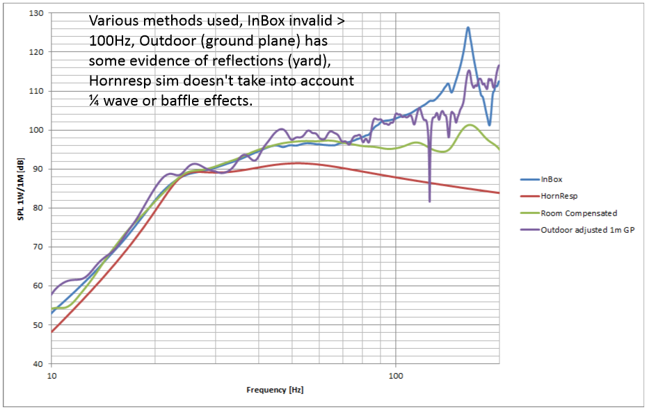

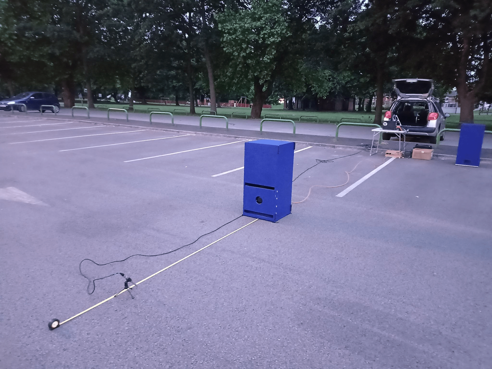

I mainly made this document for my own records but I think the design is a good way of getting decent output from cheap high Qts car subwoofer drivers. The measured maximum output is >115dB/1m @ 30Hz.

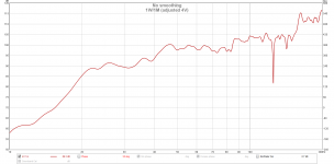

At 30hz all the different measurement methods pretty much match, it's higher in frequency where the real world measurement methods show increased efficiency. What the simulation doesn't take I to account though is the acoustic path length from the front to the back of the driver and the directivity of the speaker due to the front baffle dimensions. I performed some baffle simulations and also a simulation of the speaker as a stepped tapped horn and am reasonably satisfied that these two effects are what I'm seeing.
If I'm reading this graph correctly, the Hornresp sim is 6dB below the actual measurement at 30 Hz. If you adjusted the relative levels to "line up the curves", the position of the Hornresp sim is still questionable because the sim does not include the impact of losses, which will always result in the measured 2PI response always being less than what the sim predicts at low frequencies.

I read that as the Hornresp sim the same as the outdoor 2m ground plane sim(It has been adjusted to 1m distance) at 30Hz and the room compensated measurement and inbox measurement about 2dB above the simulation. A UMIK-1 with calibration and REW was used to get these measurements, so all apart from the InBox measurement did not require adjustment of levels for anything apart from drive voltage or distance. I don't have a microphone calibrator so cannot for certain tell you the microphone is working correctly but it has previously produced results I would expect. There are some more details of the measurement procedures and how (with help) I became satisfied that I understood the results I got:
Internal microphone to determine maximum SPL - Bass Gear - Data-Bass Forums
If you where looking for the most accurate representation of its performance in a typical domestic sized room I would use the 'room compensated' response which has no directivity effects. The inbox method is limited by the frequencies below which the pressure distribution is no longer uniform, from memory this is ~60Hz.
Oops, my mistake - the difference I was referring to is happening at 20 Hz, not 30 Hz. But the reason is the same - the Hornresp sim'd response should be higher than the measured response at 2.83V/1M (2PI), due to the effect of losses that are not accounted for in the Hornresp sim. If the sim is significantly lower in level (6dB in this case), then that suggests that one of the steps in the process needs to be reviewed.
Ah I see! The outdoor measurements where done in a pretty cluttered yard there's some reflections or boundary reinforcement down that low. Best I can do unfortunately. The other methods are closer but they are also subject to more error.

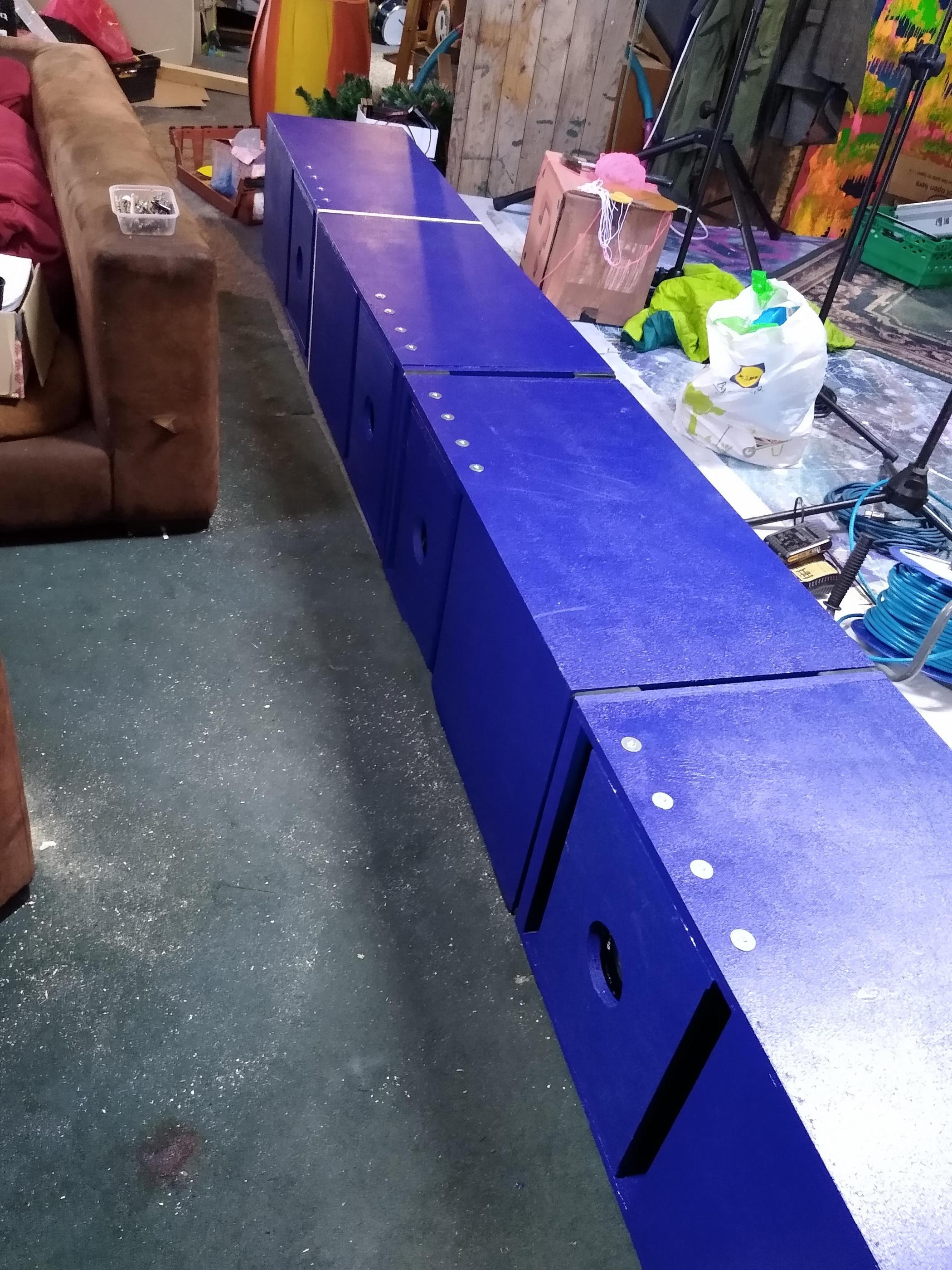

First gig done with four of this box driven from a P7000s in stereo mode with two subs per channel in a sort of warehouse style space (very large lossy room about 100 people). Subs performed remarkably well, where just enough for the party. For bands (heavy jazz funk) some peak limiting on the kick drum but not deleterious. For DJs mostly not limiting apart from very bass heavy passages. Lots of compliments on the sound and the extra depth compared to conventional sub setups was very noticeable. I checked the exposed driver temperature after a few hours and they where luke warm to the touch, no noticeable bass fade through the night, no driver failures.
Probably going to build a similar design around a single higher end driver in a few months to compare performance.

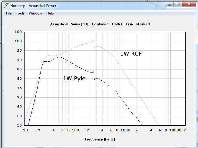

Hornresp record (with pyle driver) and sketchup 2017 model of the box attached. Also did a quick sim with a single RCF driver and it looks fine. Voltages are 2.83V on the RCF and 4V on the Pyle for standard 1W/1M. Even with this the single RCF driver is more sensitive than the isobaric pair of pyle drivers.

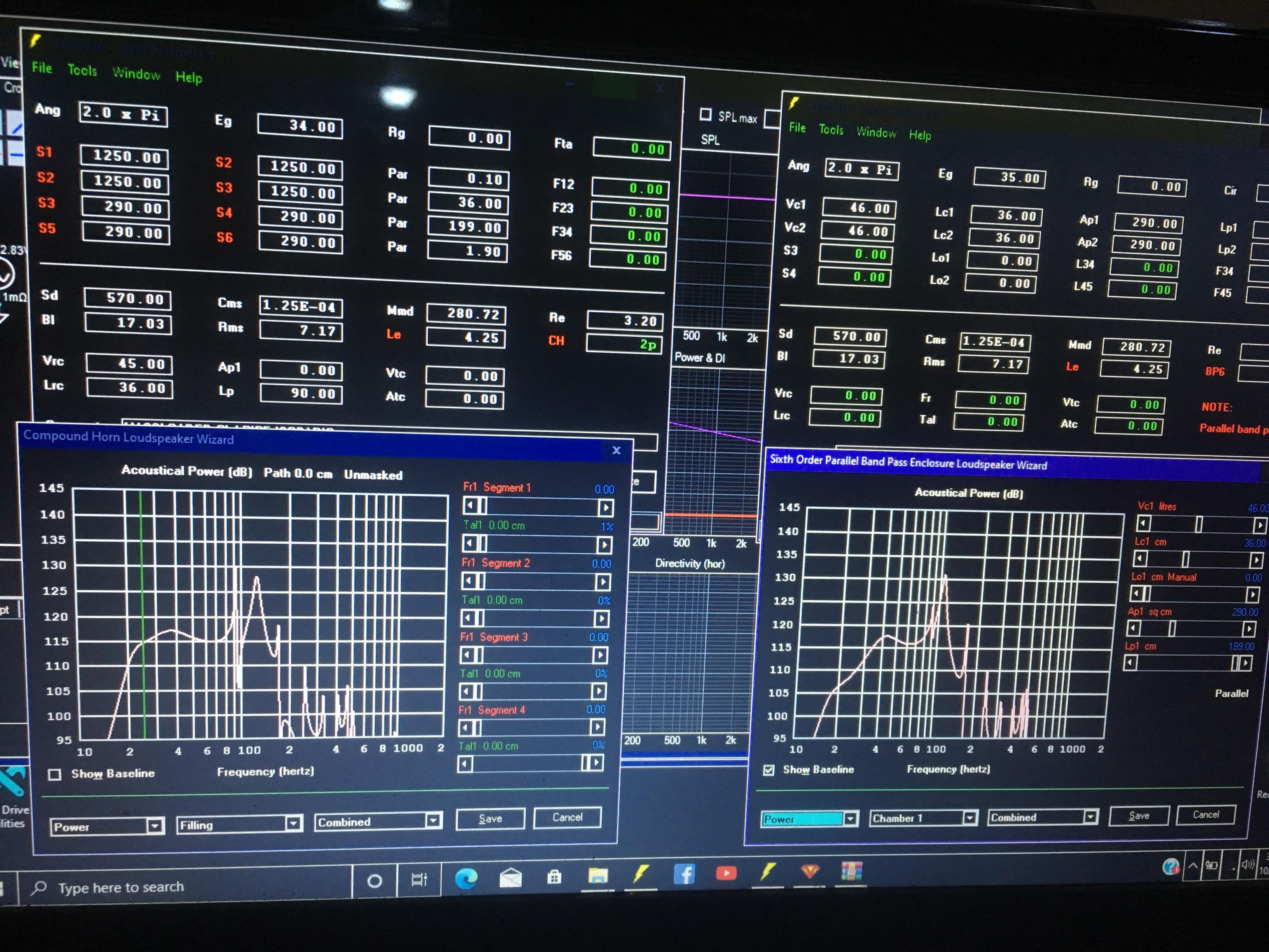

I have something similar, I simmed it as a single on the right in BP parallel6, and the isobaric on the left using compound horn. I have both at Xmax (off by one a tiny bit favoring the isobaric input power on accident...).
It seems consistent with the assumption the amp will allow the parallel wiring of the isobaric?

How much more output can you get with a single quality driver like the B&C 15TBX100 compared to the isobaric Pyle PLPW15D? Hornresp says the the box should be xmax limited resulting in around 3dB advantage in maximum output to the 15TBX100, however as a linear simulation it's no substitute for real world testing.

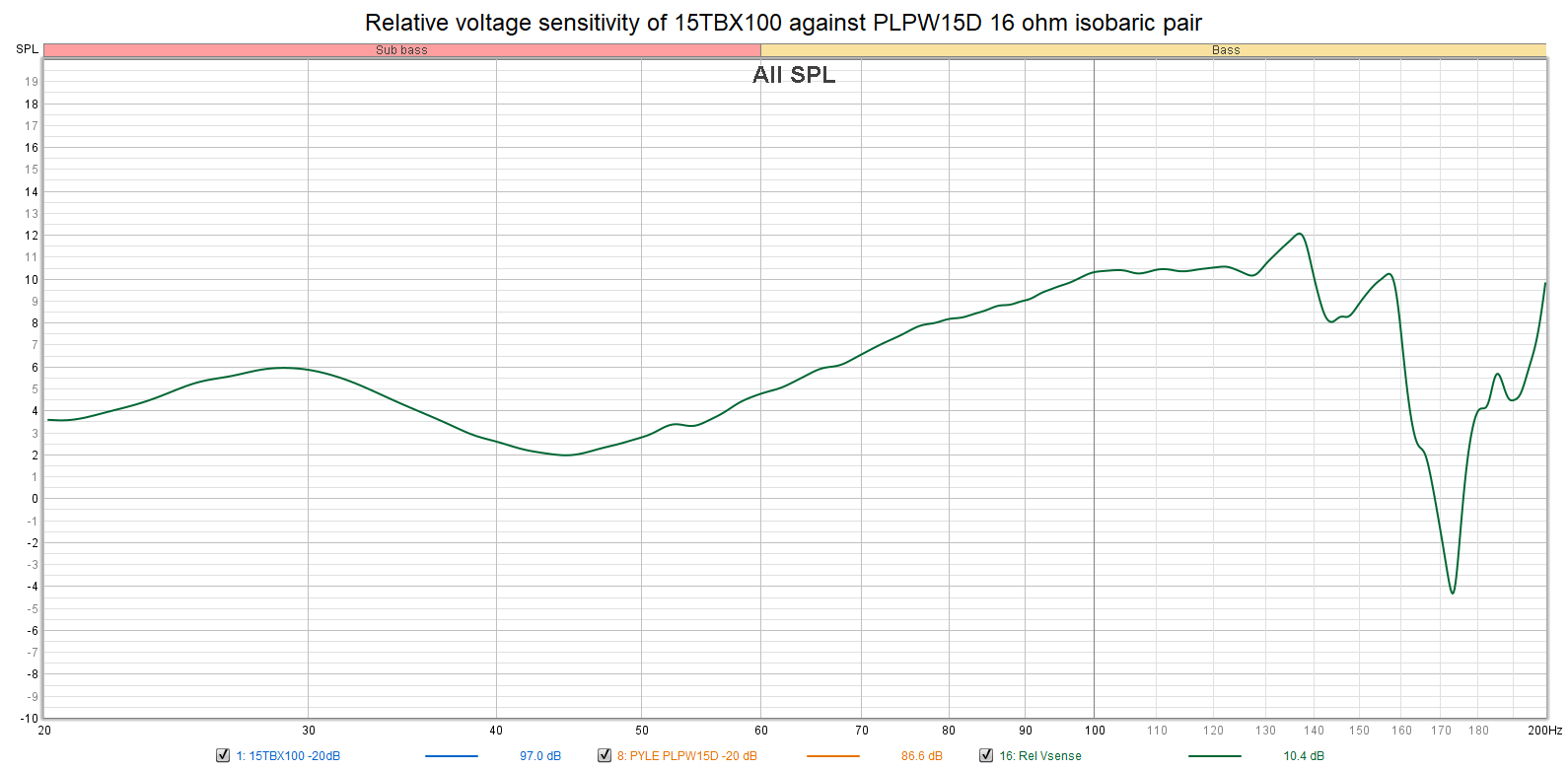

Relative voltage sensitivity at -20dBFs sweep (19Vrms):
The 15TBX100 is 8ohm nominal and the isobaric PLPW15D wired as 16ohm so we would expect at least 3dB gain in for the 15TBX100. Mostly we see more than this, around tune ~28Hz due to the more powerful motor and above 50Hz I think due to the lower inductance motor design. I think the dip at 170Hz is something to do with the absence of the driver cover.

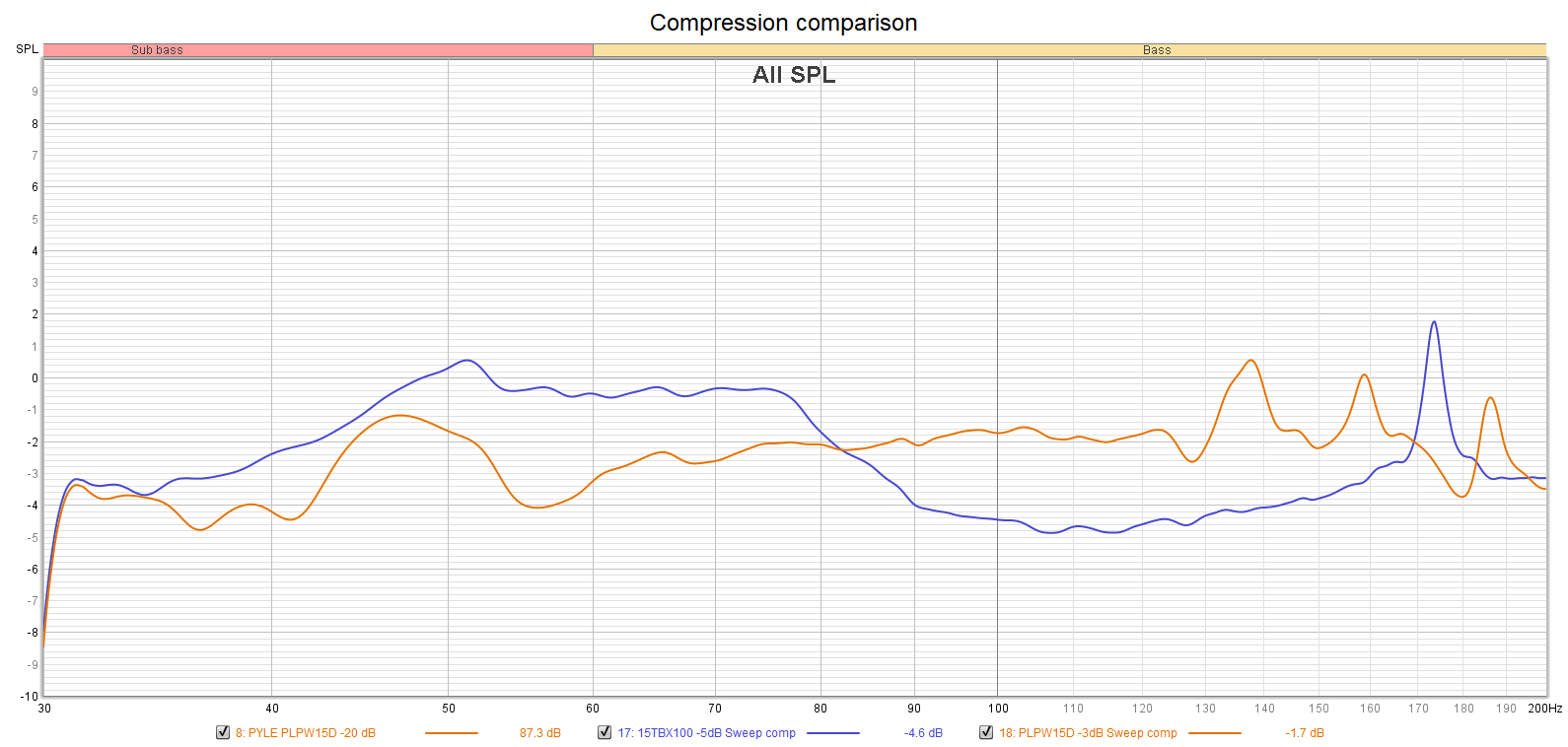

Maximum sweep level compression:
-5dBFs was the maximum level achived with the 15TBX100 (107Vrms) before I felt that the driver was limiting over much of its range while for the PLPW15D pair this was at -3dBFs (134Vrms).
*Note ignore the dip below ~32Hz this is due to performing trace arithmatic on a trace starting at 20Hz and a trace starting at 30Hz.
The PLPW15D is displaying more <80Hz compression while the 15TBX100 displays more compression above this, however the 15TBX100 also has way more output in the upper bass so is doing more useful 'work'. Both drivers have compressed more than 3dB so it would be sensible to peak limit them at 107Vrms (15TBX100) and 134Vrms PLPW15D as very little more output is posible. With the lower required voltage for maximum output the 15TBX100 is a better match for the P7000s in stereo mode (~100Vrms max output).

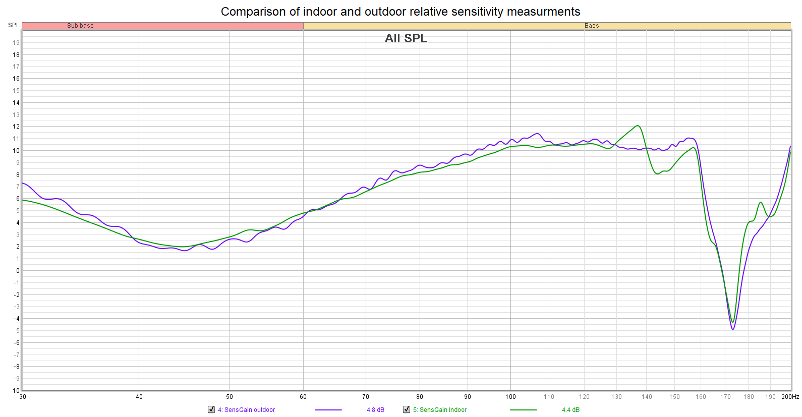

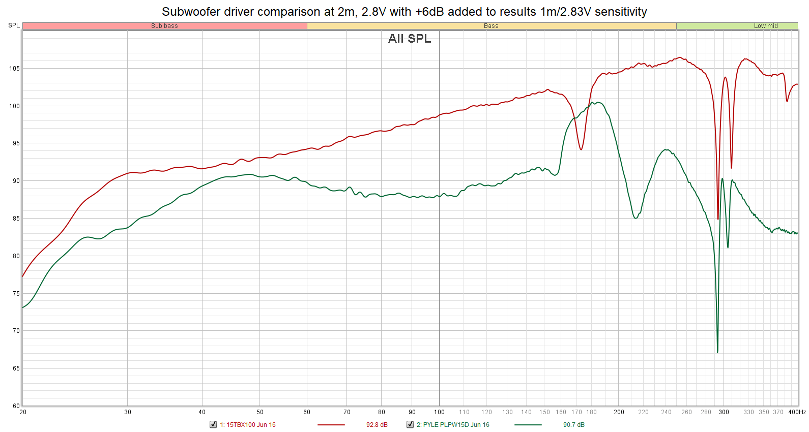

I used my battery powered amp to measure the two drivers voltage sensitivity outdoors:
Its worth pointing out the B&C is an 8ohm nominal driver and the Pyle a 16ohm isobaric pair. The Pyle also has the driver cover in place which I belive causes the unusual response beyond 160Hz. From this we can see that much of the gain over the Hornresp simulation that Brian Steele pointed out was indeed caused by reflections in the yard enviroment where I took my original measurments. We can also replot our voltage sensitivity gain using these outdoor measurments to compare to the indoor measurments I made:
They are very simlar indicating that the compression results I would struggle to take outdoors (as I'm usualy in a mad hurry at a festival if I have a sub and a generator and a large amp all at the same time) should be reliable.

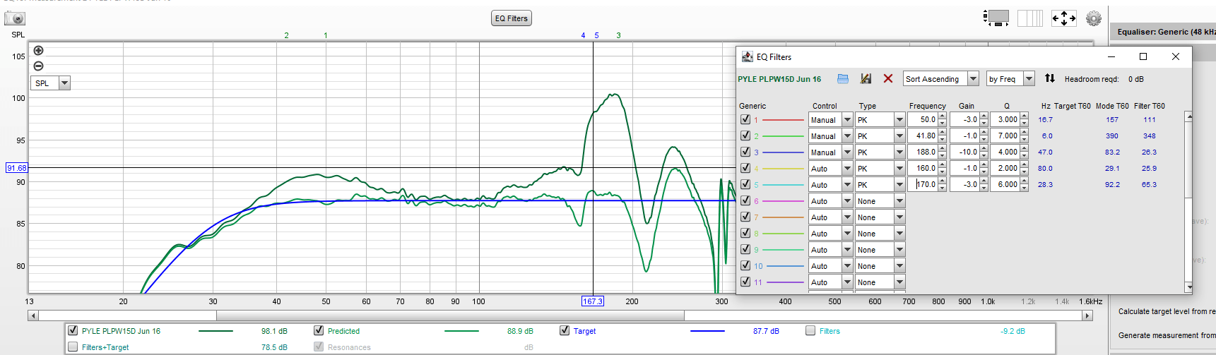

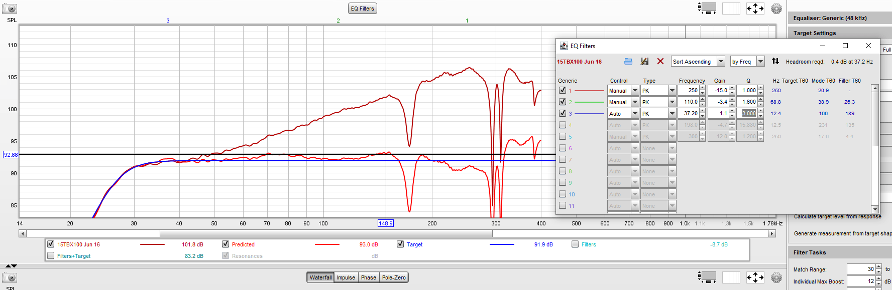

We can define simple EQ to flatten the 15TBX100 version:
and a new EQ for the PYLE isobaric version:
