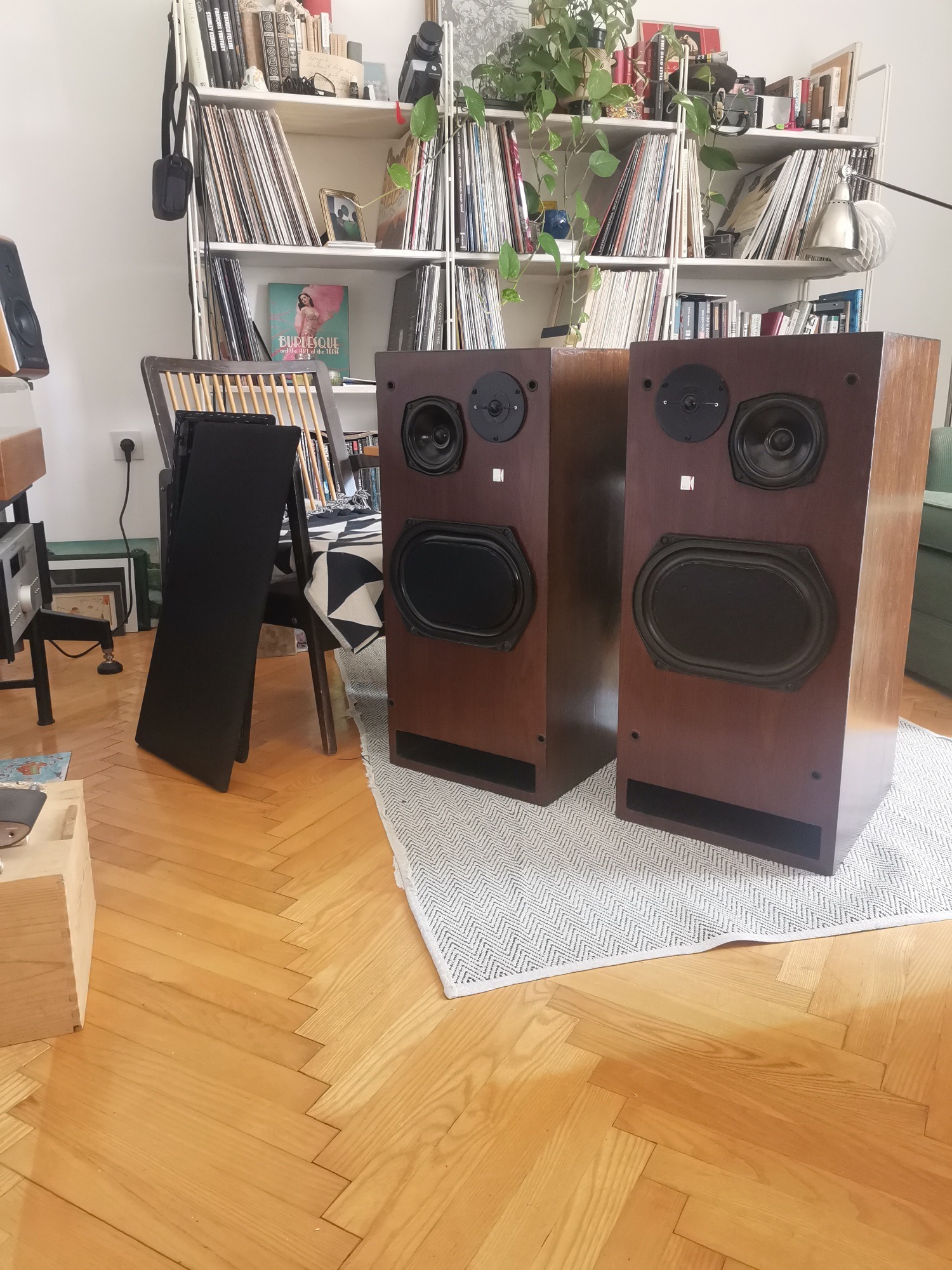

Never seen that before, it looks very KEF like. My woofers are the earlier b139 the racetrack types, dates from 1967 and my tweeters are scanspeak D2006 I think. Have had these for many years and yes they are very warm sounding. I think warm is typical of the old British speakers. The boxes are massive and beside Isobaric there is a transmission line behind them. They will rattle the rooftiles, like the dog jumped on your chest.Hi Nico,
WTH is this. I just brought home this one, it is far less analytical than my usual speakers, bu it is soo warm and good to my ears. What are those?
I also have b200 for 30years, as new, but these I bought with very small crack, or it was externally injured, so nothing to do anymore except repair...

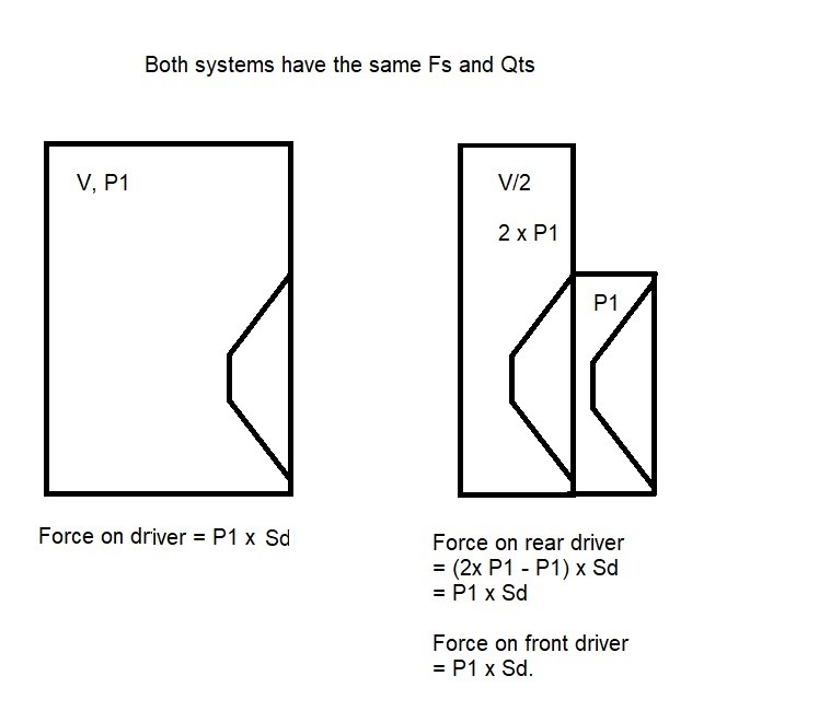

Simplified physics of an isobaric system compared to a single driver system.

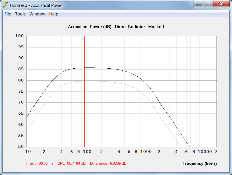

To add to the above, for a given input voltage if the two drivers are connected electrically in parallel in phase then the response will be the same as that for the single driver system. If the two drivers are connected electrically in series in phase then the response will be 6 dB lower.
In the chart below, the black trace shows the parallel connection response and the grey trace shows the series connection response.

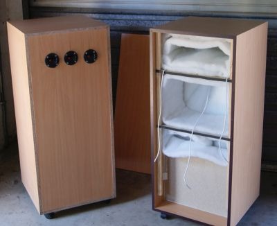

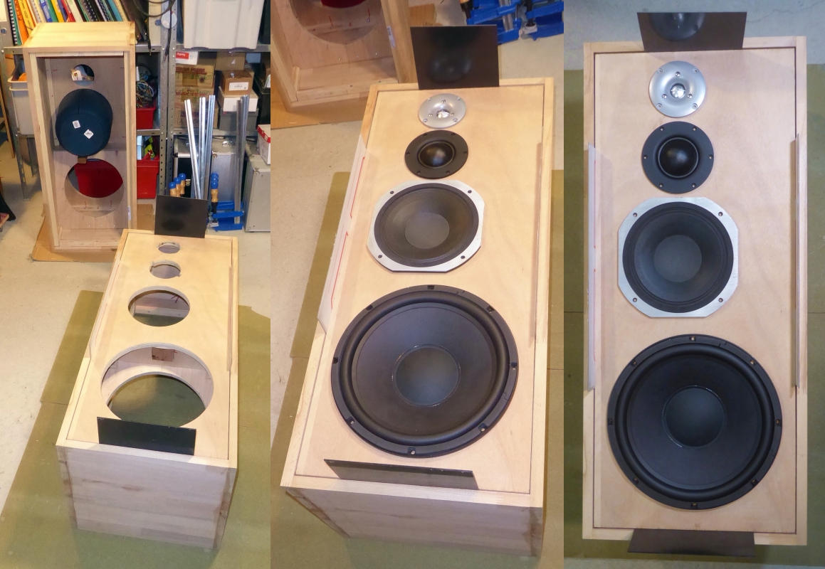

What is purpose on the gap on front panel sides? Is front panel glued or not to the rest of the box?Work progresses again...
T
Yes. The Gap is 2mm all around, for the front face and the rear face. Here's the construction of my 3-ways 375L :
Those front and rear faces are removable, screwed on the surround bracing with a flat gasket, and are previously covered with Simili (Leather imitation) :

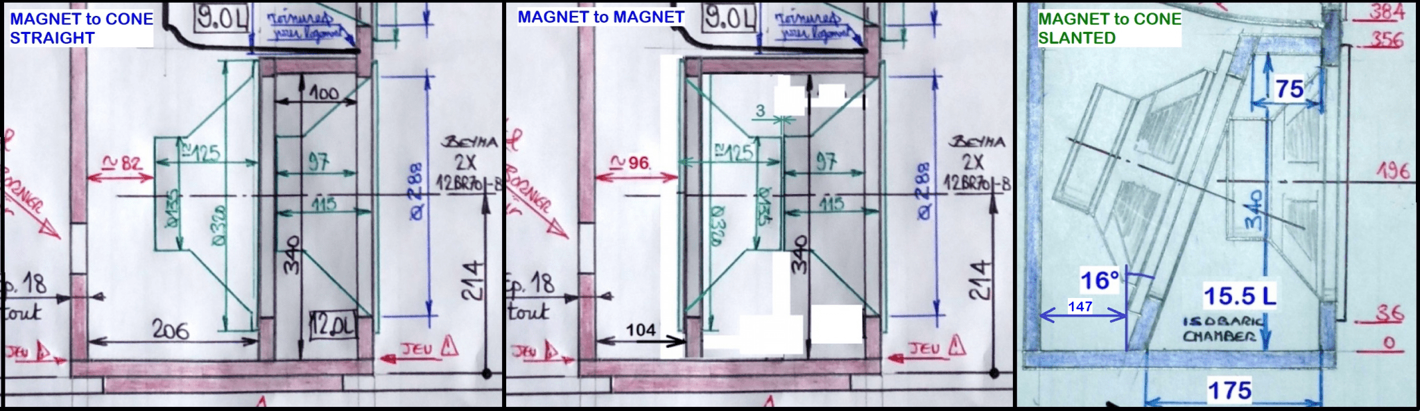

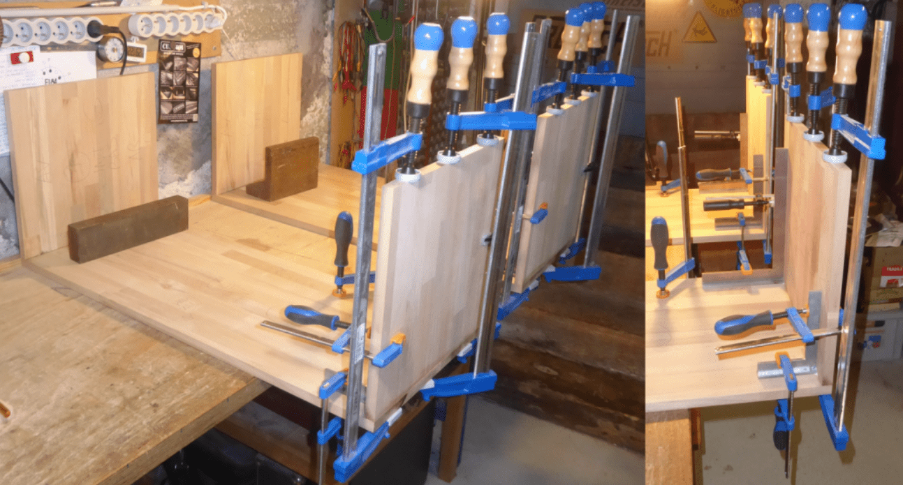

Yes, I studied 3 variants of the Isobaric principle, in the imparted dimensions of the cabinet :
I finally went for the "Slanted" option...
- In the "Straight" version, the chamber volume can be minimal, but free air circulation between the two speakers is not really satisfactory.
- In the "Magnet to Magnet", the chamber volume is notably increased, and I did not like too much a speaker face looking the back panel at short distance.
The "Slanted" is the compromise between sufficient back distance, reduced volume chamber and adequate free air circulation, plus offering a non-parallel internal baffle, which can't be bad for reflections...
