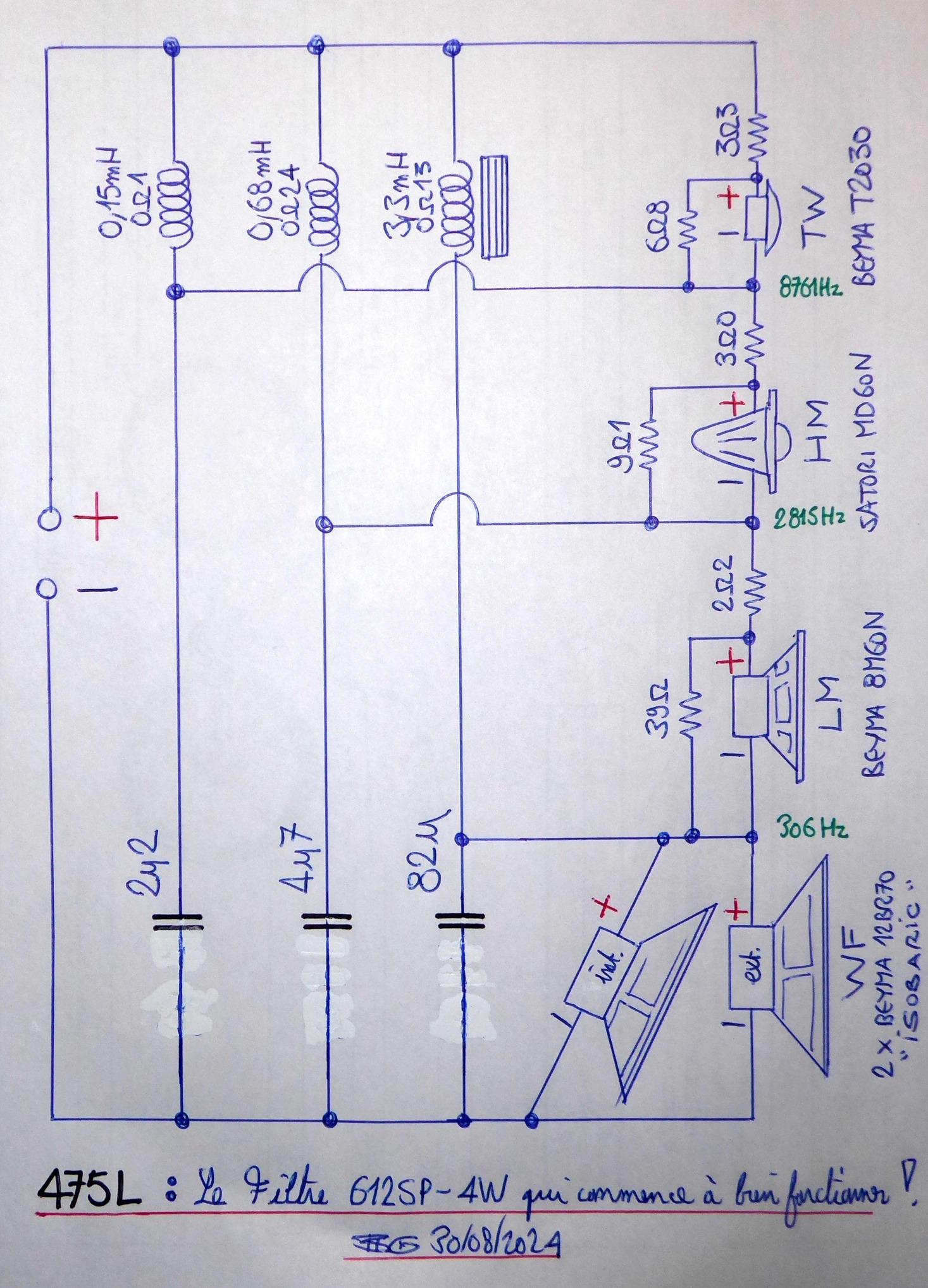

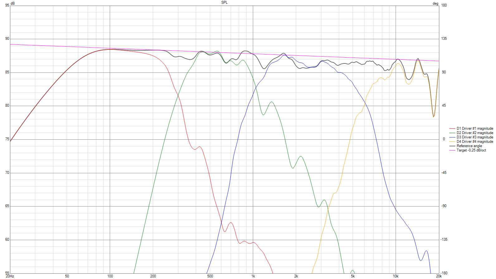

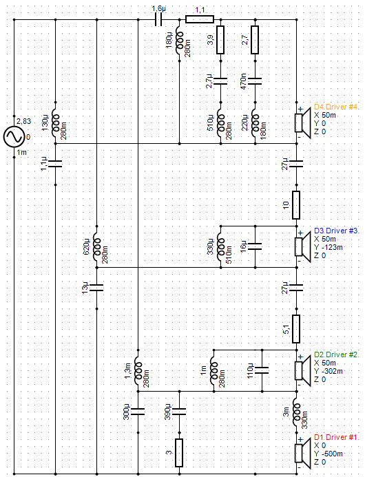

Here are the resistors values that I plan to test tomorrow :
TW : RS=2R2, RP=15R / att=-3.27dB / AVG Z on the frequency band (8K-15K)=7R
HM : RS=1R5, RP=27R / att=-2.07dB / AVG Z on the frequency band (3K-8K) = 7R
LM : RS=3R3, RP=22R / att=-3.31dB / AVG Z on the frequency band (300-3K) = 10R5

Listening tests update :
The 612SP-4W crossover begins to work fine with these values below :
The listening position : seated in a sofa, head at 3m from the speakers, 2.50m between speakers axis, speakers off axis 15° horizontal, vertical tilt back 8°.

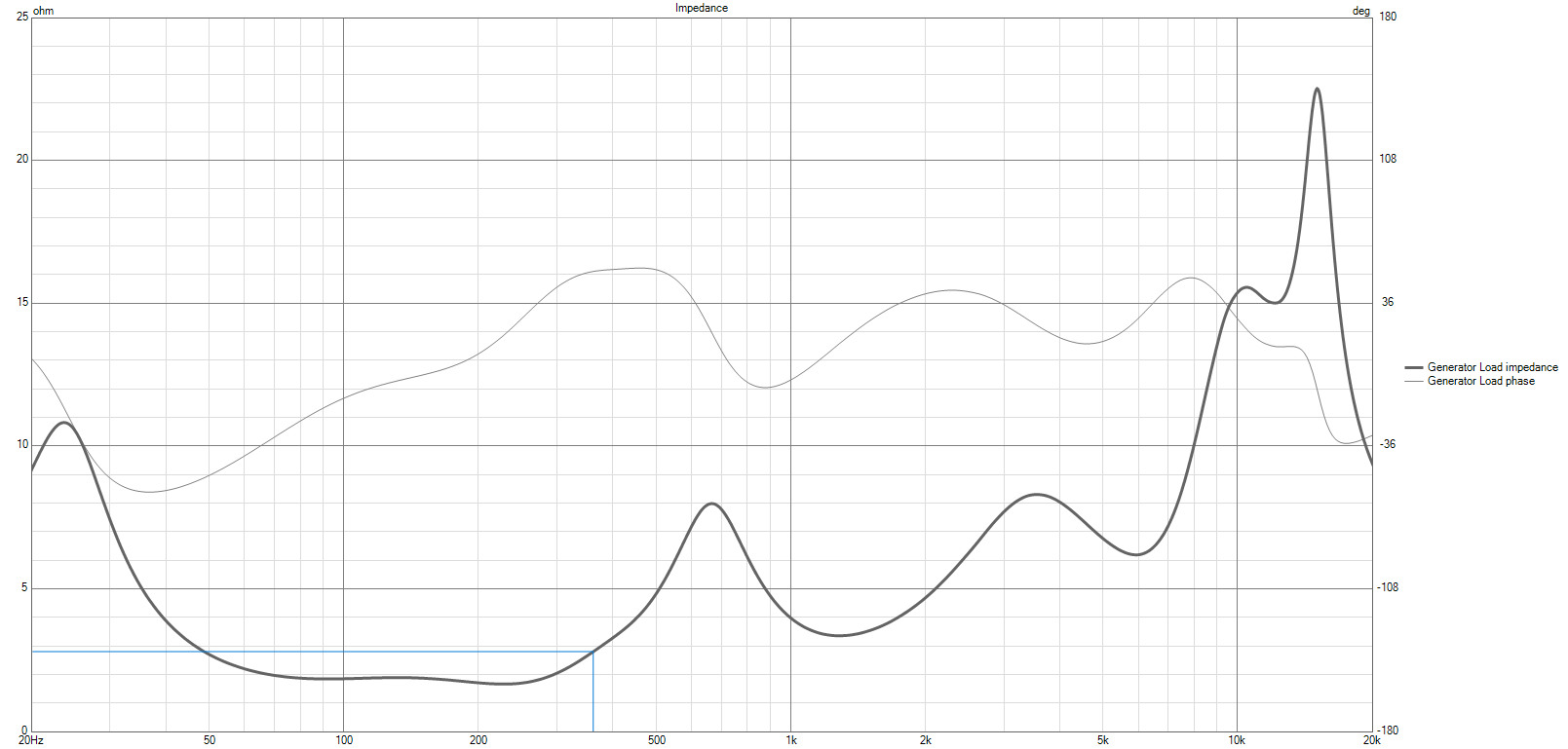

It have huge sensitivity because driver ranges overlapping, but also very low summarized impedance because of overlapping and high Q of filters.

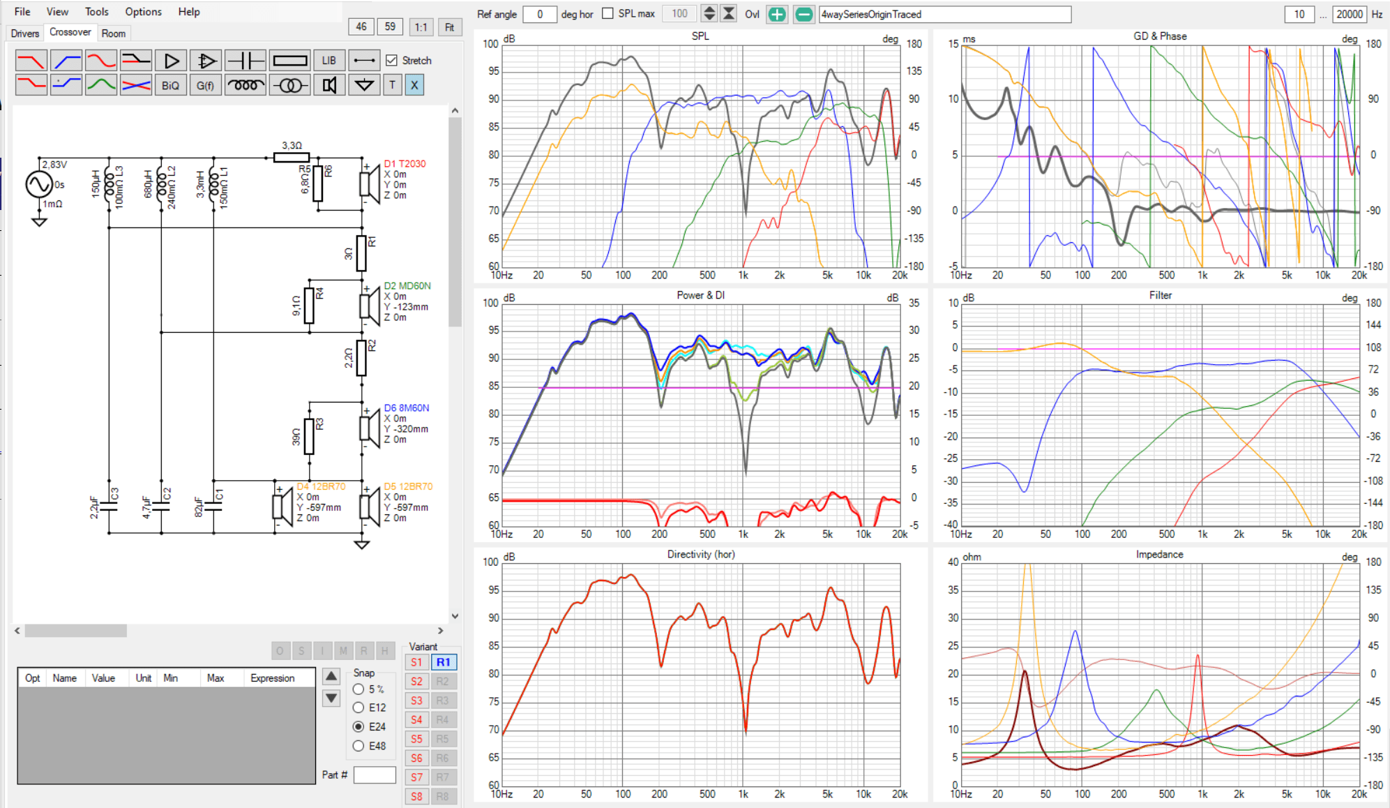

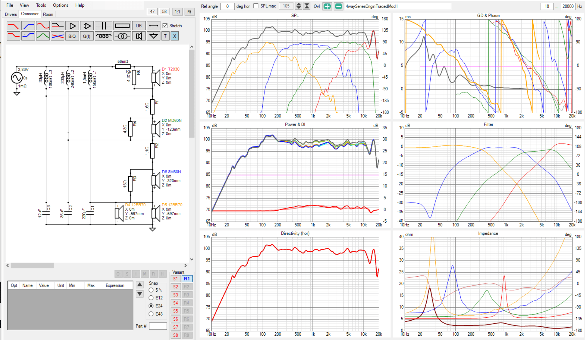

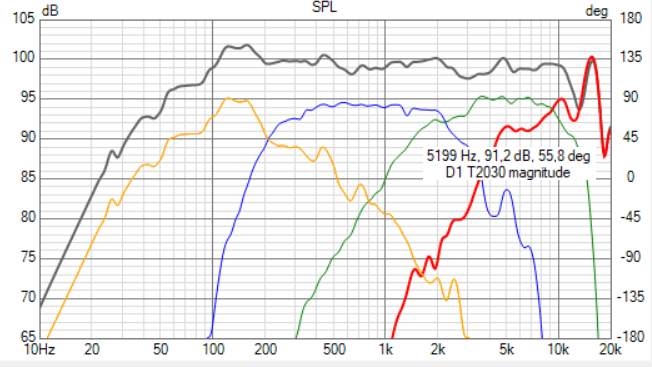

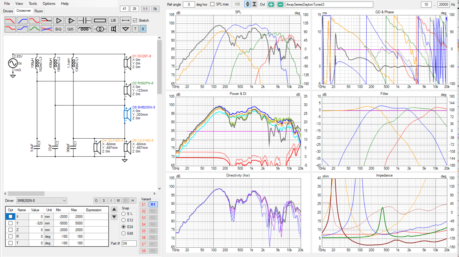

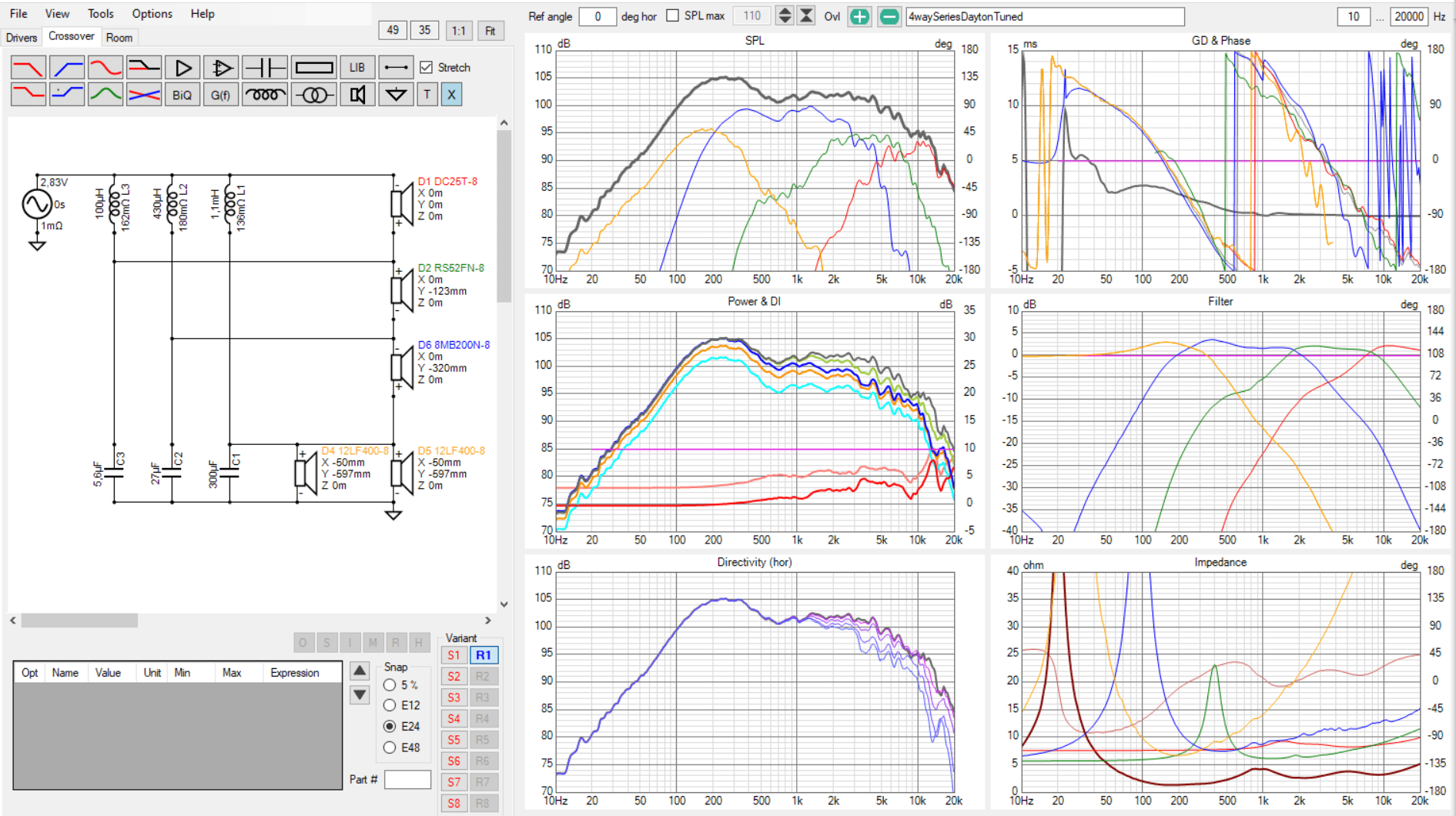

I wanted to learn a bit about series crossover so I traced the FR/ZR and calculated the curves in cabinet according to the volume indicated above. I played a bit with your project in VCad: All driver FR and ZR are simulated in cabinet with the diffraction tool. So here it is: FR has a -0.25 dB/oct. slope but impedance is very low, about 2 Ohm, so you should consider a passive biamp.
Let me know if you want the files of the project.
Microphone location is one parameter in simulation, it can be changed for simulation.... And if you move your measuring microphone by less than 10cm, all your simulations - with or without "exact" datas - are ruined.
I don't even speak about the influence of the room, which has nothing to do with the usual anechoic one meter test.
My simulation surely is not 100% correct as for datasheets measurements are done on test panels and polar plot data is not used in simulation.
Only thing I am sure and get this from simulation, is that polarity of LM and TW must be changed.
Other issue I am not so sure is that T2030 is not suitable if used in range higher than 8700 Hz, it have there bad SPL line.
I attached also Vituixcad simulation file with used data files as zip.

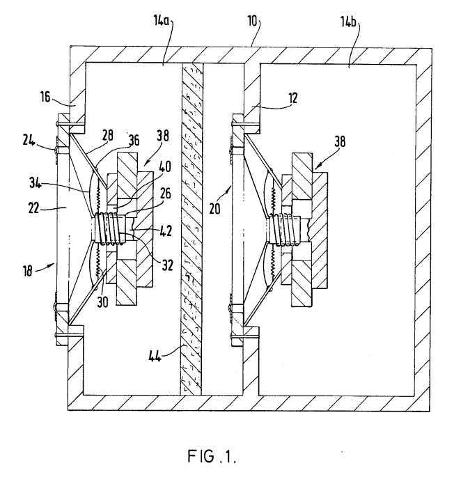

Here is Ivor Tiefenbruns ( Linn products ) isobarik patent :
https://patentimages.storage.googleapis.com/cb/2c/6a/a88bb919642efb/US4008374.pdf
The Linn keltik, famous for outstanding deep articulated bass.

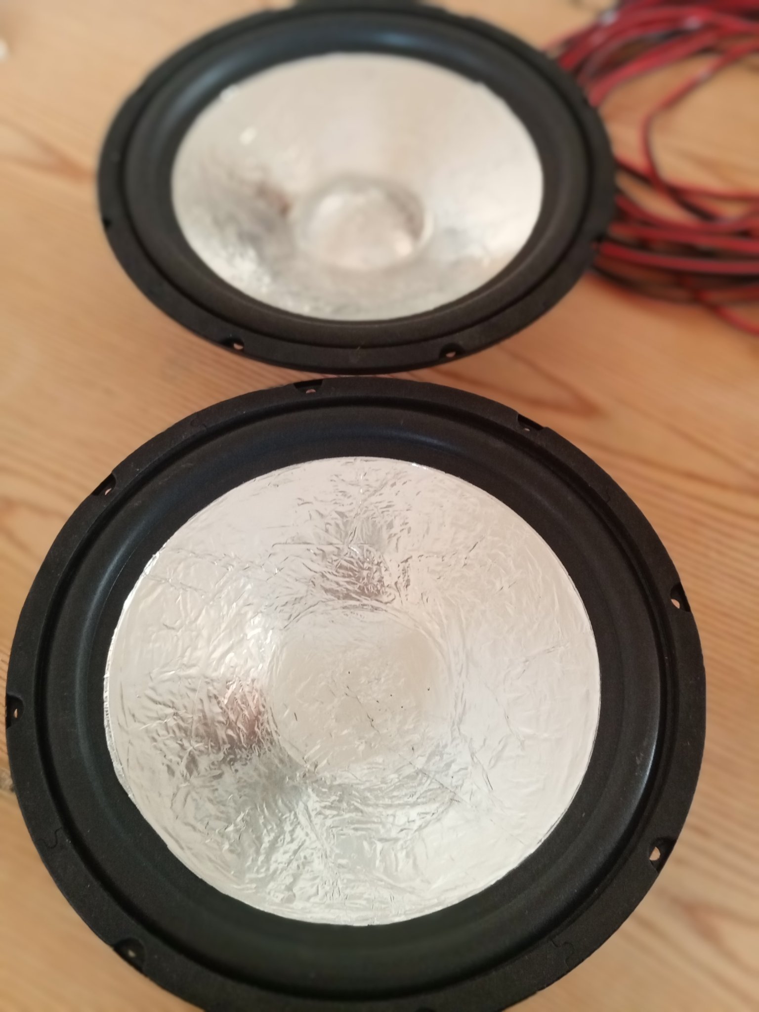

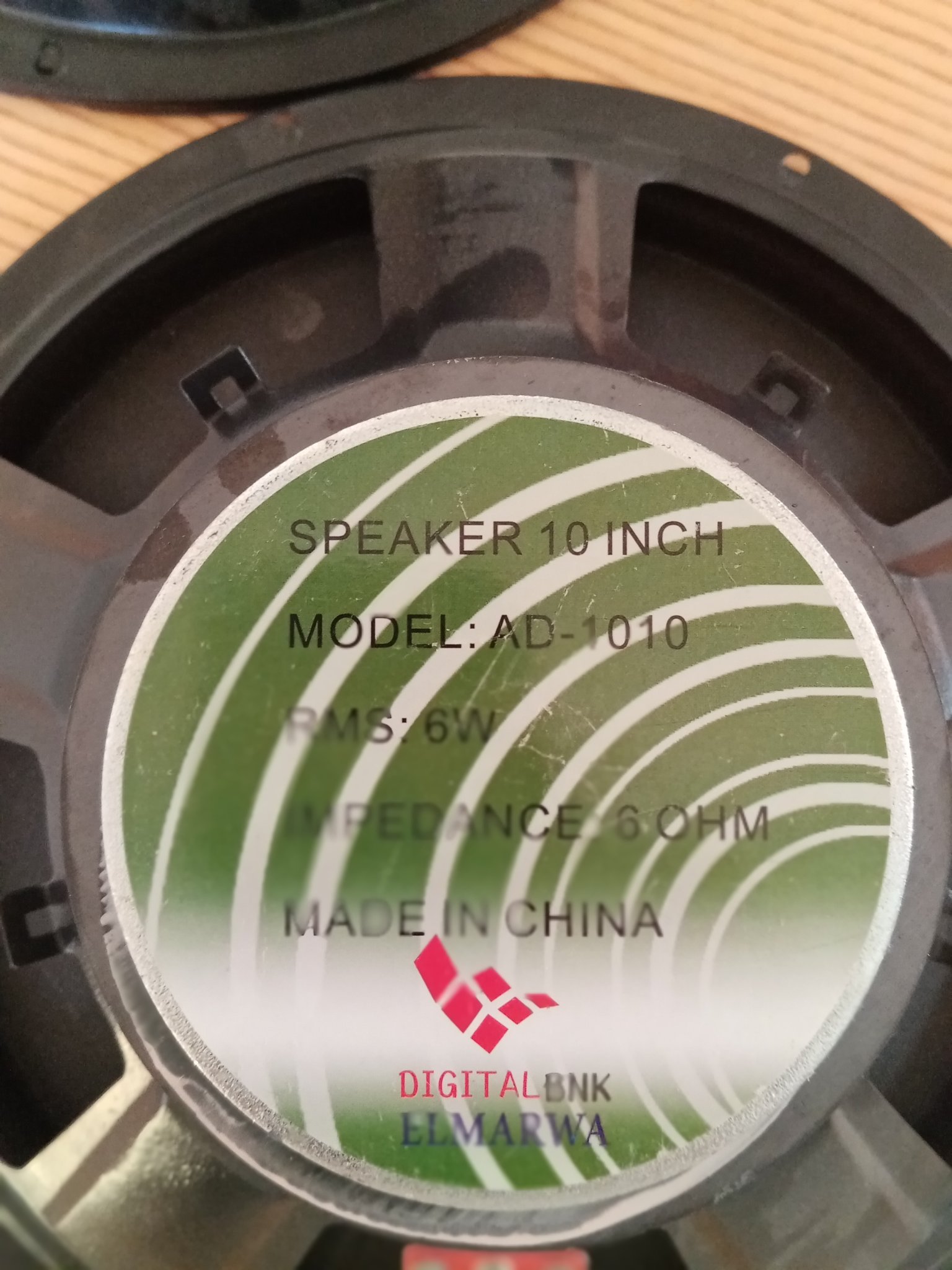

Maybe I will try Isobarik one time as I get only cheapo drivers in egypt.

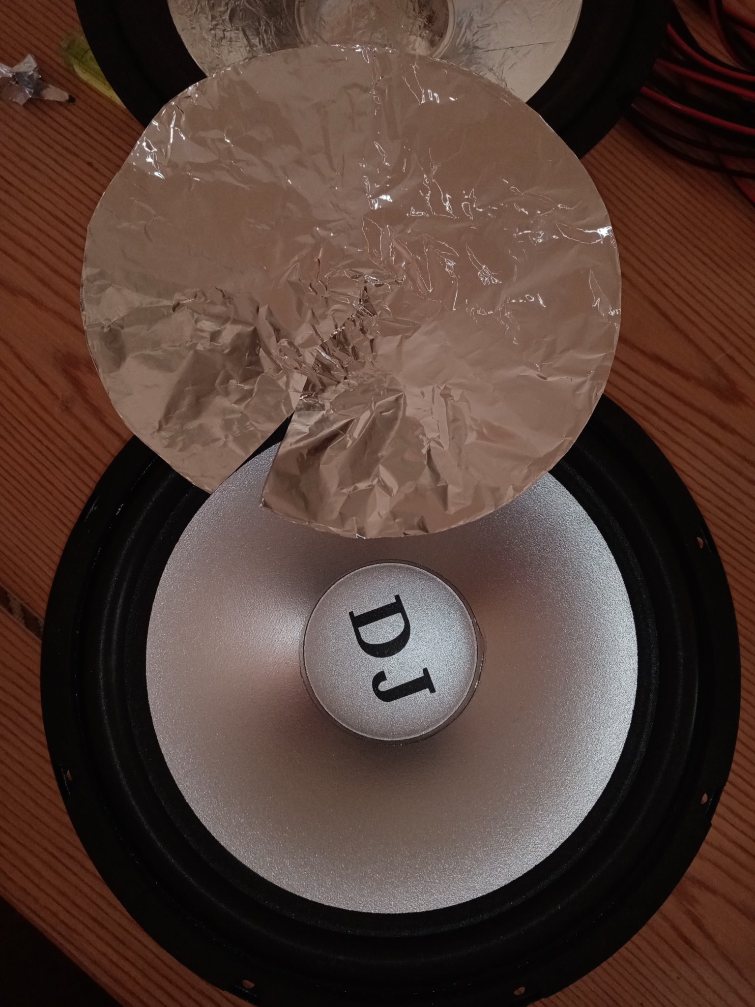

Now I make a subwoofer with two 25cm drivers, one turned
around (and turned phase), impulse compensated working together in reflex box of 170 liters. For home cinema corner placed.
for cone stability they got one sided aluminium foil

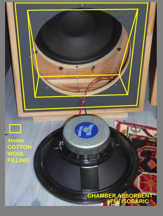

@Audientid14 : thanks for your insight and the link to the Isobarik patent... I searched for some in that field, but often found incomplete descriptions or samples.

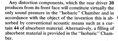

I read this :
The description above and the matching figures - from the patent - states that "an absorbent curtain and/or a filling is provided in the Isobaric chamber" to reduce "inter-speaker distortion", if I can say so.
Surprisingly, Vance Dickason recommends - in its well-known book The Loudspeaker's CookBook - that "no fill material sould be installed in the Isobaric chamber, if not felt sheets that could be fixed on the inside faces".

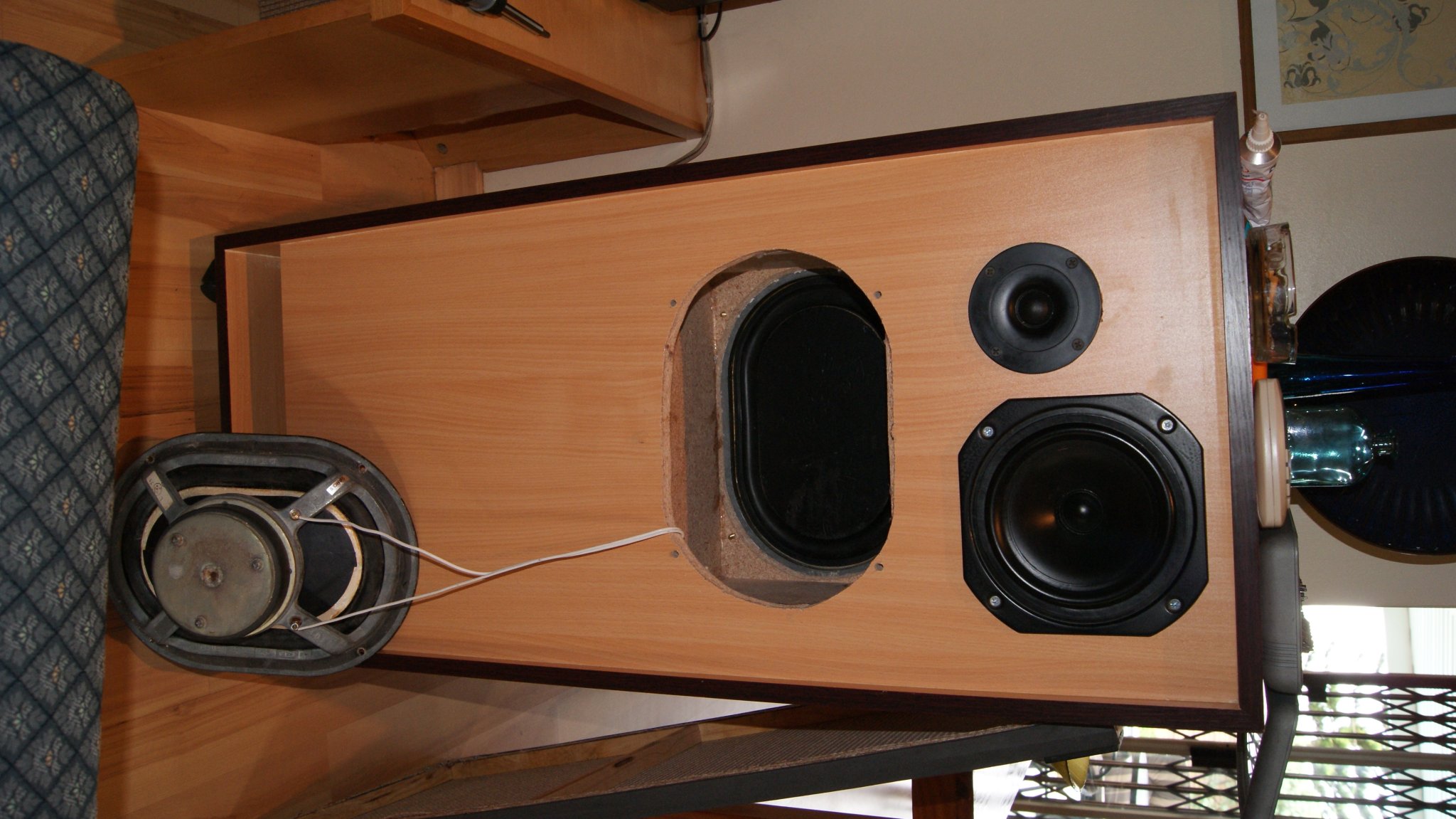

Here's what I did - empirically :
I covered the internal faces of the chamber with 40mm Cotton Wool, in order to prevent any internal resonances...
So what did you do about the chamber : absorbent ? No absorbent ? Which kind, if yes ?

I read this :
