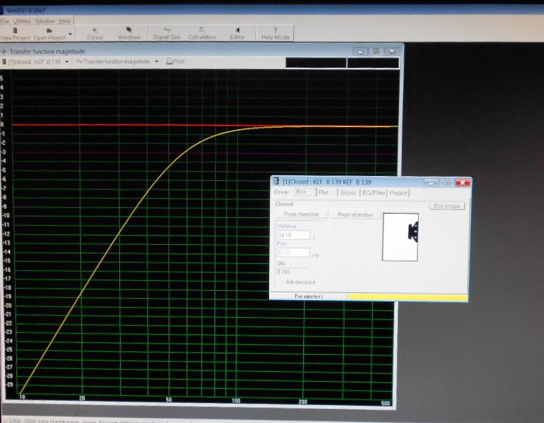

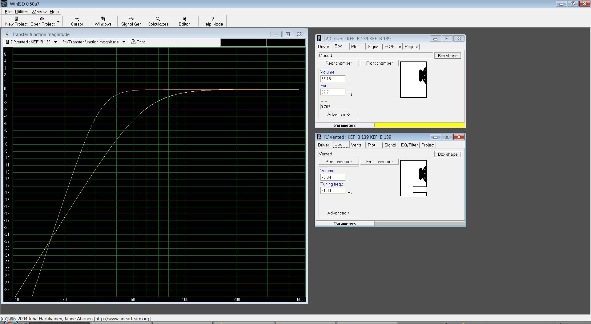

But does that account for room boost, and transient response? As I said, I have done it this way before, and like the sound.Well in that case here is exhibit A, it clearly shows the advantage of a ported box - vs. sealed.

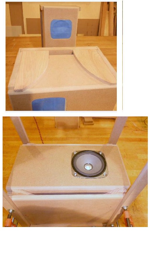

Here is a small scale example how to tune a box with semi built box and clamps.
These are flare ports to give this box a bit of low end; I guess I could have thought this with out calculator (hours), but instead trimmed the wood flares as needed to reach the 60HZ tuning.
The box does go down to 50hz which is very good for this FR driver.

You have it backwards... isobaric works better in a sealed box than a ported box. The "outer" driver of an air-coupled isobaric pair is always going to move further than the "inner" driver. The difference in excursion is proportional to the difference between the volume between the drivers and the volume of the box. With a ported box, the box gets very "stiff" (acts like a very small box) at port resonance.

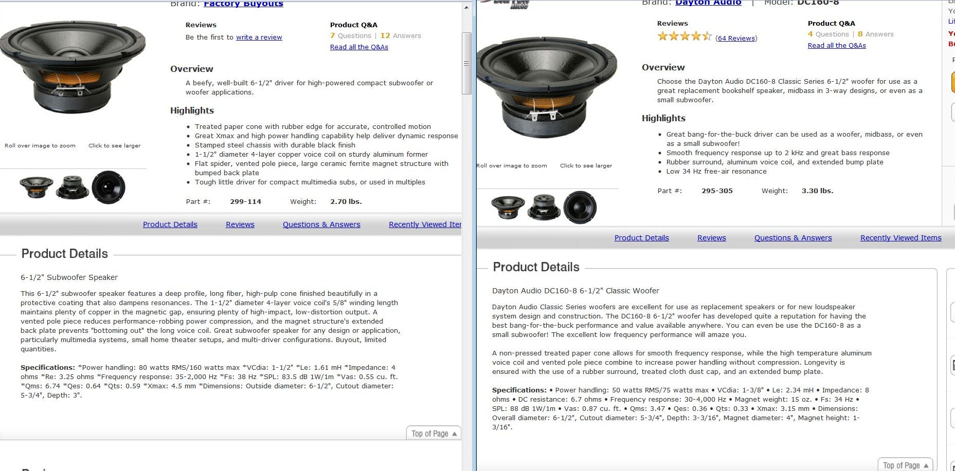

299-114 vs 29-305
Dan,
Thanks again for showing me the light (how to clip pics and edit).
Check this out...Could this be the 8ohm version of the 4 ohm 299-114 😕
Dayton classic 29-305 (too bad they cost $20 and not $8)
