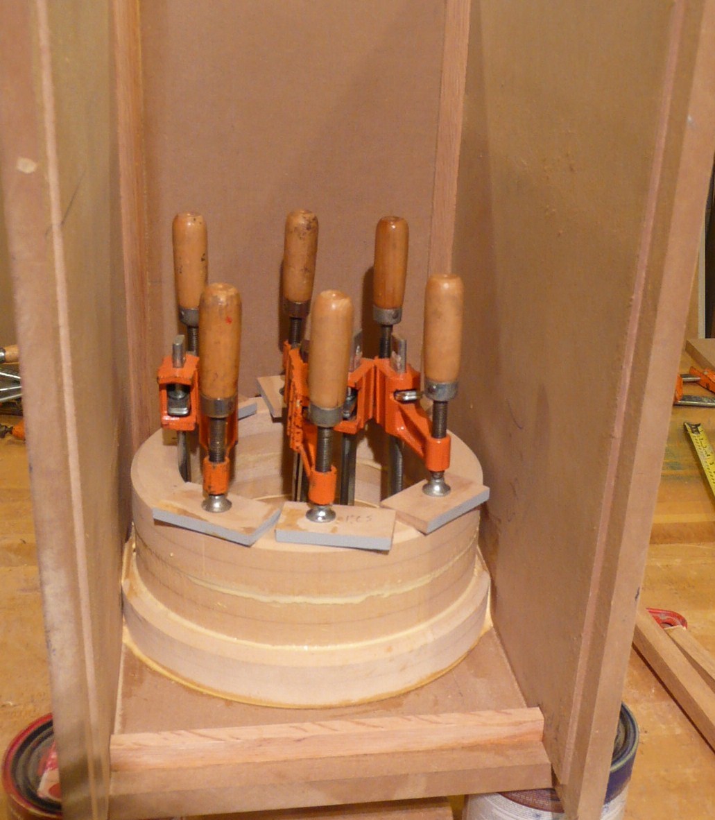

The B139s would be fitted to an inner box which would slide into the main box, and be multi-screwed to the outer box, perhaps with a felt sleeve between. This would mean I could change orientation or even the drivers.

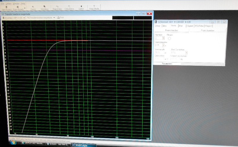

It looks good in WinISD. It has a huge VAS, I can see where you would want go Iso.
I'd be afraid of the flat cone though, you can run into problems with speakers facing each other one speaker is stronger (or something) and pushes (pegs) the opposing driver into basket.
btw this was a 35L box with 31hz tuning - I'd use a slot port, easy to tune.

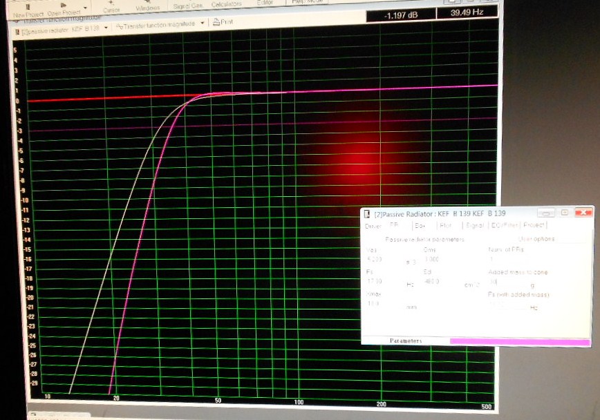

Maybe this is what you are looking for.
Same 38L box with a 12" Pr. I only spent a few minutes on this but looks good. (red line)
12" Pr with 30 grams.
Dayton Audio SD315-PR 12" Passive Radiator 295-496

I have the drivers for the 'barics, and cut the ply (2 years ago!!!), so I just want avoid mistakes before I start.
