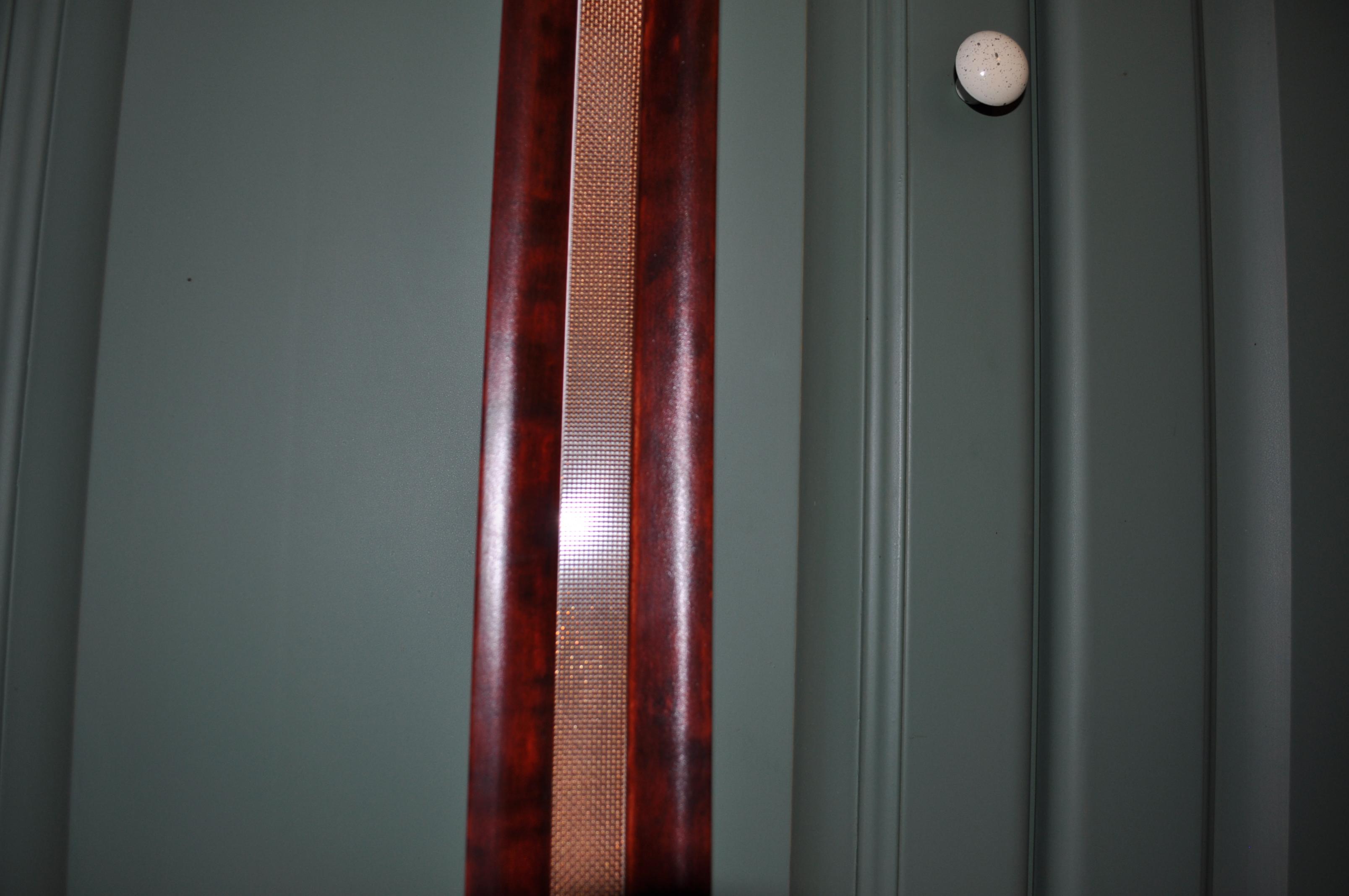

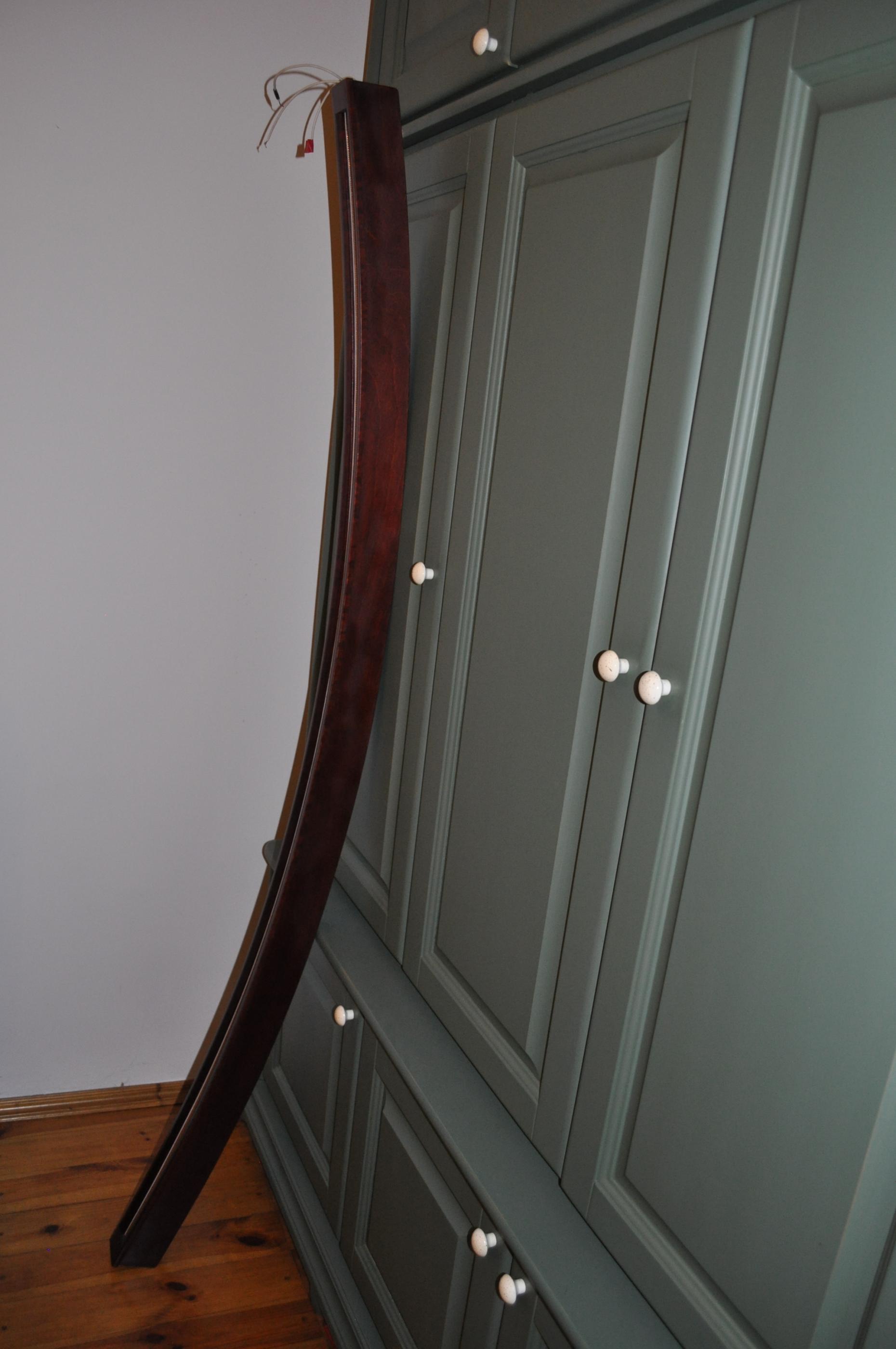

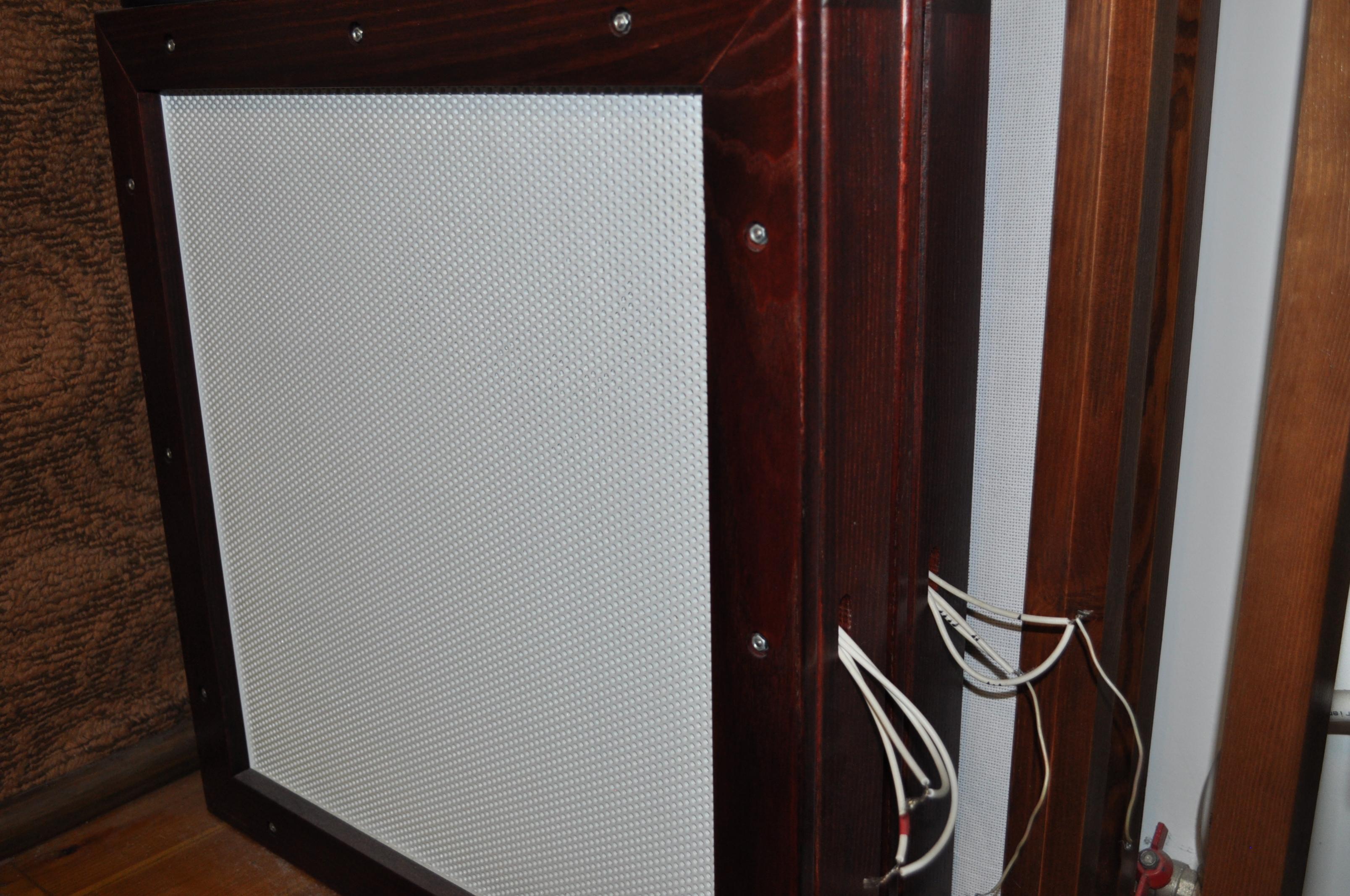

That's right, this is an old video from 2015, with only one subwoofer and two narrow (20mm) but high (190cm) and vertically curved satellites in the middle and high frequencies.
But this summer I made parts for another subwoofer, or rather made the membranes themselves, because they needed a lot.
The size of the subwoofer is 59/50cm.
The diaphragm-stator gap is 3mm.
The sound of electrostatic subwoofer like this is not confused with any cone speaker cone with magnet and coil.
The project is not over yet, but before the summer is going to finish completely))).

Hi friends, I made isobaric bass panels consisting of 6 membranes and 8 stators made up of a package,they work very efficiently and dynamically. Diy ESL. - YouTube

So are those panels separate assemblies stacked in front of each other in series? Is there 6 membranes and 8 stators in each one?

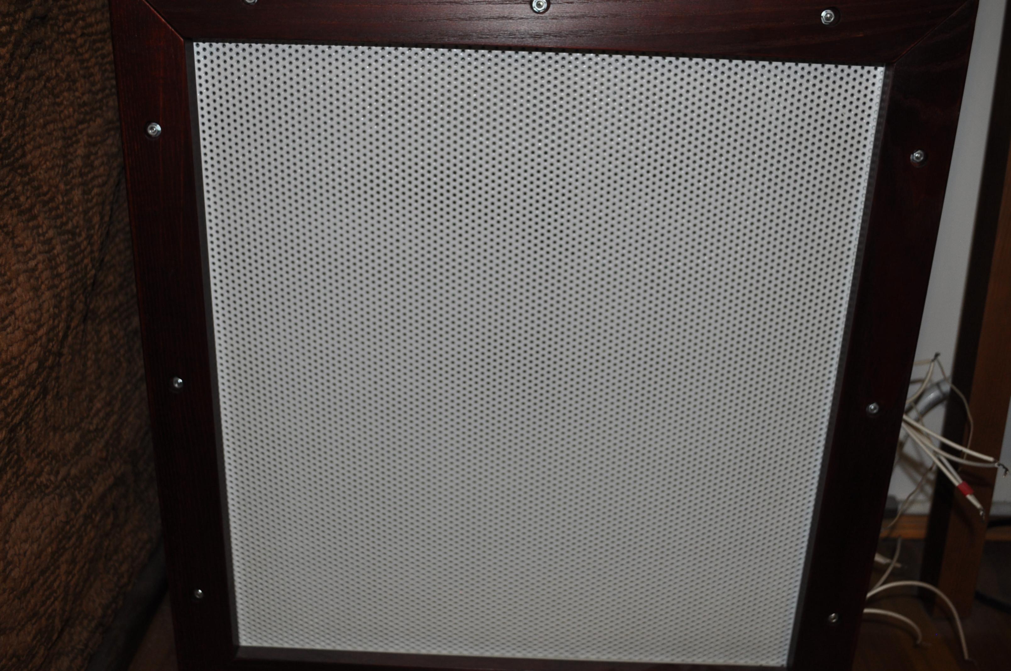

But keep in mind that the stators should be of thick, perforated iron with an acoustic transparency of about 40%, the stators should not add their individual singing.

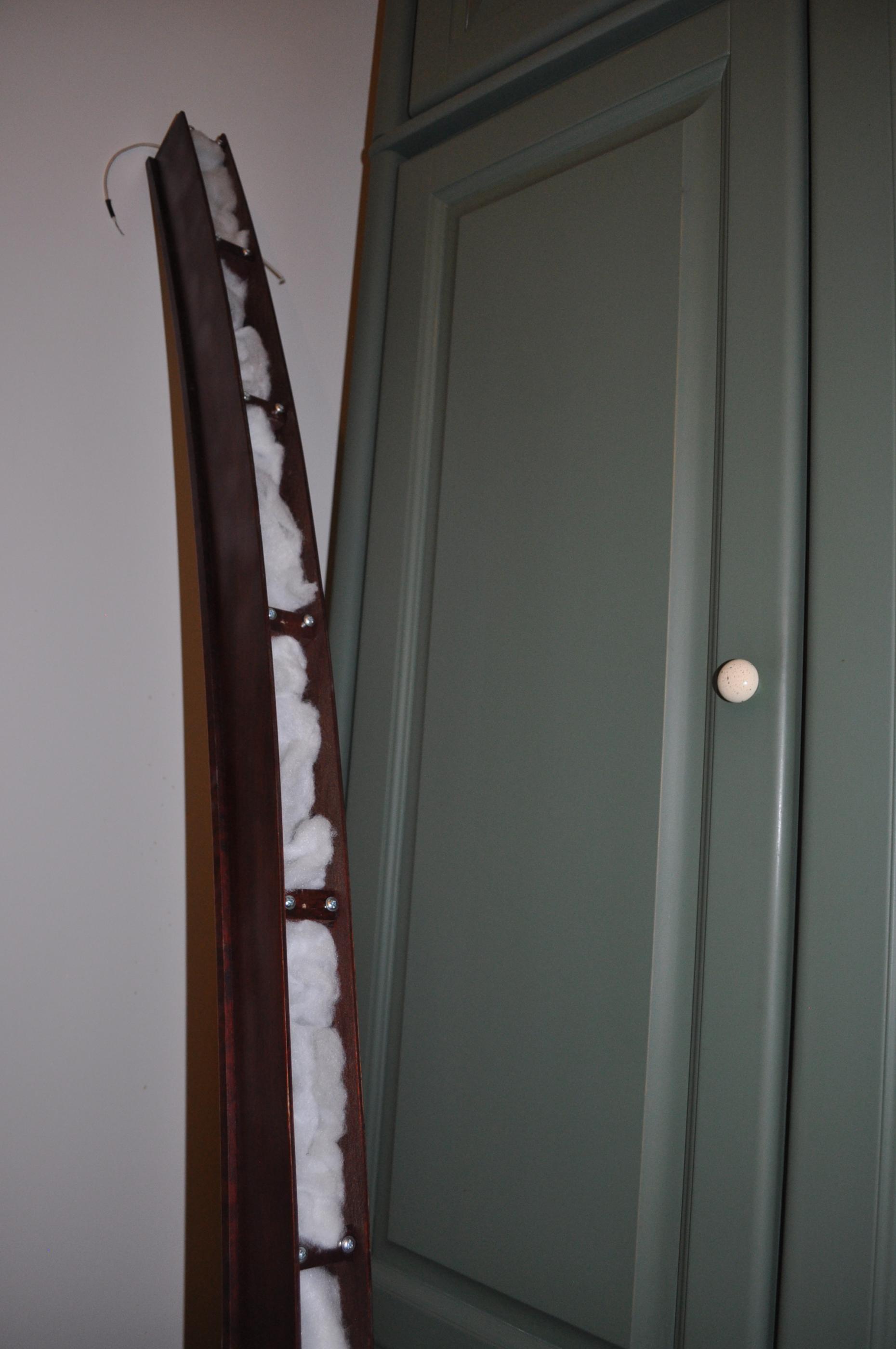

Yes, they are made a package to each other, but not all, and three membranes in each wooden case, and then these cases are connected. This is because at first I decided that for one channel three membranes connected by isobaric, but when there were two identical isobaric in front of me, I was tempted and combined them into one))), the effect was strong enough and I decided to make another such version for another stereo channel.

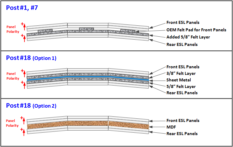

For my little experiment I will next add a solid sheet metal barrier between 2 layers of felt and seal each side of 3 panels against the frame. So there will be no interaction from front assembly with rear assembly and the felt filled cavity between them will act as a minimal 'box' so output will be restricted out the front of each side.
I do not yet have a mic so have not done any tests on REW. Have you?

Are they sealed as one unit around the edges inside the frame? So actual isobaric configuration? Are they damped?
Yes, they are completely sealed.

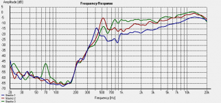

Some advice from past experience with many lower mass planer magnetic protos ( mass on par with many stats not the typical higher mass planers).
1- you may get a similar result, (good damping of the diaphragm) with a single diaphragm arraignment with just a layer of much thinner felt or other restrictive medium on rear stator
These light diaphragms have resonance issues and a bit of restrictive material over most of the center area or more goes a long way to taming them. too much restriction however and the bass will be EQ down too much. Better than felt is simply a screen or thin cloth with the right resistance found by experiment and solidly attached to stator. Better if its not allowed to move.
2- I suspect the dual diaphragm arraignment helps most below about 150 hz by adding enough mass to "beef up" the response in that area. Very light diaphragms are damped by the mass of air around them in this region and adding another diaphragm is similar to doubling diaphragm mass at low freq without the colorations in the mids that thicker heavier diaphragm may have
so to sum up, my guess is that the mid and up perf. increase you hear is largely the damping from the felt AND a single diaphragm with thin restrictive material done just right will probably give similar result. In the bass region however the dual diaphragm may be responsible for a bit heftier perceived bass. All together the felt and dual diaphragm resulting in better dynamics and FR and a quiet background

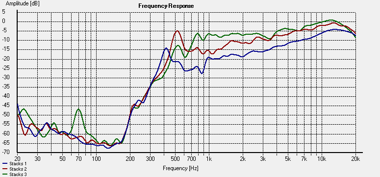

I will do some tests with REW when I receive the umik-1 I ordered. But my non expert but well trained ears over 40 years tell me firstly that it's by far mostly damping. The amps are all in great shape and output does seem to be significantly greater so not sure how completely isolating both sets of panels with a solid barrier sandwiched in the felt will affect that. However the solid back will render the cavity like a sealed cabinet; I will seal the panels around their perimeter. So that will cause a back wave to project out the front increasing output. But, that may take all the magic away as now there's no more mechanical eq. from the other side. It's hard to say how much the other set may or may not be reinforcing response. It'll be interesting

All correct except you've reversed option #1 and #2 in post 18. I have the 20awg sheet steel cut and ready but I'm going to wait for the Umik-1 I ordered so I can take measurements with and without. I don't think the MDF option is beneficial just logically? The sandwiched barrier will tell the tale, I think. I think I will lose the added output with the sandwiched barrier because technically, they are in fact isobaric at present. So I anticipate a loss of the FR and dynamic range enhancements also.
