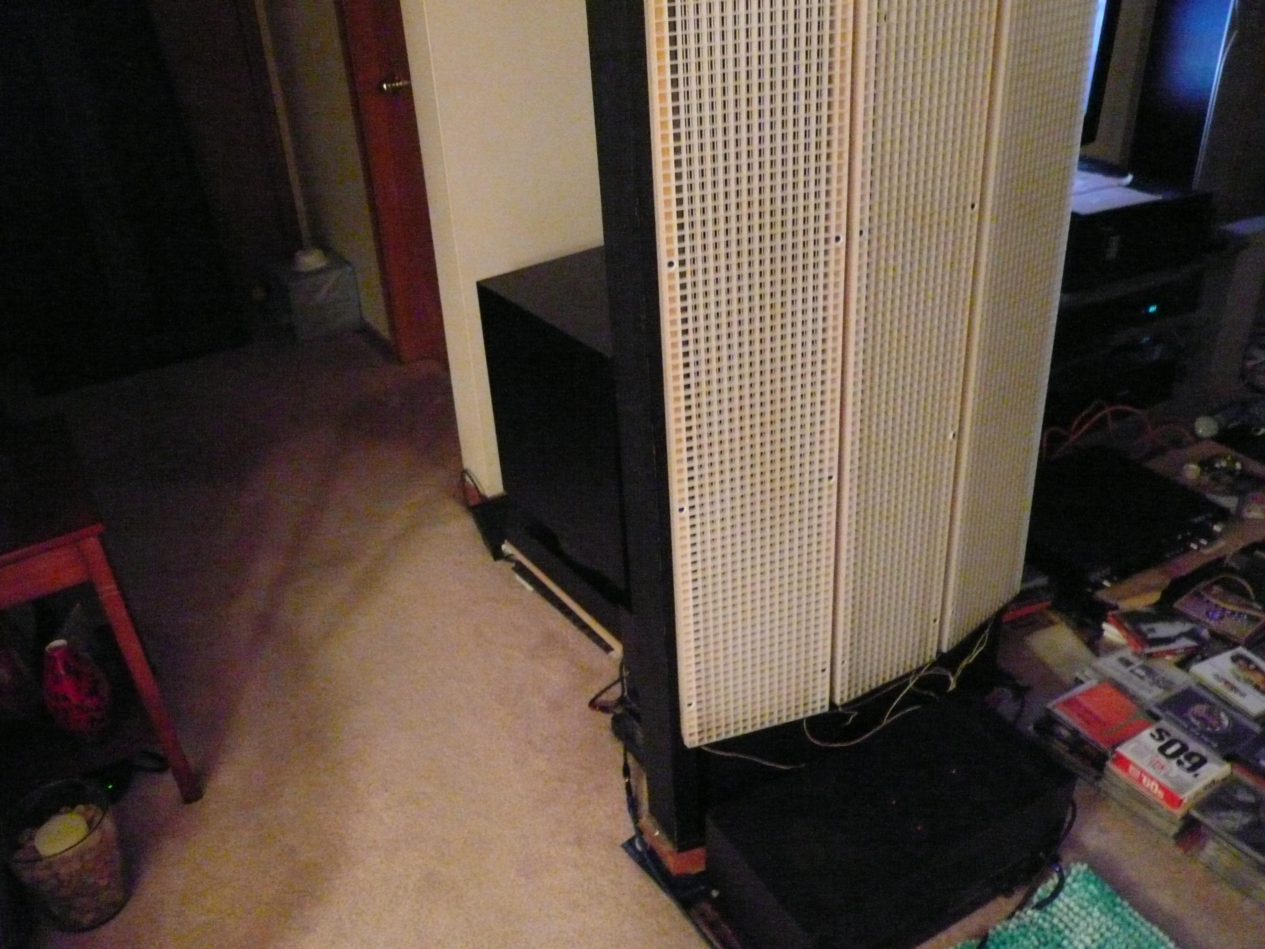

So just want to share my Eureka moment. Not much of a response on a thread I started about isobaric ESLs. I did not try it because of advisory info on another thread. But this is a bit different. I have a pair of Acoustat Monitor 3 with DD OTL monos. The panels are mounted on the back of the frame structure so there is a 1" set back/recess. I ordered 5/8" thick felt, same medium density as the strips on the backs already to tame resonance. So I cut and covered the entire front side of the panels with felt, filling the recess of each panel/frame recess. I then mounted a second set of panels on the front of the frame, sandwiching the felt. I did not remove the original felt strips on the backs of the second set. Guess what happened when I tapped on the front panels...Nothing! Dead, no resonance to speak of. How silly, right? But here's the trick.. I also hooked up a second set of DD OTLs!! So now there is full damping without loss of output. It's hard to describe just how much better they sound. There's no comparison. The rolled off top end character is gone, mid range is spectacular, that upper bass tubbiness is gone. Sound stage is far more enveloping/depth is just awesome. The sound is so close and intimate it's as if you're right up next to them. This is how they should have been designed in the first place. This tweak is anything but boring.

Photographs would help our understanding of what you have done. 😊
Is additional felt the same shape as the original pads, or full coverage?
Are additional panels on all, or just outer 2 panels?
If the monitor 3 are similar to model 3, then the central panels are 8",rather than 9" and outer panels are angled back 10ish degrees from the plane of the central panels.
The description sounds easy, but the detail sounds complicated, if all 3 panels are not in the same plane.

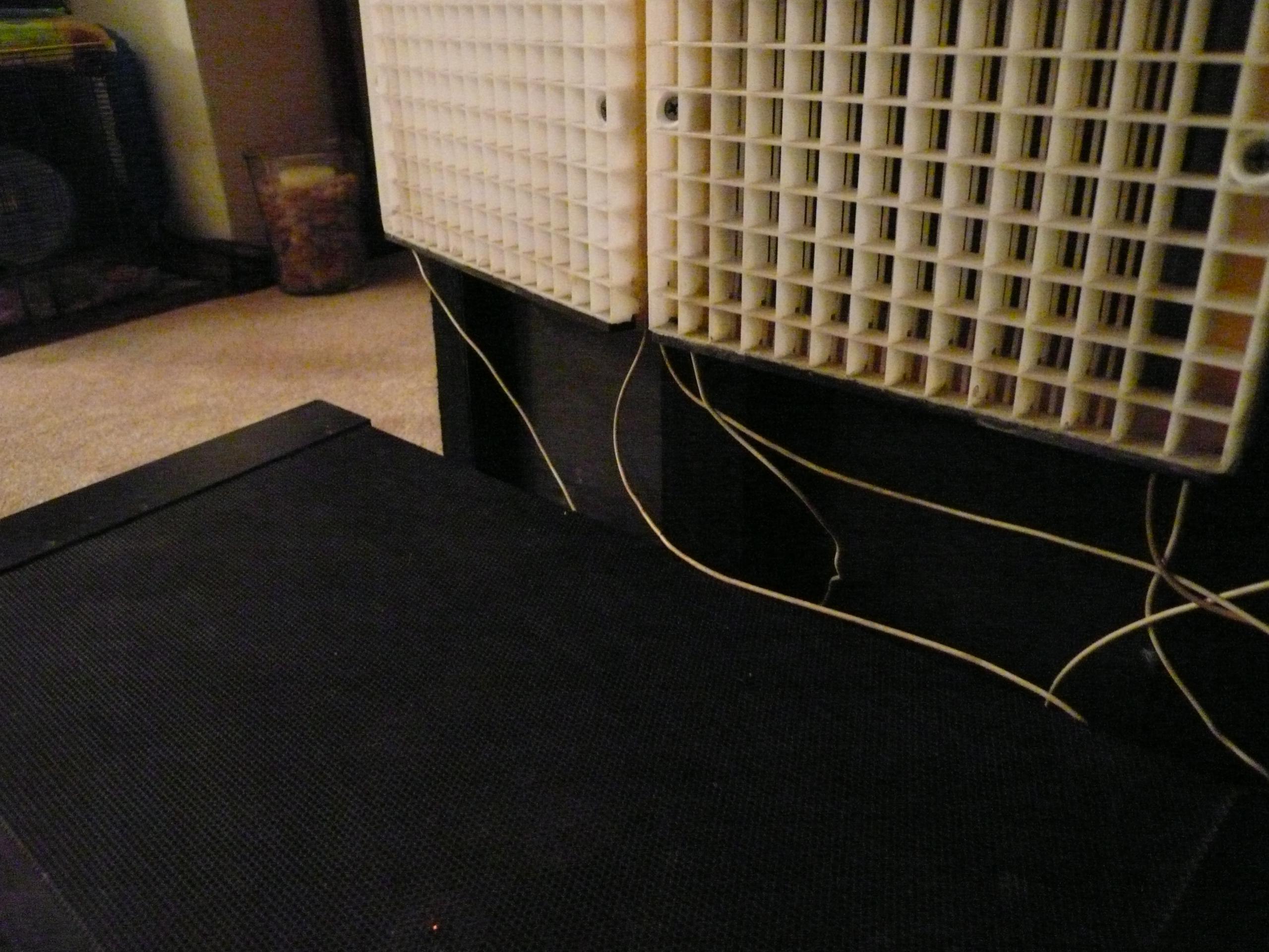

So you can see on the 4th pic the recess behind the panel. The frame is 1 inch thick. The originals are mounted on the backside while the second set on top. The felt is cut to fit each cavity between the panels. I removed the original felt strips off the backs, not needed.

Okay I think I have it now.
The 1" depth is filled over the full area of the panel and the felt on the back, of the front panels compresses slightly into the new felt, over the area of the existing felt of the front panels. 10/8ths becomes 1" and in the perimeter out site the original felt pads, does not touch both panels.

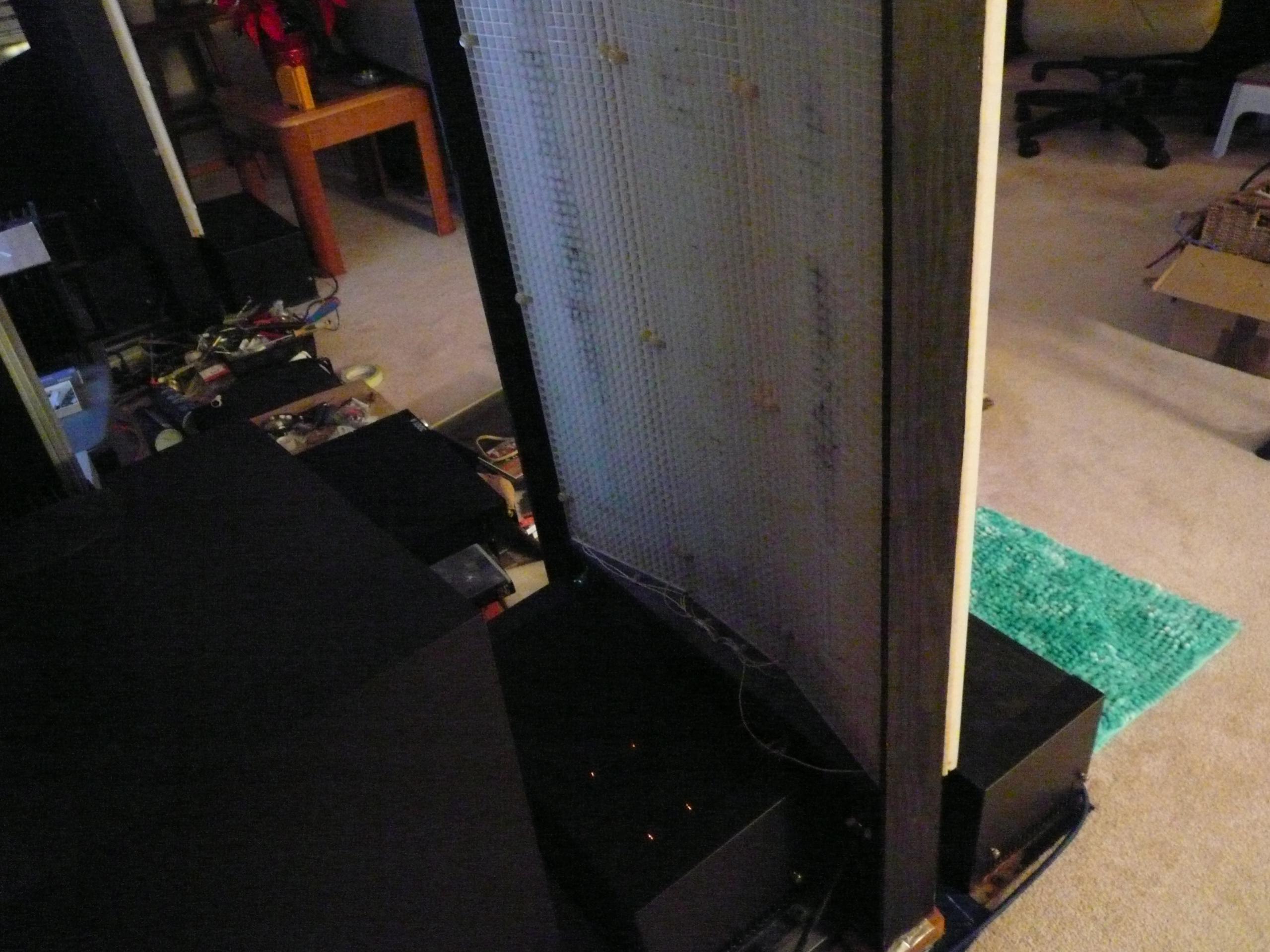

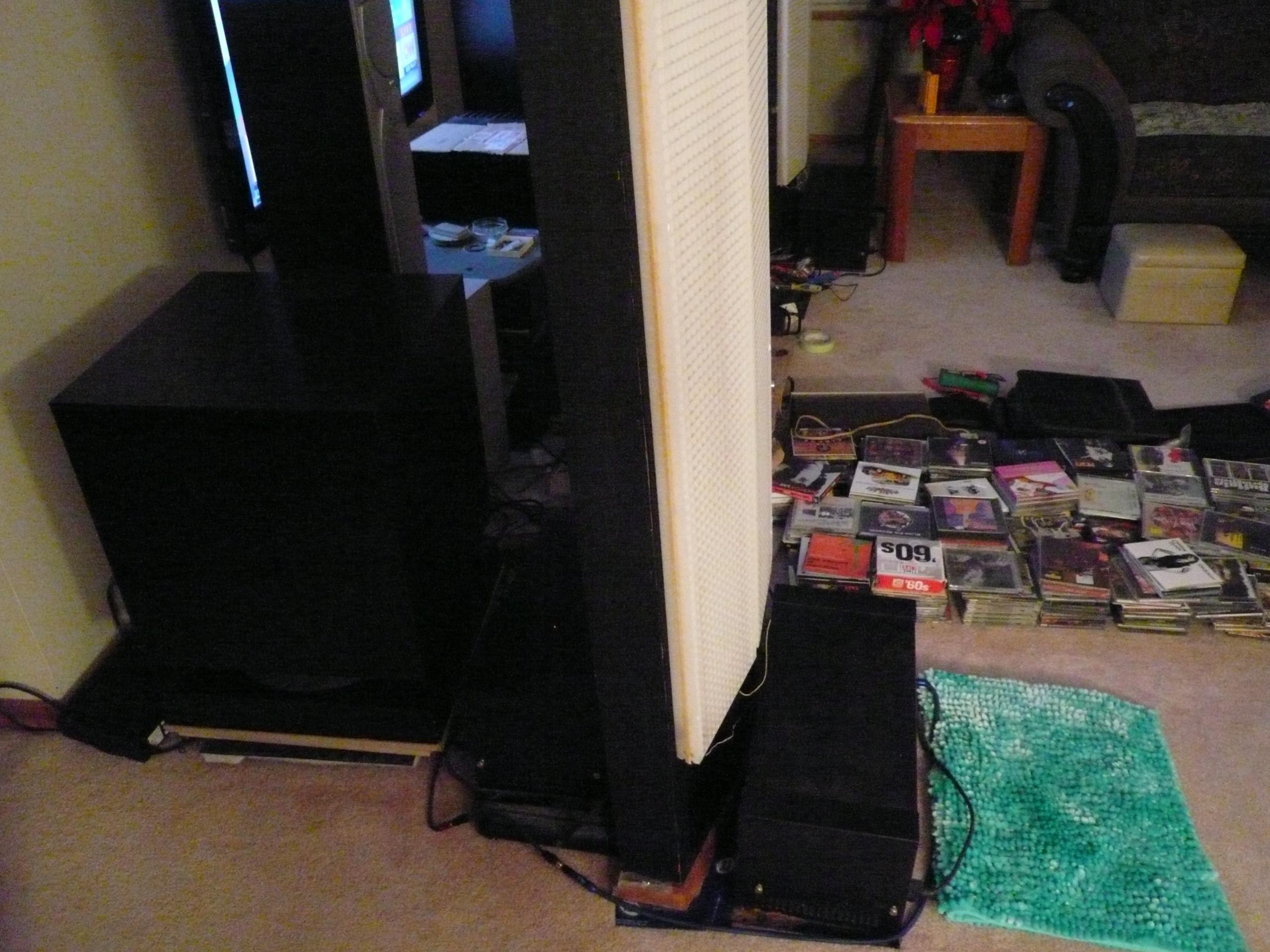

No, there's a 1" thick frame with panels on either side of it. The cavity between them has 5/8" thick felt over the entire surface area. I left the existing original felt strips on the outer second set which you cannot see because it's on the back of those, also in the cavity against the full felt I put in there.
I have a pair of Linn 5150s to...augment...the bass:)
I also ordered 1/2" thick felt I can add to completely fill the cavity under a little pressure to carry it further, later on after this.
This makes it very apparent how much resonance affects the performance of these speakers. It's huge.

I just have to add, I'm absolutely blown away by this. Floored! The more I listen, it's just WOW!

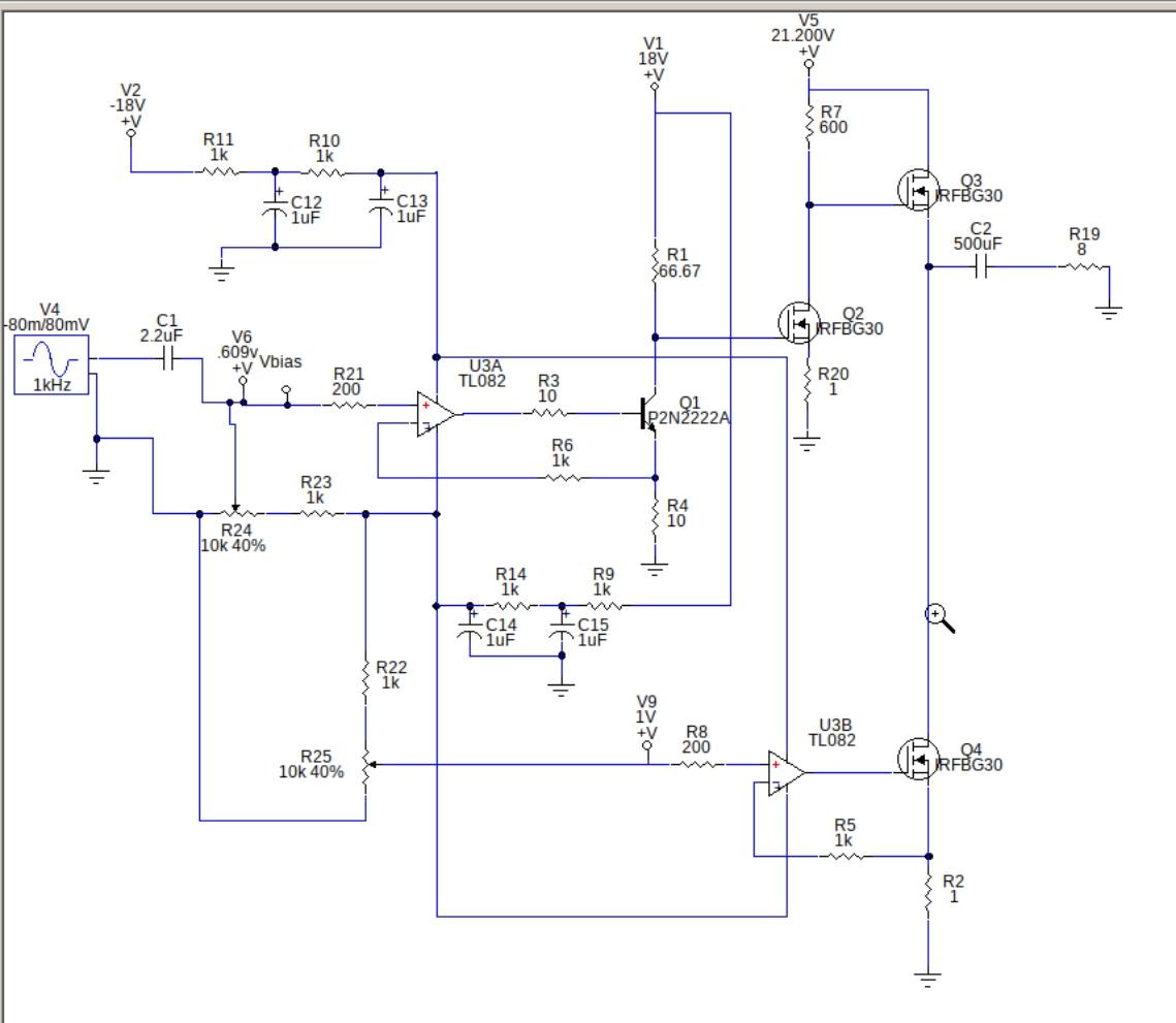

I have modified this circuit to use a BJT to drive the FET VAS stage as I had found in testing that the opamp itself does not create enough current to properly drive the FET at higher frequency's very well.
So I am using this configuration now ( as pictured below).
I have been using this schematic as built and tested to make my adjustments, as I had mentioned it is only at < 50V output supply.
Right now it is at 22V actually, but it works fantastic and I am blown away how great it sound despite the numbers !!! :)
THD is quite low as it is without any kind of feedback yet, and has a voltage gain of 47 as it sits.
NFB has not even been implemented yet and THD is about .05% to .12% and I had a worst case of .35% as measured and is ruler flat up to 200Khz to 300Khz range.
So, The Concept works !!!
But I have a ways to go before I can present a full working ESL driver to the DIY community. ;)
I have been using this amp to power my Sony 5 /14" drivers that I have been using in developing the Desktop ESL System in past years.
Despite it being based off of using opamp's this amplifier design operates Fully in a Class A mode only, and, Bias Voltage operating point, Output Voltage and Output Stage Bias Current are all fully adjustable and operate separately from one another!!
Cheers and Enjoy !!! ;)
