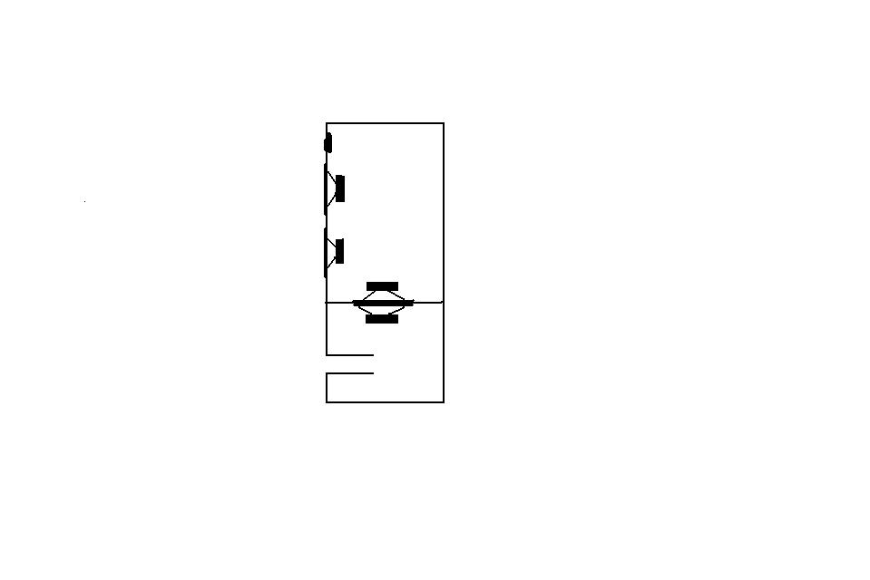

Forgive my ignorance, Tinitus, but am I misunderstanding your musings? An isobaric mid-bass driver? I suppose if one wanted to halve the size of an inner chamber, that would work well enough. But in my ignorance, I see no other reason. Can you?
Thats what its all about, whether there would be any sane reason fore making a 2way isobaric
Sreten points out that my suggestion still misses a second driver fore BSC...so its getting even bigger
Im in serious doubt, but there may be some advantage of the inner compound driver
It may be possible to get better phase between the port and the front driver...I am not sure though
With double front drivers it may be possible to use a bigger compound driver but that could mean trouble...or it could be double clamshell mounted drivers
The inner acoustic connection of the driver may also give some advantage, but a bit uncertain
Well, its beginning to look more like a 3way, or 2.5way with built in sub(no active xo needed😀 )...whether if its worth the effort is hard to tell, but it may not be easy to find the right drivers fore the job

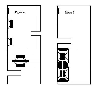

See figure B for what I'm planning on doing. The group delay is still off the scale though.
I'm also thinking on acoustically decoupling the iso chamber from the baffle itself. Actually having it mounted on the bottom, and perhaps the sides of the box as well, instead of directly on the baffle. Only lightly compressed foam would make contact between the iso chamber and the baffle. Then perhaps add some sand. That should reduce some resoance.

lacrossebowe8 said:while I am not fixated on building an isobaric design, I would like to try it. I really just want to build a large, standmounted speaker with enough bass to need no sub.
Also, how much harder is a 3 way crossover construction than a two way if I decide to do an isobaric design with a midrange and tweeter?
Isobaric or not, I just want to make one point. If your bookshelf will be seating on the stand, you have roughly the same footprint and you aren’t gaining anything in terms of space saving. You may as well increase the volume of the box and build a floor-standing 2-way loudspeaker. Something similar in proportion to ProAc 2.5 or such. 2.5 btw produce plenty of low end. If you decide to build an isobaric 2-way design, depth will probably have to be increased. Isobaric design greatly reduces linear distortions of the driver. I would be very curious to se the results, because I am designing a 3 way with 2 separate ported enclosures for the woofers in isobaric configuration.
If you are concern with lower frequencies, I think ported box would serve you better.
