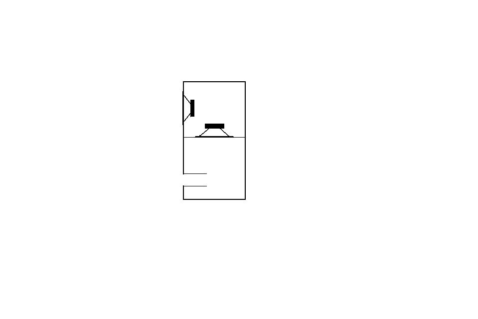

what recommendations would anyone have for plans on building a more or less full range 2 way (either MTM or standard TM) that is full range is used on a stand mount? I probably would think about taking a plan for an MT design and adapting it for 2 woofers by doubling the cabinet volume. What crossover changes would that entail? Also what design software and books do you guys recommend as I am new to this?
A 2.5way(double midwoofers) would be more efficient
Wonder if anyone has tried to mount a passive slave behind a midwoofer, like in isobaric/compound 😀
Or the isobaric might be interesting with 2.5way xo, with a bigger champer between the two midwoofers, so that the inner woofers acts like in a compound
Not quite a classic 2.5way c/o because the external unit still needs BSC.
But the principle is sound, take an MT and add a 0.5 way unit.
🙂/sreten.
