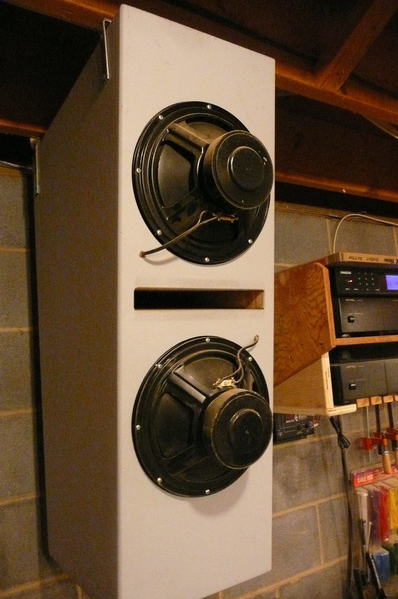

Incase you missed an earlier thread; I do have a little trick for a slot port:
semi build the box, to the point where the front baffle board and “slot” (glued together like an “L”) can be slid up and down, which changes the port’s volume - using a generator and volt meter you can tune the box with certainly and then do the final glue up (you’ll need a good number of clamps).
To answer your question about this box, I started with 1 8” woofer in a 2cf cabinet and tuned it to 30hz; great low, house shaking bass, however it did have some problems with bottoming out with high volume during action scenes (explosions, etc).
I decided to but two speakers in one box, to help handle the power. The design - I simply cut the volume in half and added of volume for the tunnel and extra speaker.

It was a bit of a story, a friend gave me 4 cabinets with the woofers. I had 4 chances to get something to work, so by trying 4 different combinations, tuning, seat-of-the-pants stuff, I came up with this. I did end up burning up and throwing away the other 3 boxes (I was on a roll).

Yes, that is the process, 2 speakers ~ face to face (clamshell) – Mag to Mag – front to back, you can make the cabinet half the size. Don’t forget to add some extra volume for the 2nd speaker and/or internal “tunnel”.

Sound engineer, ohh….but I knew that before I looked at your profile. I do understand your question, to a point.
The sliding baffle idea; AKA Odoubo’s no calculator method.
[This probably won’t make any sense to people that never tuned a bass reflex speaker]
As mentioned I had the frequency generator and volt meter hooked up early on, I tried different versions (port lengths) and my measure was the amount of port air noise (keeping the high and low voltage peaks the same for each version).
I made adjustments to the length of the port (on the table saw, speakers and all) and also the height, before the final glue up.
With the experimentation, I set the port at the edge of the “wind noise” being noticeable, at same time setting the voltage swings where they looked good.
To expand on construction, the front/port, top, back, bottom need to cut at the same time; 10” wide for this project. You’ll want them all to be exactly the same for an air tight fit. The 17” x 19” sides can be cut oversized and trimmed with a router or belt sander. WATCH THE PORT, easy to forget and gouge it with a flush cut router.
